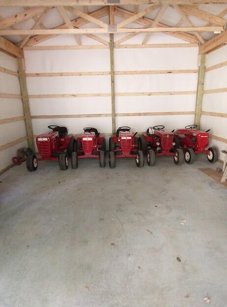

rmaynard 17,496 #117 Posted June 22, 2020 It's been awhile since I last posted in this thread. I've been busy remodeling my basement during Coronavirus "stay-at-home", but on Father's Day I decided enough is enough. The horses need to move to their new home. 10 3 Share this post Link to post Share on other sites
ebinmaine 80,124 #118 Posted June 22, 2020 Looking good Bob. Tons of space in there. What are the next 14 horses you're going to buy? 1 Share this post Link to post Share on other sites
rmaynard 17,496 #119 Posted June 22, 2020 7 hours ago, ebinmaine said: What are the next 14 horses you're going to buy? Well, I was hoping to come home from the big show with a 416-H or 520-H that I can keep equipped with my 42" mower, while my current one stays equipped with the 48" blade. But not this time. Update: Renting a trencher this weekend to run electric. Wish me luck with that. Going to have to go through one of my wife's flower beds. I promised her that no harm would come to any of her treasured hydrangeas. But since I've never used a trencher, I might just be sleeping in the new pole shed this weekend. 4 Share this post Link to post Share on other sites

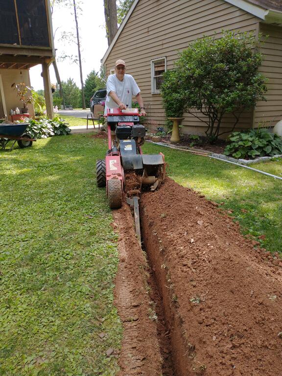

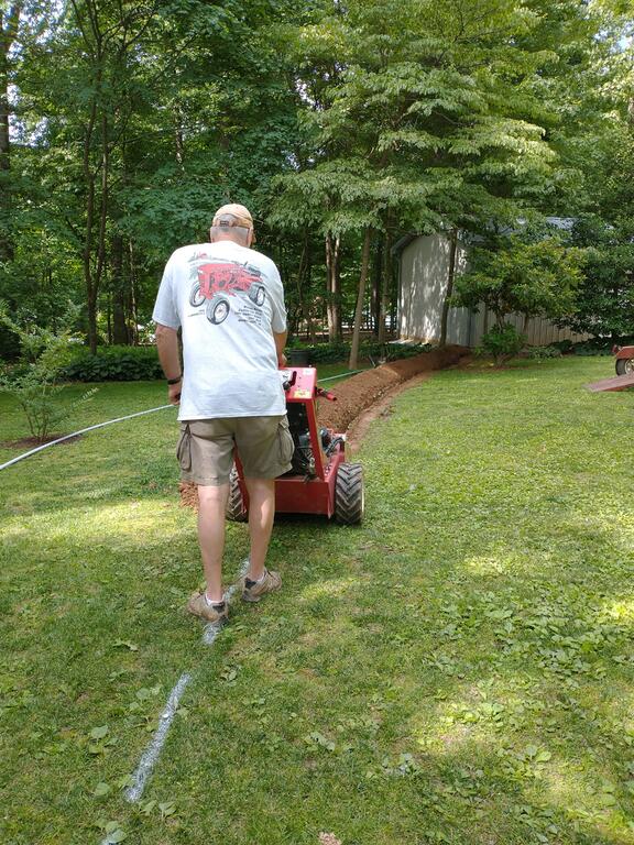

rmaynard 17,496 #122 Posted June 26, 2020 Rented the trencher this afternoon and have made significant progress. 1 3 Share this post Link to post Share on other sites

tunahead72 2,640 #124 Posted June 27, 2020 So, have any treasured hydrangeas been harmed in the making of this trench yet? 1 2 Share this post Link to post Share on other sites
Stormin 9,988 #125 Posted June 27, 2020 Makes a nice neat job. Beats a spade any day. 2 Share this post Link to post Share on other sites
