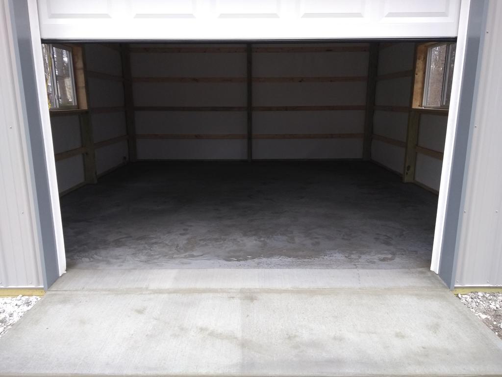

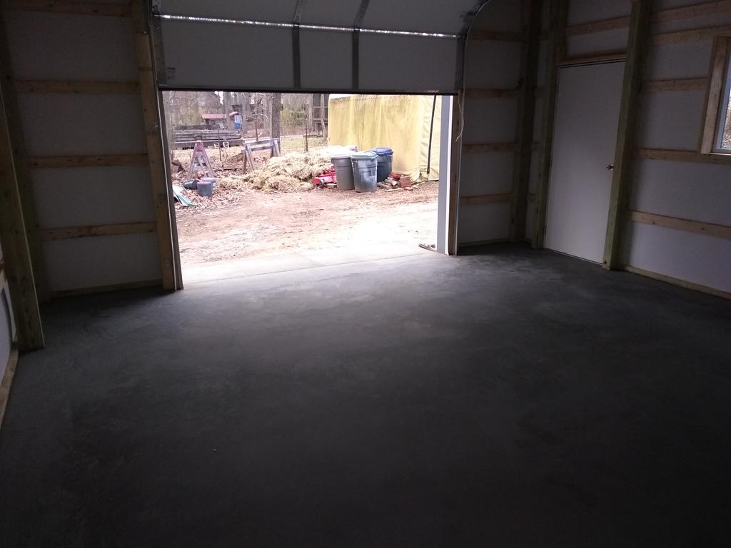

rmaynard 17,496 #76 Posted March 18, 2020 Concrete is finished. 6 9 Share this post Link to post Share on other sites

prondzy 3,890 #92 Posted March 18, 2020 Looks great, but the question we're all wondering is: Did ya fill it yet? 2 Share this post Link to post Share on other sites
rmaynard 17,496 #93 Posted March 18, 2020 3 hours ago, prondzy said: Looks great, but the question we're all wondering is: Did ya fill it yet? The concrete guys told me to wait about 5 days before driving on it. Share this post Link to post Share on other sites

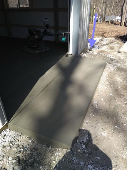

rjg854 13,277 #94 Posted March 18, 2020 No floor drain Pitch to the concrete? Share this post Link to post Share on other sites

rmaynard 17,496 #97 Posted March 19, 2020 13 hours ago, rjg854 said: No floor drain Pitch to the concrete? Nope, no drain. No slope except for the apron. The building is water-tight. Rained hard last night. Overhead door seals tight. I have installed perimeter drainage around the base of the building so water can't come in from below. 3 Share this post Link to post Share on other sites

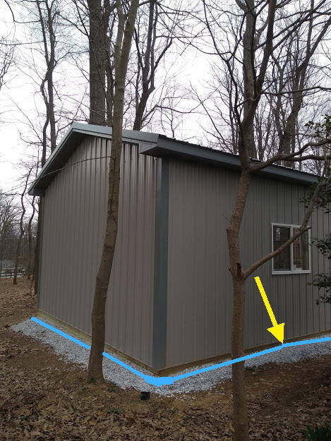

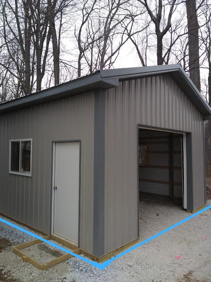

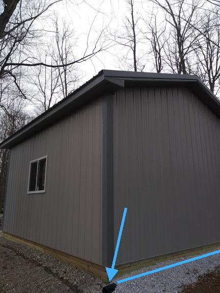

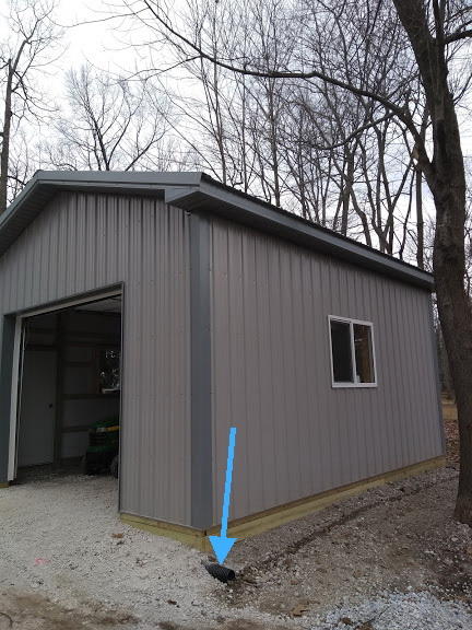

tunahead72 2,640 #99 Posted March 19, 2020 1 hour ago, rmaynard said: ... I have installed perimeter drainage around the base of the building so water can't come in from below. Bob, can you give us some details on how you did this? I'm curious because I'm hoping to have a shed installed to protect my motorcycle this year, and drainage will be an issue. Also because one of your earliest photos in this thread showed a good bit of standing water in that area after last summer's rains. Share this post Link to post Share on other sites
rmaynard 17,496 #100 Posted March 19, 2020 (edited) 2 hours ago, tunahead72 said: Bob, can you give us some details on how you did this? I'm curious because I'm hoping to have a shed installed to protect my motorcycle this year, and drainage will be an issue. Also because one of your earliest photos in this thread showed a good bit of standing water in that area after last summer's rains. Sure. I wish I had taken more pictures of the whole process, but here is what I have. I dug a trench on 3 sides of the building and put in about 2" of #57 stone. Then I laid 4" perforated corrugated plastic pipe. In the picture below, the blue line indicates the location of the pipe. It's about 2" out from the perimeter of the skirt board, and 2" below the gravel. The top of the concrete will be 4-5" above the gravel shown on the outside, which means the drain pipe will be below the level of the bottom of the concrete floor. The yellow arrow indicates the high point of the pipe on the high side of the building. Water will drain to the right or left from this point. This was also done so that when rain gutters are installed, all the rain will run to the left, and the downspout will attach to the pipe at the back corner. Rain water will exit here on the lowest corner. And here on the front. The pipe goes under the apron. The gravel will be covered with drainage cloth, then back filled with topsoil. Hope this helps. Edited March 19, 2020 by rmaynard 2 1 Share this post Link to post Share on other sites
