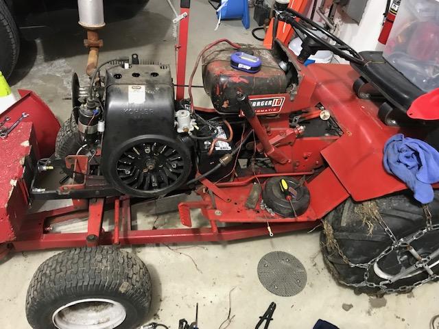

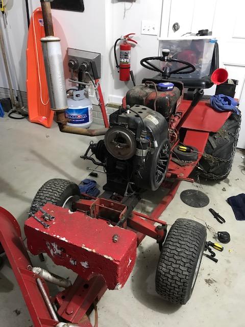

toroman04 20 #1 Posted February 22, 2020 Hi all, I picked-up a 72 (was told it was a 74) after doing some research on it, anyway I need some help on a picture/part # for the choke cable. I have a Charger 10 automatic with a Kohler K241-46636 Any help would be appreciated! I have never owned a Wheel Horse before so I am new to this! I traded a snowmobile trailer for it.... It did not run, but did come with extra parts like: carb, ign. switch, starter, coil, front rims and tires, rear fender and a weight box. No mower deck but does have a plow. I seem to think I got the better end of the deal! 3 1 Share this post Link to post Share on other sites

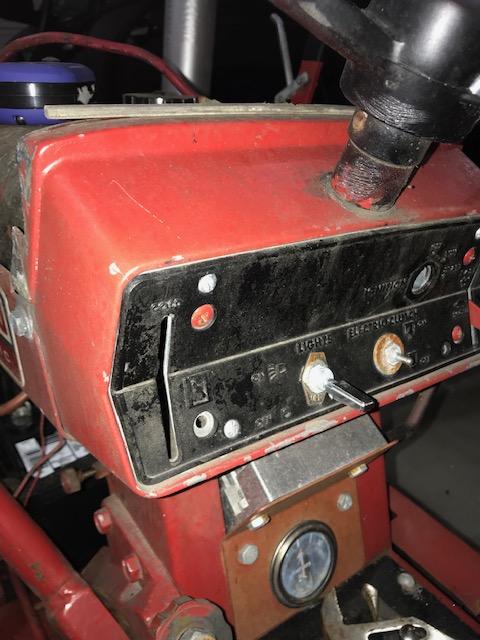

toroman04 20 #7 Posted February 22, 2020 here are a few pictures, what's throwing me off is what you see here (dash pic) Looks like same as throttle cable .... but is it actually a pull/push as there is a spot there or just a screw missing. Share this post Link to post Share on other sites
rjg854 13,341 #8 Posted February 22, 2020 That choke lever is the same style as the throttle Share this post Link to post Share on other sites

toroman04 20 #10 Posted February 22, 2020 I sure think i did get the better deal! lol though it has no spark and didn't run.... not a problem for me! I need to get a few more things for it yet.... air filter, fuel filter, new plug, drive belt and choke cable. 2 Share this post Link to post Share on other sites
ebinmaine 80,605 #11 Posted February 22, 2020 1 hour ago, rjg854 said: That choke lever is the same style as the throttle Share this post Link to post Share on other sites

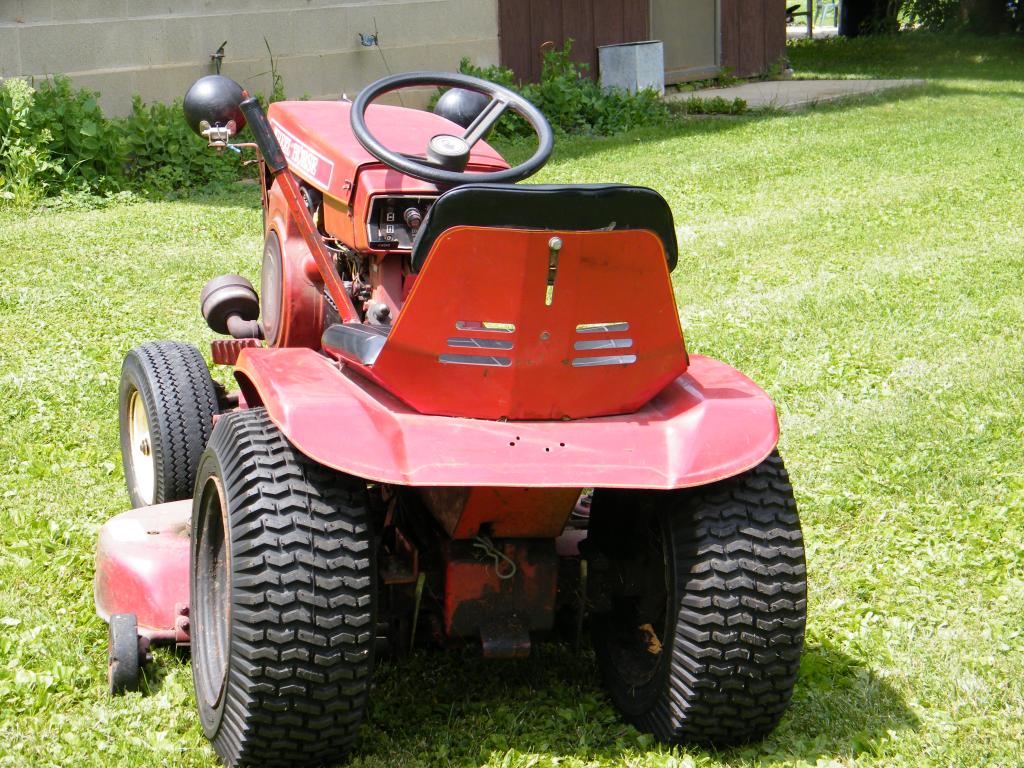

stevasaurus 23,845 #12 Posted February 22, 2020 Here is a 1972 Raider 10...yours should be the same. You can see the choke handle in this picture. Contact A-Z Tractors...one of our vendors in the vendor section. He should be able to help with the choke cable and more. Welcome to Red Square 3 Share this post Link to post Share on other sites

toroman04 20 #16 Posted March 1, 2020 Thanks for all the help so far! I got a number to contact tomorrow for the part! Got a new plug, air & pre-filter along with a drive belt put on, now time to drain the transmission change filter and re-fill 1 Share this post Link to post Share on other sites

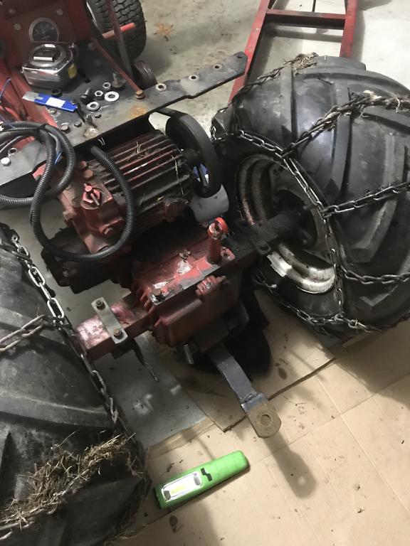

peter lena 10,047 #19 Posted March 4, 2020 toroman04, see that you are going to change that trans fluid, good idea to cut off the shift boot with a razor blade and replace it , usually the cause of water getting in the trans. when you replace the boot lubricate the shifter shaft with grease for ease of installation. pete Share this post Link to post Share on other sites
toroman04 20 #20 Posted March 4, 2020 Hi Peter lena, It is a hydro, so is that/there a boot on that? I haven't seen one under there. Share this post Link to post Share on other sites

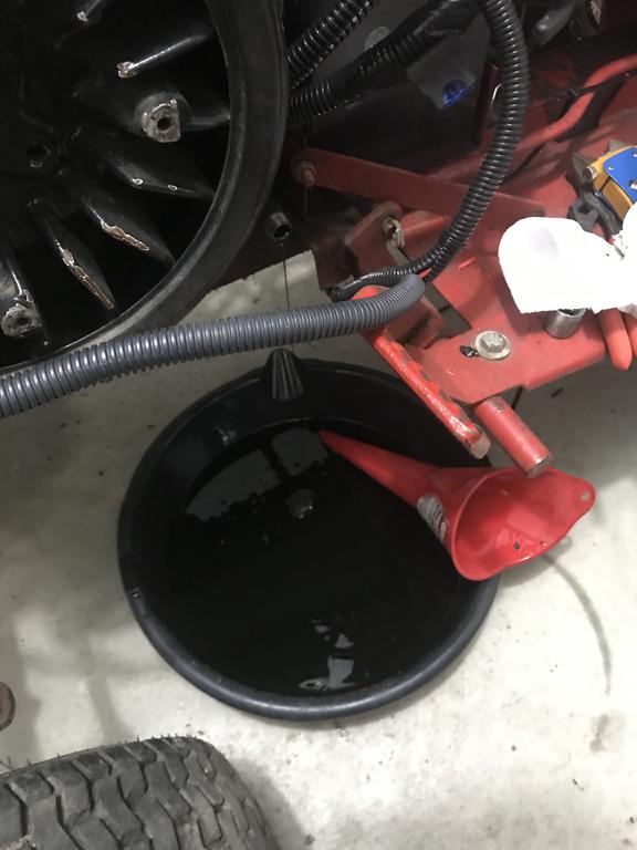

toroman04 20 #21 Posted March 10, 2020 Engine oil along with trans fluid & filter done! Time to run thru the wash and clean frame! Share this post Link to post Share on other sites
