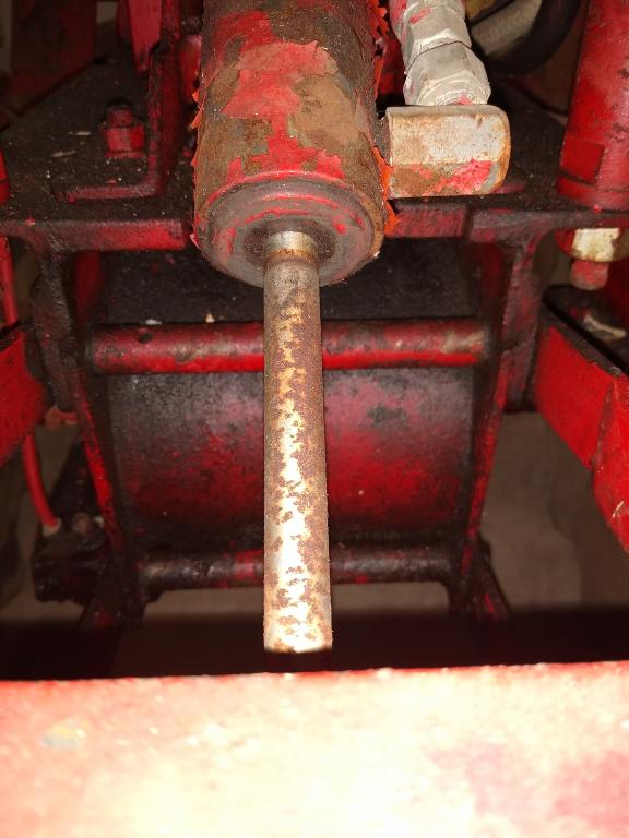

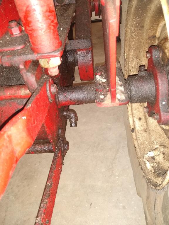

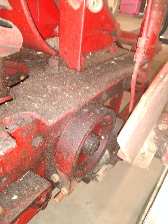

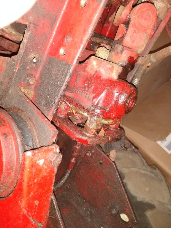

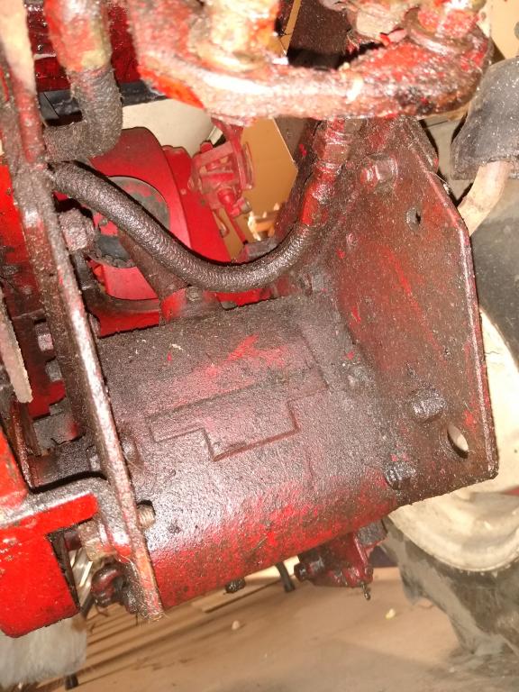

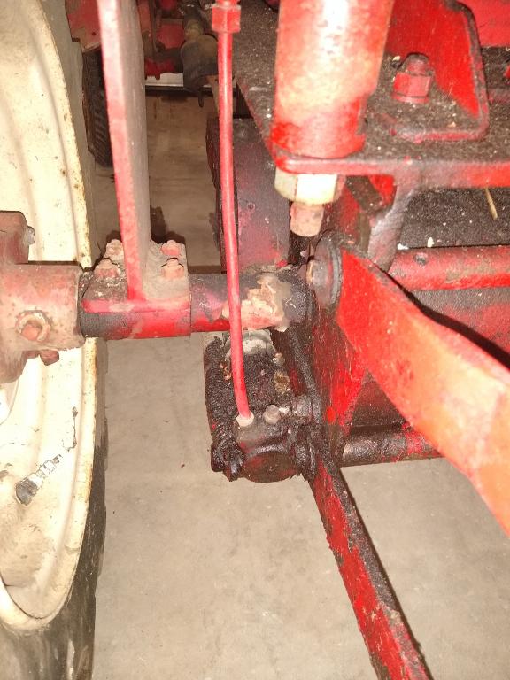

Red horse green horn 21 #27 Posted February 22, 2020 Any help identification on what parts may be wheel horse and what any of them might be. I'm curious what it started out as Share this post Link to post Share on other sites
peter lena 9,849 #28 Posted February 22, 2020 definitely, a cornucopia of mixed up parts, would not be the first or last, WISCONSIN ENGINES ,used to be the engine in BOLENS TRACTORS, if that helps , very solid , and could be worth saving with abase line looksee and recovery. i have used RISLONE engine cleaner to clean out crud and dissolve engine varnish , with fresh oil and a gentle run in to heat up and listen to what you have. just the fact that you have many kinds of set ups in this pick up , will give you a lot of challenges , good luck with your choice, pete Share this post Link to post Share on other sites

953 nut 65,223 #38 Posted February 22, 2020 5 hours ago, Red horse green horn said: Any help identification on what parts may be wheel horse and what any of them might be. I'm curious what it started out as Both sides of your grill front, perhaps the transaxle (need a picture from the back to know) and probably the front spindles and rear fenders are . That's enough for me! 1 Share this post Link to post Share on other sites

AHS 1,674 #43 Posted February 23, 2020 Its looks like heavy duty hydraulics (which are a good thing!) the rear end looks different than a wheel horse. It looks like it has a wheel horse grille on it; not a WH frame. It looks strong!!👍💪 Share this post Link to post Share on other sites
Red horse green horn 21 #44 Posted February 23, 2020 It has a durst A18 gear box. I haven't found any numbers on the rear end yet. Share this post Link to post Share on other sites

Oldskool 6,678 #46 Posted February 23, 2020 12 hours ago, jabelman said: Maybe @Oldskool could check in, are some of these parts off a speedex? First off. Welcome to the group. You have come to the right place. This group is full of great and knowledgeable people. Second That is a very nice/interesting piece you have there. Well worth bringing back to life. As far as Speedex parts go, the GO pedal looks kinda like the one on my S18. Do you have a pic of the bottom end of the steering shaft or any underneath pics? 1 Share this post Link to post Share on other sites
