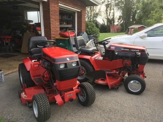

tom2p 2,394 #5 Posted February 20, 2020 (edited) you can install the 8" wheels and not replace the spindles the difference is minor - 8" wheel/tire approx 1" diameter difference that results in 1/2" height difference that can easily be compensated with a mower deck adjustment I installed 8" fronts on my 312-8 without changing spindles ( I had shorter height spindles - but never used them ) my 312-8 with 8" fronts Edited February 20, 2020 by tom2p 1 Share this post Link to post Share on other sites
tom2p 2,394 #6 Posted February 20, 2020 ( more ) and with a RD deck - the clippings are better dispersed with the front of the deck a tad higher ; much less clumping 1 Share this post Link to post Share on other sites
