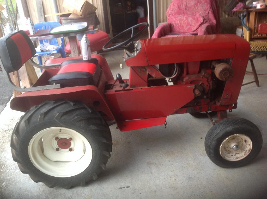

Lane Ranger 12,161 #1 Posted February 18, 2020 (edited) What size is the 953/1054 idler pulley? we are working on a 953 that either has a stretched #1592. Drive belt (1/2 x 82). Or an idler pulley that is the incorrect size. the previous owner put a cub cadet hydro pump on this which is incorrect. That is why hydro pump does not have the pulley on it. The cub housing sticks out father than the Wheel Horse Hein Werner hydro pump! Edited February 18, 2020 by Lane Ranger Share this post Link to post Share on other sites
squonk 48,338 #2 Posted February 18, 2020 Lane, the pulley looks like the right style. Lets see the belt. Belts don't stretch. The sides wear down causing the belt to fit deeper in the pulley giving the illusion that it's longer. Maybe a "retired guy "here can measure a pulley as I'm leaving for work. 1 Share this post Link to post Share on other sites

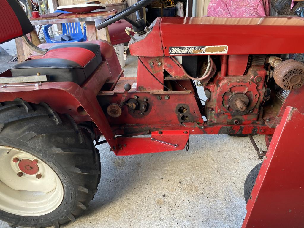

oliver2-44 11,821 #8 Posted February 19, 2020 Any back story to the green paint remnants? What was someone trying to access with those torch cut holes? Share this post Link to post Share on other sites
Lane Ranger 12,161 #9 Posted February 19, 2020 1 hour ago, oliver2-44 said: Any back story to the green paint remnants? What was someone trying to access with those torch cut holes? No knowledge on green paint but previous owner tried to access the Ross Steering gear parts without removing. 1 Share this post Link to post Share on other sites
