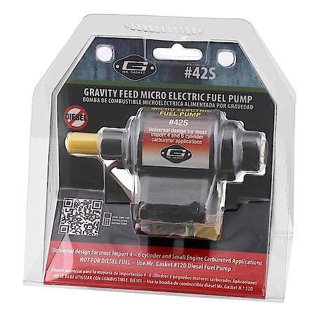

JoeM 9,680 #27 Posted February 19, 2020 Another option; MrGasket 42S. I have a couple that have been running good. No float issues either. Don't know for sure, but they might be china made. Sometimes on stock at Advance, available on Ebay, Jegs etc. $32 and under if you shop around. I do notice one thing they warn you about, gasoline versions should not be used on diesel. Not sure why. Share this post Link to post Share on other sites
