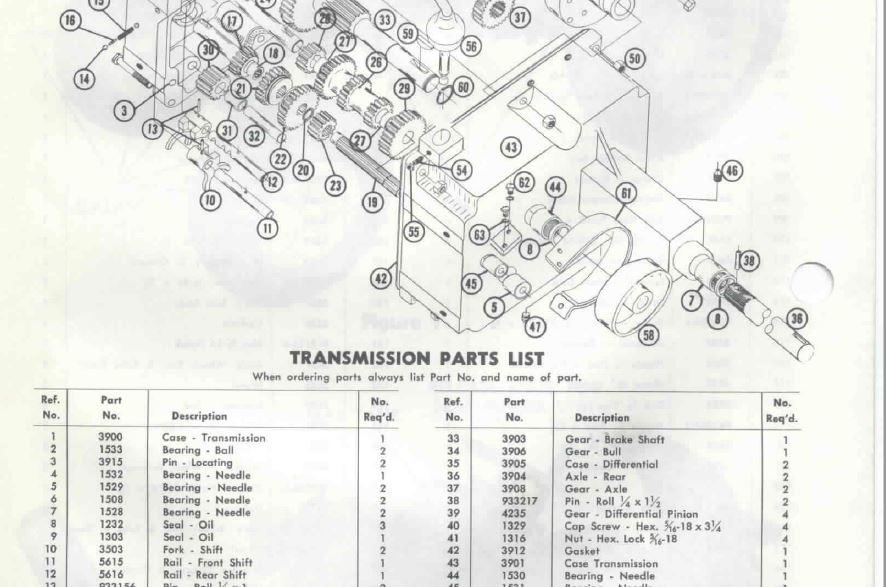

Dr.D 9 #1 Posted February 14, 2020 Stupid question, I am new and working up the nerve to rebuild my 5025 trans. I been studying the posts. Does 5025 use a gasket for the case? I don’t see one referenced. Share this post Link to post Share on other sites
Racinbob 13,250 #2 Posted February 14, 2020 Yes. Part # 3912. It's very easy to make one as well. 1 Share this post Link to post Share on other sites
pfrederi 21,274 #3 Posted February 14, 2020 Yes .. a bit hard to pick it out in the parts explosion #42 WH# 3912 1 Share this post Link to post Share on other sites
The Tuul Crib 7,354 #4 Posted February 14, 2020 Wheelhores parts and more. Lowel has these but you might want to call him first to make he has some. Share this post Link to post Share on other sites
Dr.D 9 #5 Posted February 14, 2020 (edited) Thank you... Yup... I went through the Tans parts list line by line and finally saw it. Part #3912 Toro lists it for $7.95 I was surprised to find how many parts Toro still lists. Any thoughts about updating with new guide rails? Are the rails the only parts necessary to swap in? Edited February 14, 2020 by Dr.D Share this post Link to post Share on other sites
