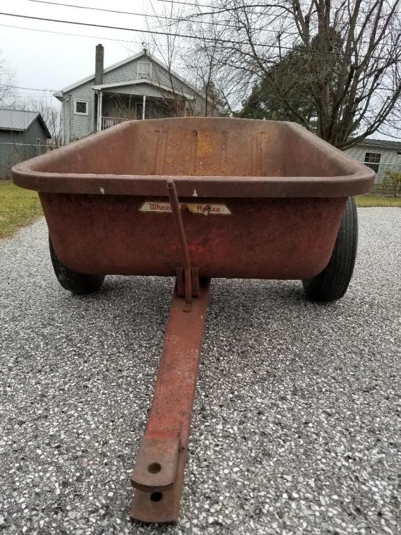

cafoose 3,135 #1 Posted February 13, 2020 Look what jumped in my truck today! He was asking $200 and I offered $100 cash and he took it! It just has a few holes in the bed which is why I offered $100 8 5 2 Share this post Link to post Share on other sites
ZXT 2,394 #2 Posted February 13, 2020 (edited) I know where one of those is, in pretty darn good shape. I figure I could get it for half of that. I guess I probably ought to get it! Excellent buy, by the way! Looks great! Edited February 13, 2020 by ZXT 3 2 Share this post Link to post Share on other sites
953 nut 51,654 #3 Posted February 13, 2020 Even has the factory original tires on it, nice pick. 2 Share this post Link to post Share on other sites

cafoose 3,135 #8 Posted February 13, 2020 If you look closely at this you may be able to see the pinholes is the bed. How can I fix it? Share this post Link to post Share on other sites
Pullstart 59,687 #9 Posted February 13, 2020 Without cutting a patch out and welding in, I bet PC-7 is the strongest alternative... or JB-weld. 1 1 Share this post Link to post Share on other sites
Stepney 2,314 #10 Posted February 14, 2020 I welded a few patches in mine, skimmed the tough bits with JB Weld, built a dam of light plastic to hold it up. And set a heat lamp to it. Gave it a week and ground smooth. For the light use mine will see, it's good enough. 1 Share this post Link to post Share on other sites
ZXT 2,394 #11 Posted February 14, 2020 I'd take and spray the rusty area with POR-15, and if you don't want to weld a patch in, I'd buy some "tiger hair" or "bondo glass" (same thing, different names). It's fiberglass reinforced and is extremely strong when dried. I would cover the pin holes on the under side with tape to keep the stuff from seeping through when wet, and apply a thin layer on the top half. Sand smooth when dry and paint. 1 1 Share this post Link to post Share on other sites
cafoose 3,135 #12 Posted February 14, 2020 1 hour ago, ZXT said: I'd take and spray the rusty area with POR-15, and if you don't want to weld a patch in, I'd buy some "tiger hair" or "bondo glass" (same thing, different names). It's fiberglass reinforced and is extremely strong when dried. I would cover the pin holes on the under side with tape to keep the stuff from seeping through when wet, and apply a thin layer on the top half. Sand smooth when dry and paint. Sounds like a good idea I've worked with fiberglass filler before. I think that's what I'll do 2 Share this post Link to post Share on other sites
ZXT 2,394 #13 Posted February 14, 2020 1 minute ago, cafoose said: Sounds like a good idea I've worked with fiberglass filler before. I think that's what I'll do I've used it on floor pans in old cars that had some pinholes (Even fairly large stuff in a buddys car, up to 1/2" large). Not the "correct" way to do it, but I'm not selling my cars or passing them off as perfect. I figure if it works there, it'll work just as well here! Good luck with your repair! 1 1 Share this post Link to post Share on other sites
