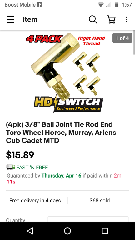

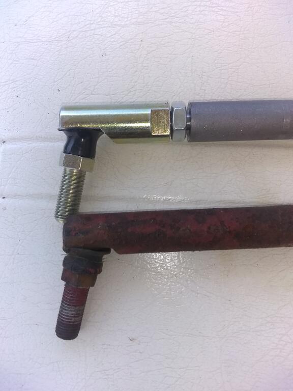

bottjernat1 2,197 #26 Posted April 13, 2020 Has anybody tried these tie rods i found online? 3 Share this post Link to post Share on other sites
Achto 32,632 #27 Posted April 14, 2020 22 hours ago, bottjernat1 said: Has anybody tried these tie rods Those ends should work just fine & even if they wear out they will be easy to change. 2 Share this post Link to post Share on other sites

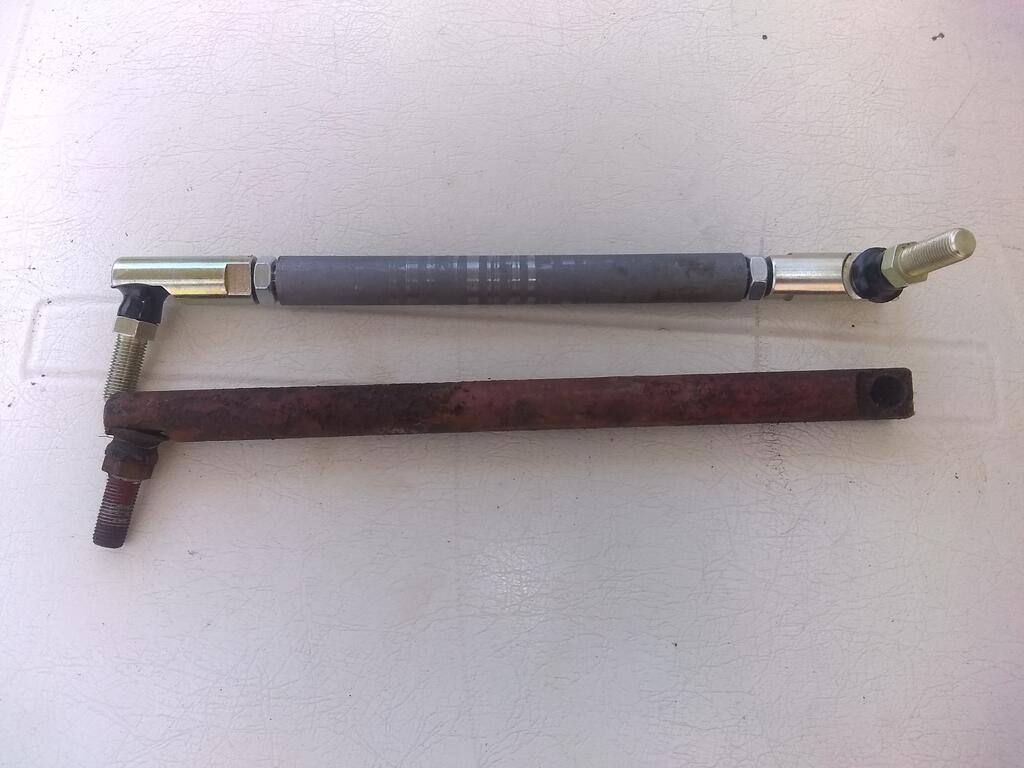

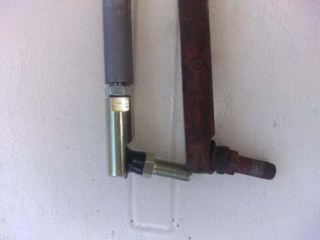

Achto 32,632 #28 Posted April 14, 2020 I used ends similar to those recently to repair a set of tie rods. I cut the bad ends off from the stock tie rods, turned them down to 3/8", then threaded them to 3/8- 24. Finished product. 3 Share this post Link to post Share on other sites
bottjernat1 2,197 #29 Posted April 14, 2020 I like the idea heck yeah!! 1 Share this post Link to post Share on other sites

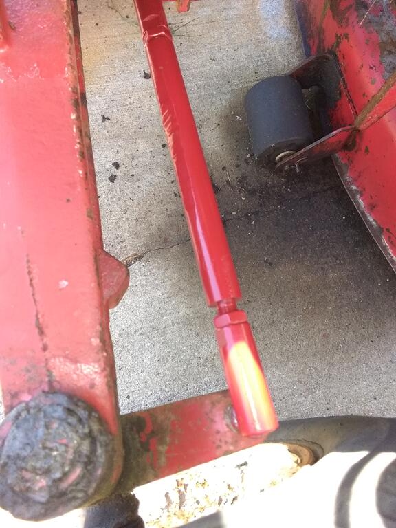

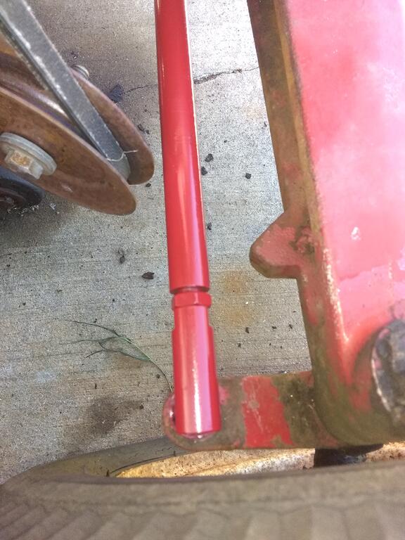

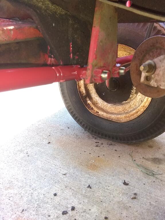

bottjernat1 2,197 #33 Posted August 10, 2020 Well got my daughters old 69 electro 12 tie rods done! Got them milled and threaded! They work perfect. I had my daughter prime and put a coat of paint on them yesterday. 1 Share this post Link to post Share on other sites
troutbum70 858 #34 Posted August 10, 2020 Well done very nice 1 Share this post Link to post Share on other sites

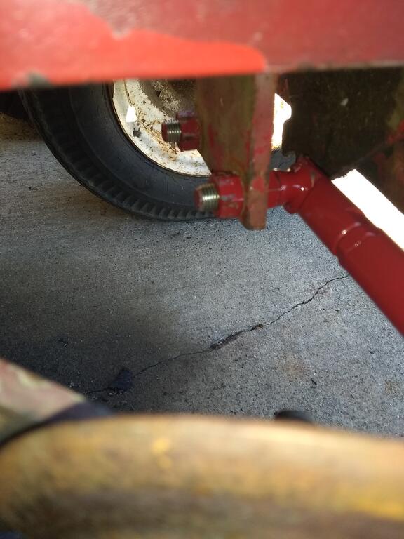

bottjernat1 2,197 #35 Posted August 13, 2020 Here is my daughters tie rods mounted i mounted them last night. 2 Share this post Link to post Share on other sites
