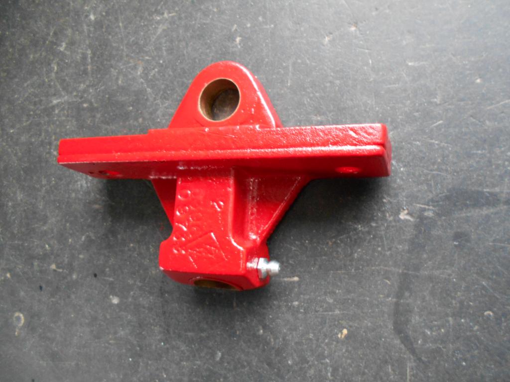

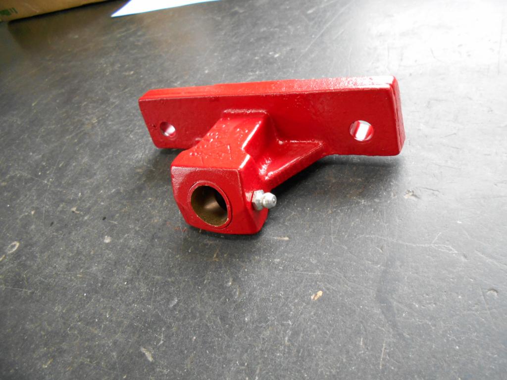

cleat 9,132 #7 Posted February 9, 2020 I drill the block out to 7/8 then press in bushings. This gets done for both upper and lower steering shaft locations. For the upper I then drill a small hole in the bushing for grease to pass through from fitting. I would add a grease fitting for the lower shaft but there is not enough metal there and it would weaken it too much. 4 Share this post Link to post Share on other sites

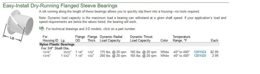

pfrederi 21,007 #9 Posted February 9, 2020 (edited) Drilling out to 7/8" is an excellent plan. However not everyone has a 7/8" drill and press. If you do not consider using a nylon sleeve bearing. Will it last as long?? NO but at $2.99 you can replace it after a couple years... Edited February 9, 2020 by pfrederi 1 Share this post Link to post Share on other sites

cleat 9,132 #11 Posted February 9, 2020 1 hour ago, pfrederi said: Drilling out to 7/8" is an excellent plan. However not everyone has a 7/8" drill and press. If you do not consider using a nylon sleeve bearing. Will it last as long?? NO but at $2.99 you can replace it after a couple years... That would work great I believe. These are used quite a bit throughout the tractor for motion control and PTO pivot points. Share this post Link to post Share on other sites

briankd 833 #13 Posted February 10, 2020 11 hours ago, cleat said: I drill the block out to 7/8 then press in bushings. This gets done for both upper and lower steering shaft locations. For the upper I then drill a small hole in the bushing for grease to pass through from fitting. thanks cleat for your help awhile back this is how i did mine worked great 1 Share this post Link to post Share on other sites
