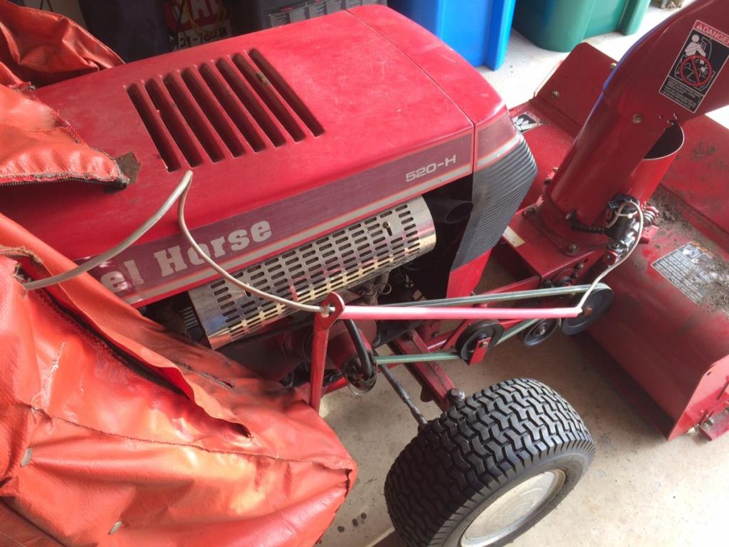

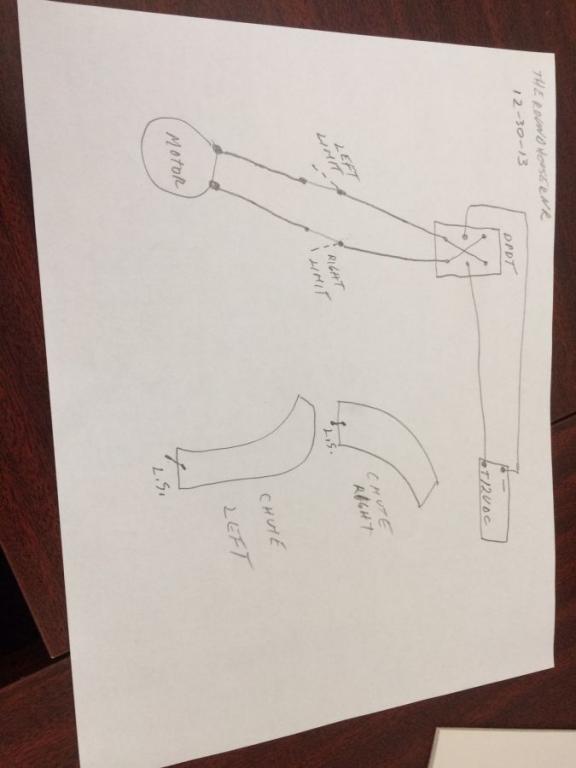

56servi 67 #1 Posted February 8, 2020 I added a 12v motor to my tall chute snowblower on my 520. Used the same setup as THEROUNDHOUSERNR posted on Dec 30, 2013. Works great except when I run past the chute teeth when turning left or right. I am using a momentary DPDT switch for a wench to turn. I thought I could stop it by watching when it was at the end of the teeth, but I can't see the teeth when ib the cab. When it goes past the teeth it pushes the gear away and then won't turn until I get out and push the gear back into the teeth. My thought is to use 2 roller limit switches. One for each direction. Run the wires from the DPDT switch to the limit switches, one to each switch. The DPDT changes the motor direction by switching + & - to the motor. Using a normally closed limit switch would open one of the 2 switches when a limit is reached. Depending on direction the + or - side would be opened stopping the motor. Share this post Link to post Share on other sites
R Scheer 516 #2 Posted February 8, 2020 Only problem I see is when you hit the limit switch you've killed power to the motor. You would have to manually rotate the chute until the limit switch closes again. I would look at doing a latching relay. When the cw limit switch picks up it sets the latching relay to run the motor ccw. Similar for the ccw limit switch, it would toggle the motor to run cw. This way when you hit the limit switch the chute would start turning in the opposite direction automatically. You could wire a momentary toggle switch to operate the latching relay so you can select direction from you dashboard. You'd need a spst toggle switch as well for on off. Just thoughts. Share this post Link to post Share on other sites
56servi 67 #3 Posted February 8, 2020 I knew this idea was too easy to work Thanks for pointing that out Share this post Link to post Share on other sites

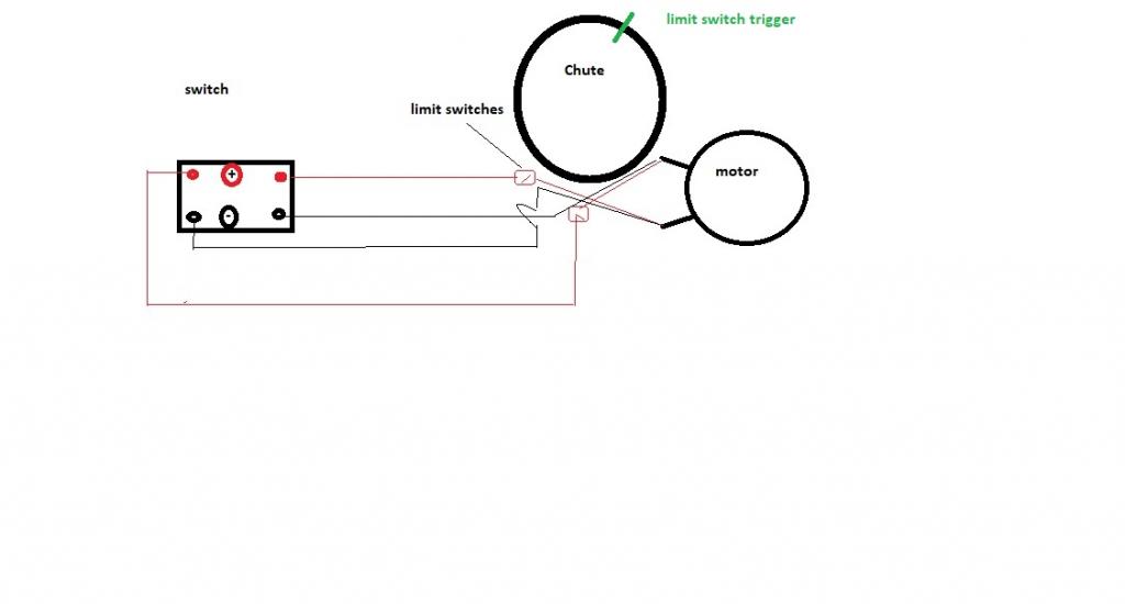

wallfish 20,510 #4 Posted February 8, 2020 Two of those limit switches will work because it will only cut power in the direction the chute is turning. Power to turn it in the other direction still exists when set up properly. Only issue may be the switches, so they will need to be protected from weather and snow and also whatever is triggering the switches. My 2 stage uses basically the same setup you have but it uses a power window motor. I can easily see the chute and gears but would prefer an easier method. The motor isn't as strong as yours so it will stop when it binds. I was think'n of grinding in new teeth all the way around the chute so it can spin 360. Another idea is to go with a sprocket on the motor and a roller chain to eliminate that worm gear drive. Teeth would still have to be ground into the chute or add a sprocket to the chute. Just so happens #35 bicycle chain fits pretty good into the existing teeth on the chute. I picked up a 2 piece aluminum sprocket to fit the chute but haven't got to doing anything with it yet. If you can find a thread done by Wheelbearing, he did an excellent mod to his chute with a chain. It was a 2 stage but still the same basic principles apply 1 Share this post Link to post Share on other sites
R Scheer 516 #5 Posted February 9, 2020 Wallfish Could you elaborate on how you would still have power to the motor when the limit switch is reached? I'm just not seeing it based on the 56servi schematic. Not trying to argue, just want to learn. Now maybe if diode was added to the between the NO connection and COMMON on the limit switch... This would stop the motor when the limit is reached but still allow it to turn back. Just have to make sure the diode has the current rating, and make sure it's pointing the right direction. Share this post Link to post Share on other sites
wallfish 20,510 #6 Posted February 9, 2020 Based on his schematic it won't work but wiring it correctly with the limit switches it will work. Concerns with it working wasn't really based on his drawing but I probably should have explained it better. By connecting the limit switches at the X part he has on his drawing of the dual pole switch it will only cut the connection to the motor to one side at a time. The switches need to be wired in before the cross over to the reversible direction motor connections. The dual switch only feeds power to the side it's thrown to, so the other side is always temporarily dead until the switch is thrown to that side. Reversing the polarity is what reverses the motor so that's why you see both + and - to both sides of the motor. I don't know what the symbol is for a limit switch in schematics but hopefully this crude drawing will help. Not to scale and the real locations for limit switches and the triggers will need to be set up properly Share this post Link to post Share on other sites
R Scheer 516 #7 Posted February 9, 2020 Thanks for clearing up my confusion. Share this post Link to post Share on other sites

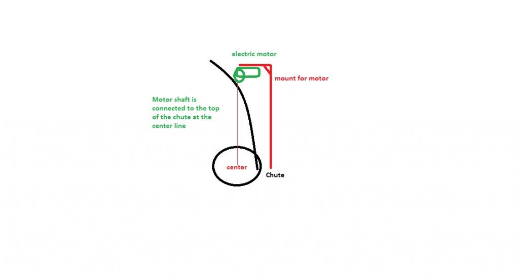

wallfish 20,510 #8 Posted February 9, 2020 No problem. I should have explained the rewire to the limit switches. Another idea is to relocate the electric motor to turn the chute from the top center line. My Toro walk behind controls the chute like that but with a lever and gears vs an electric motor. With the motor shaft connected to the chute on top and on the center line, it can rotate it without restriction of the worm gear teeth. It's too late to get pics of the Toro but I will tomorrow. Here's the basic idea with another crude drawing. Share this post Link to post Share on other sites

56servi 67 #15 Posted February 11, 2020 I am going to use the 2 diode method that THEROUNDHAUSERNR showed in his 2013 post. I made a test circuit to test how it would work with junk parts I had laying around. I used 2 LED's to sub for the motor turning CW & CCW. The LED's only work with correct polarity so both don't come on at same time. THe diodes I had were small power the switch was not a momentary so I had to reverse by hans and the limit switched I found in a junk box. I need to buy the correct diodes & limit switches to put on my snowerthrower. The series of pictures shows the LED's on with the various limit switch positions I hope they show up correctly. Thanks for all the help Gene Share this post Link to post Share on other sites
