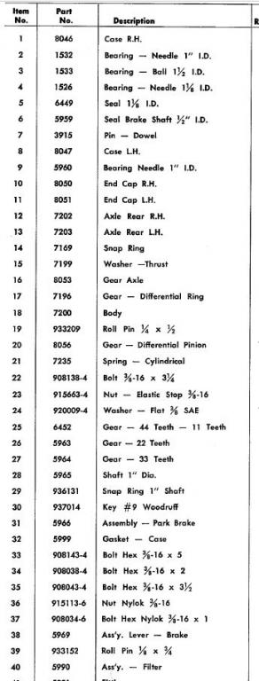

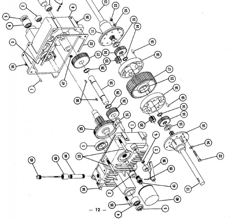

pfrederi 21,274 #5 Posted February 8, 2020 21 minutes ago, troutbum63 said: Okay I assumed same filter for both, I am looking for the wheel horse part number. I have friend that thinks he has a couple wheel horse filters he acquired some time ago with some other stuff, I was not sure if wheel horse used one filter both eaton or Sundstrand or engine oil. WH number is in the parts manual for your Electro. Share this post Link to post Share on other sites
troutbum70 858 #6 Posted February 8, 2020 Okay I did not find will search again tnx. Share this post Link to post Share on other sites
troutbum70 858 #8 Posted February 8, 2020 Tnx pfrederi I did find it not sure why but the last page was not scrolling up. Share this post Link to post Share on other sites

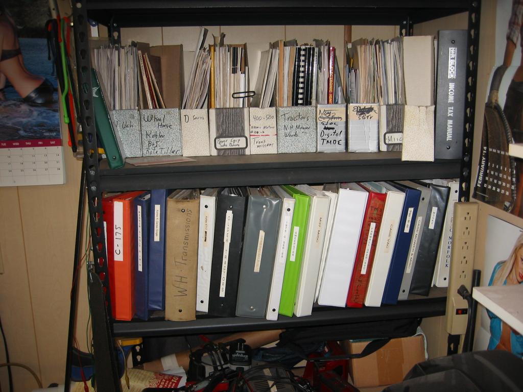

pfrederi 21,274 #9 Posted February 8, 2020 Print outs are faster and easier You can write notes on the pages as well like after market parts numbe s etc. Old school still works. 3 3 5 Share this post Link to post Share on other sites
troutbum70 858 #10 Posted February 9, 2020 Nothing wrong with hard copies, I am trying to advance to newer technology to save space and have all info in my shirt pocket. 1 Share this post Link to post Share on other sites
