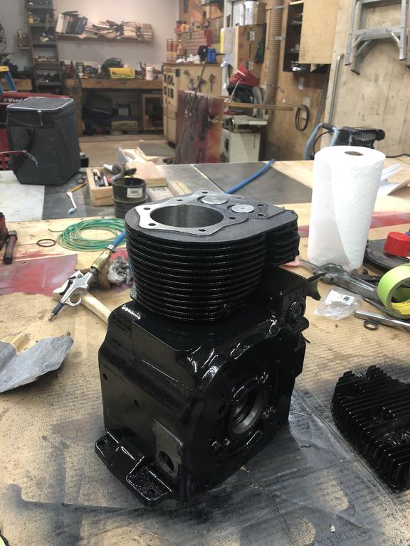

AHS 1,679 #30 Posted February 12, 2020 On 2/7/2020 at 7:58 PM, The Tool Crib said: Just got my Block back from the machine shop today along with the crank.The guy that did this for me is well known in hot Rod Magazine for his work on V-8 engines. When I got there today to pick it up he was working on a racing engine which was a 408 chevy engine. I had my 321 bored .010 over and the crank ground and polished to .010 under. He also ground the valve seats as well. He only charged me 80 bucks cash no ticket. The guy is 80 years old and still going!! You got it wrong! Take the Chevy 408 and bolt it in your wheelhorse! 😁💪 Share this post Link to post Share on other sites
The Tuul Crib 7,354 #31 Posted February 12, 2020 Wouldnt the be interesting!? That motor was going in a bracket car. I sure would've liked to here it run. Ill just have to settle for my little 14! BTW got the new rod for it today and will start putting it together when l get home today! . Should be running by the weekend 1 1 Share this post Link to post Share on other sites

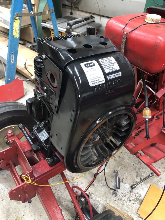

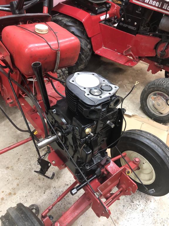

The Tuul Crib 7,354 #33 Posted February 14, 2020 I got home today and put some more parts together. Got the piston in along with the new rod. All machine work looked great and all specs as well. Hope to fire it up this weekend! 6 1 Share this post Link to post Share on other sites
The Tuul Crib 7,354 #34 Posted February 15, 2020 Its alive !! IMG_7560.MOV 1 Share this post Link to post Share on other sites
Stormin 9,988 #35 Posted February 15, 2020 Well done. I like the black paint job. 1 Share this post Link to post Share on other sites

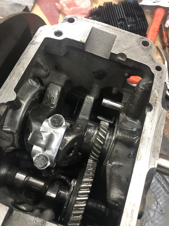

The Tuul Crib 7,354 #36 Posted February 29, 2020 Irv woke up today with a bad hiccup! got this 14 horse back up and running after the gasoline in the crank case due to these wonderful Chinese POS things they call a fuel pump! It ran like a top the first time until I found out about the fuel pump. This time there's a rod knocking and there's pretty little shiny things in the oil! Hopefully it's an easy fix with another rod and might have to grind the crank. cause that's what it sounds like! News at 11 2 Share this post Link to post Share on other sites
953 nut 66,553 #37 Posted March 1, 2020 2 hours ago, The Tool Crib said: gasoline in the crank case Get an electric fuel pump and put this problem out to pasture. 2 hours ago, The Tool Crib said: there's a rod knocking Did you put the roc cap on with the oil kole toward the cam shaft? Share this post Link to post Share on other sites
The Tuul Crib 7,354 #38 Posted March 1, 2020 1 minute ago, 953 nut said: Get an electric fuel pump and put this problem out to pasture. Did you put the roc cap on with the oil kole toward the cam shaft? Yes l went back over this three times as well as every detail. Lesson learned. lm sure its a pump failure issue. Really sucks! Share this post Link to post Share on other sites
953 nut 66,553 #39 Posted March 1, 2020 6 minutes ago, The Tool Crib said: Really sucks! Gas will dilute oil quite a bit. Hope the crank wasn't hurt. When will the autopsy be conducted? Share this post Link to post Share on other sites
The Tuul Crib 7,354 #40 Posted March 1, 2020 7 minutes ago, 953 nut said: Gas will dilute oil quite a bit. Hope the crank wasn't hurt. When will the autopsy be conducted? Not sure , but on the other hand curiosity is going to kill me , human nature! I have another 12 horse at the machine shop now. I am from now on going with an electric fuel pump. Im having visions of a blue colored crank pin. I can only hope not!🤞🤞 Share this post Link to post Share on other sites

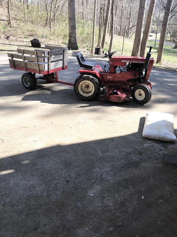

The Tuul Crib 7,354 #44 Posted March 8, 2020 Just changed out the first fill of oil and put in some fresh Rotella 30 weight. Finally got zeroed in on the carburetor and the governor. Going to put the mowing deck on it this afternoon and start working it!! 3 Share this post Link to post Share on other sites
The Tuul Crib 7,354 #45 Posted March 8, 2020 I'm already putting this tractor to work. There will be no slouches here!! IMG_7666.MOV 3 1 Share this post Link to post Share on other sites
