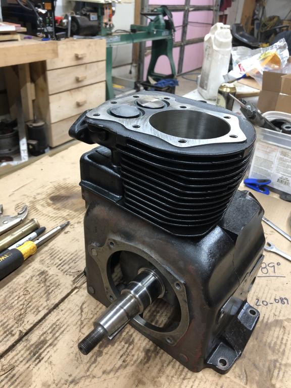

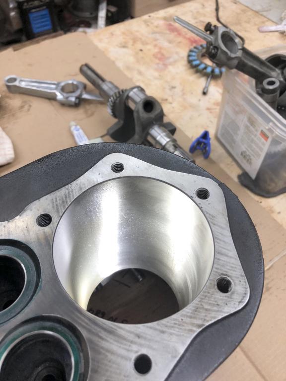

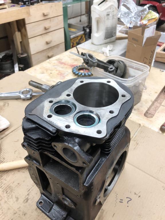

The Tuul Crib 7,354 #1 Posted February 8, 2020 Just got my Block back from the machine shop today along with the crank.The guy that did this for me is well known in hot Rod Magazine for his work on V-8 engines. When I got there today to pick it up he was working on a racing engine which was a 408 chevy engine. I had my 321 bored .010 over and the crank ground and polished to .010 under. He also ground the valve seats as well. He only charged me 80 bucks cash no ticket. The guy is 80 years old and still going!! 4 9 3 Share this post Link to post Share on other sites
The Tuul Crib 7,354 #2 Posted February 8, 2020 The cylinder had 3 1/2 thousands of an inch wear in the belly of the bore as well as the crank which had 3 1/2 thousands wear out of round also, Not bad for a 40 year old motor 1 1 Share this post Link to post Share on other sites

richmondred01 2,393 #12 Posted February 8, 2020 Since I retired I rebuild 3-4 k and magnum series per month. Ive used the same machine shop for decades and crank grinding is 75, boring is 80 valves 45. so 80 for the entire job is outstanding. Share this post Link to post Share on other sites
lynnmor 9,047 #13 Posted February 8, 2020 11 hours ago, 8ntruck said: Anybody else think that a 3 angle valve job would be a good idea in a Kohler? In order to get the correct diameter and width of the sealing surface, the adjacent surfaces need to be ground on any engine. Share this post Link to post Share on other sites

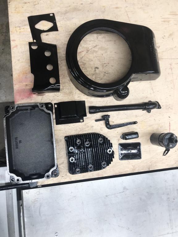

The Tuul Crib 7,354 #14 Posted February 8, 2020 Had to re-order a new 10 under connecting rod Because the one that I had was no good. No loss because it was in a batch of parts that was given to me. So now I have to wait until I get it on Wednesday. So today I thought I would do some painting on some parts and tins. Share this post Link to post Share on other sites

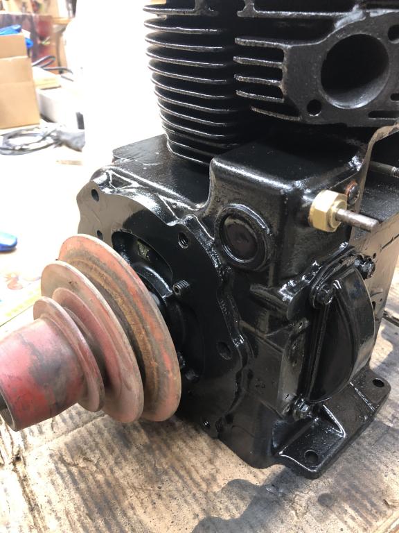

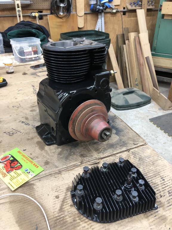

The Tuul Crib 7,354 #21 Posted February 9, 2020 So I'm getting bored sitting here waiting for the new rod to arrive for this motor. I'm thinking about PTO patina . Now say that a few times without stumbling! Man I got to get a life!! Is it spring yet? 64 and first sun shine in Three weeks!! that the temp here not my age! 1 Share this post Link to post Share on other sites
Stormin 9,988 #22 Posted February 9, 2020 Paint it silver. Go nicely with the black engine. Have a look at my Black Horse. Share this post Link to post Share on other sites
