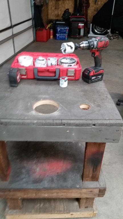

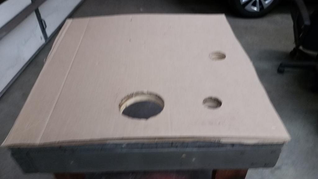

WHX?? 58,324 #1 Posted February 8, 2020 This probably belongs in the tools/equipment section but I don't care ain't often I come up with a good idea these days! Mods can move it they like.. Rescued this old cart out of Dad's garage... it has casters on it... anybody care to guess what it to be used for? Title of this section is a clue. Couple of strategically placed holes and some tearoff cardboard for easy clean up. 8 Share this post Link to post Share on other sites
953 nut 70,057 #2 Posted February 8, 2020 I have the same two hole layout on my transmission work table, one for the input shaft and one for the axle. 2 1 Share this post Link to post Share on other sites
ebinmaine 81,046 #3 Posted February 8, 2020 S'pose you'd be using that as transmission workin-on table... 1 1 Share this post Link to post Share on other sites
WHX?? 58,324 #4 Posted February 8, 2020 Well I guess that was easy! 'Spose you smartys have a differential holder too! 2 1 3 Share this post Link to post Share on other sites
ebinmaine 81,046 #5 Posted February 8, 2020 1 minute ago, WHX24 said: Well I guess that was easy! 'Spose you smartys have a differential holder too! I haven't even got the table.... Thought about building one a time or two but haven't got to it yet... I do like your diff holder. I just use a block of wood and a fair pile of patience. Share this post Link to post Share on other sites

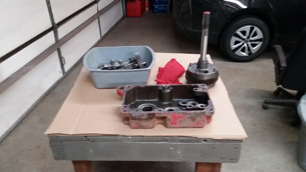

WHX?? 58,324 #7 Posted February 8, 2020 What's nice is the casters & your waiting for bearings to show up just roll it out of the way. Need to come up with some storage containers for extra bearings, seals, dog points etc. For the first shelf. .. spare trannys going on the middle shelf. Got tired of clamping them in a vise... very unstable and almost lost the whole shebang once. 5 Share this post Link to post Share on other sites
Achto 32,889 #8 Posted February 8, 2020 So does this mean that you will have tranny ready for paint next weekend??? You can even put it back together, I'll paint it as an assembly, that way you don't have to worry about scratching it. 5 Share this post Link to post Share on other sites
