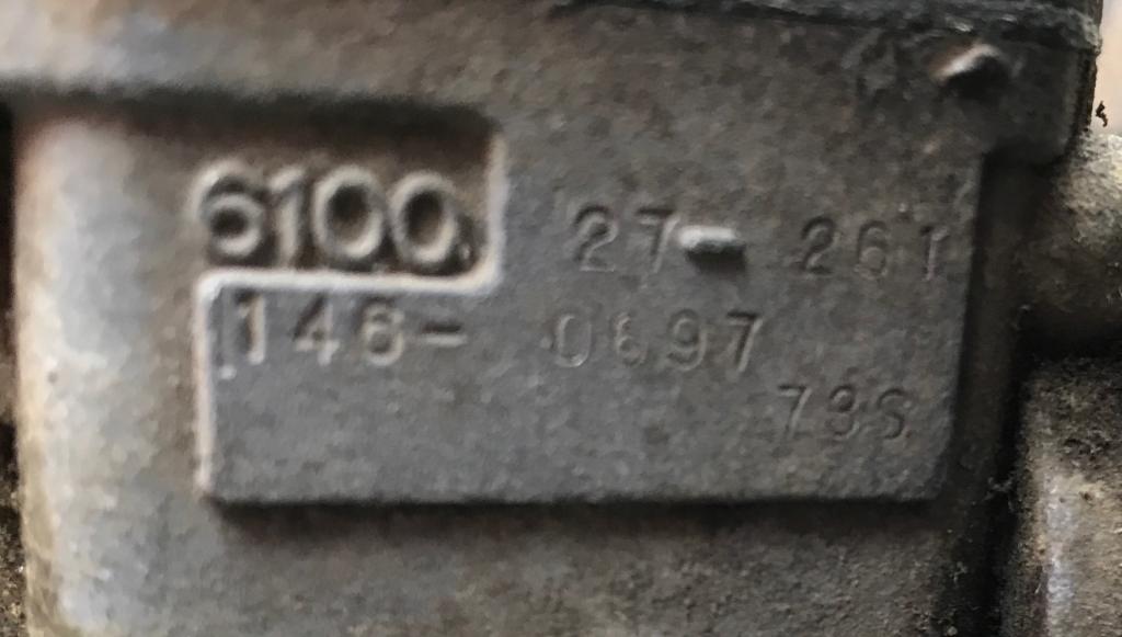

MPB 0 #1 Posted February 6, 2020 This one is on a 22 year old Ingersoll 6018 but I see A) emissions type are not re-buildable and B) can find a reliable replacement part number anyway. Chinese knock offs show 146- 06xx numbers for cheap? After keeping Stabil treated gas in it and running for 225 hours it surges badly all of a sudden. Replaced the impulse fuel pump and inline filter and generously sprayed and checked ports on inlet jets, etc so far but there is little left to consider. Share this post Link to post Share on other sites
WVHillbilly520H 10,378 #2 Posted February 6, 2020 I have 1996-97 P220G with the Nikki emissions carb and I know for a fact it is rebuildable as I did mine a few years back... Have you tried @onanparts.com or @boomers_influence they are our Onan parts guys. Good Luck and welcome to Red Square. https://onanparts.com/index.php?main_page=advanced_search_result&search_in_description=1&zenid=b4b5b69d081ec5d5476350c9124db295&keyword=146-0697 Share this post Link to post Share on other sites
MPB 0 #3 Posted February 6, 2020 Thx for the ideas. I had seen various posts on the topic but so far nothing specific to this carb Share this post Link to post Share on other sites
