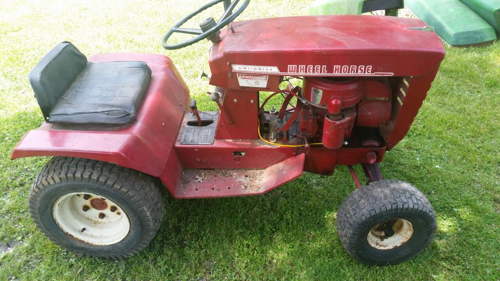

bottjernat1 2,197 #1 Posted February 3, 2020 Hello fellow Horse junkies! I was wondering where can i find a mower deck break down for my wife's 1969 commando v8? I haven't spotted one on here even tho im betting there is one on here. The motor is just about done I am hoping to pick it up from the guy working on it this weekend coming up. After i get it back in and figure out the front axle mess. I would love to mount the deck my late dad picked up for it. I don't know if they had 2 different decks or not. Also if anybody has photos of the deck and how it mounts that would be awesome. Thanks Share this post Link to post Share on other sites
stevasaurus 23,857 #2 Posted February 3, 2020 Noticed you have a vertical shaft there. Your model number would help. I did find an attachment list for the 1969 commando model #1-4841, but I suspect yours may be #1-7841. Anyway, mower deck #5-7361 comes up for the #1-4841. Go to the Manual Section and type... 1969 5-7361 there is a breakdown of this deck there. 1 Share this post Link to post Share on other sites
gwest_ca-(File Mod) 12,511 #3 Posted February 3, 2020 Some models to consider. I think they all have spindles that rotate counter-clockwise which is opposite to most models. The makes the replacement blades impossible to find because no longer available. 5-7361 Rear discharge 5-7362 Rear discharge 5-0611 Rear discharge 5-0612 Rear discharge 5-2365 Side discharge left side 5-0700 Side discharge left side 5-0701 Side discharge left side 5-0702 Side discharge left side Garry Adding A link to all we have on the CCW deck models. They are mixed up so read the titles carefully https://www.wheelhorseforum.com/search/?&q=ccw&type=downloads_file&search_and_or=or&sortby=relevancy 1 Share this post Link to post Share on other sites
