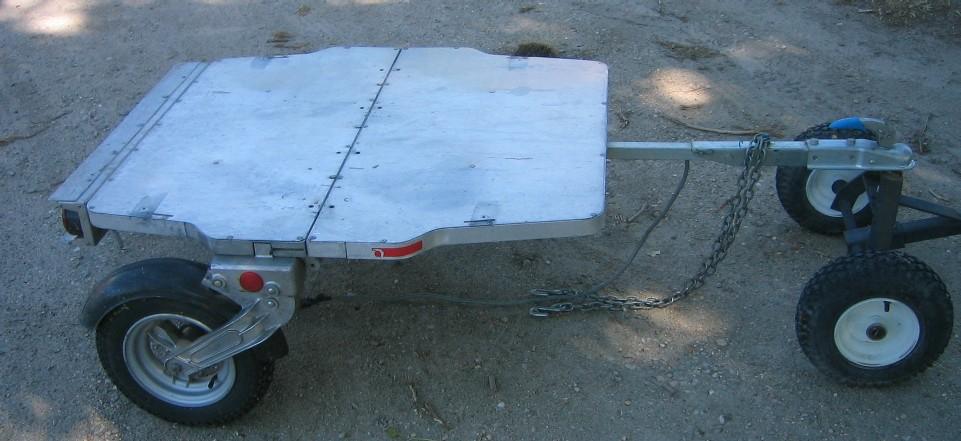

tom2p 2,394 #32 Posted February 6, 2020 10 hours ago, oilwell1415 said: How much does that weight and how much can it carry? That's pretty slick. been a while since I had it out the folding trailer part might weigh around 80 lbs ? the folding part includes tires/wheels, fenders, and lights - but without the tongue can lift the folding part with the strap/handle and carry it like a suitcase ... sorta/kinda my guess - the trailer might be rated for 300 lbs or so ... ? ... maybe 400 lbs ... ? 1 Share this post Link to post Share on other sites

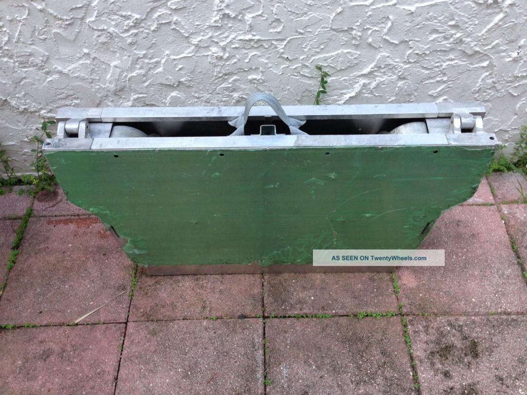

tom2p 2,394 #36 Posted February 6, 2020 btw - a Besco small folding aluminum trailer is currently listed on eBay I was not sure of the manufacturer - but this looks a lot like the one I have Share this post Link to post Share on other sites

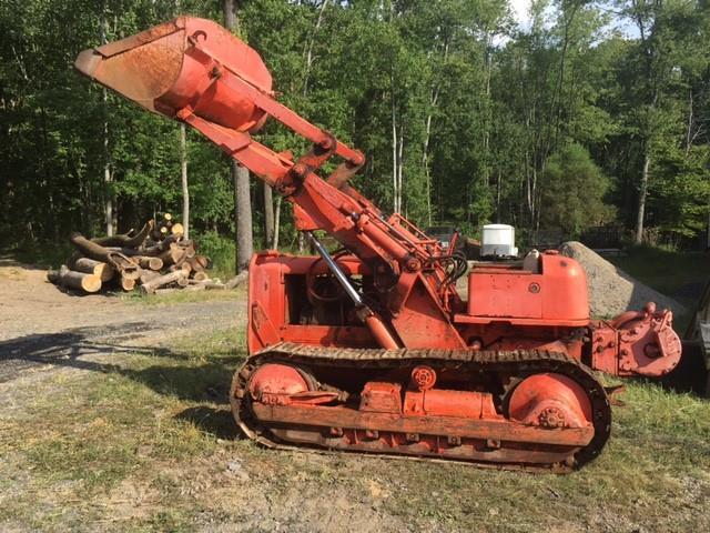

tom2p 2,394 #37 Posted February 6, 2020 (edited) we had an old HD5 Allis Chalmers front loader ('high lift') - similar to one in below pic but thr guy that bought it did not have a trailer (low boy) he loaded it on to a car hauler and drove home (with it loaded on the back of the car hauler) thought that machine was going to crush the car hauler ; HD5 small but very heavy machine Edited February 6, 2020 by tom2p 1 Share this post Link to post Share on other sites
Mudrig150 393 #38 Posted February 6, 2020 After doing some research, the besco folding trailer can haul 340 pounds. @tom2p Share this post Link to post Share on other sites

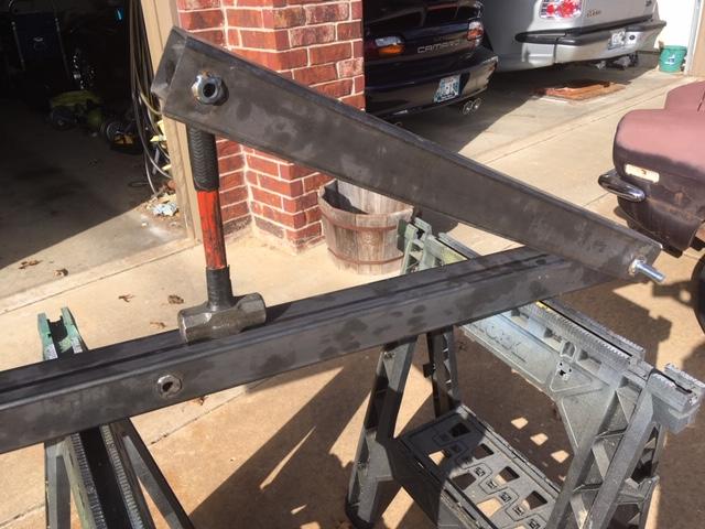

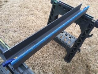

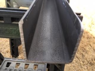

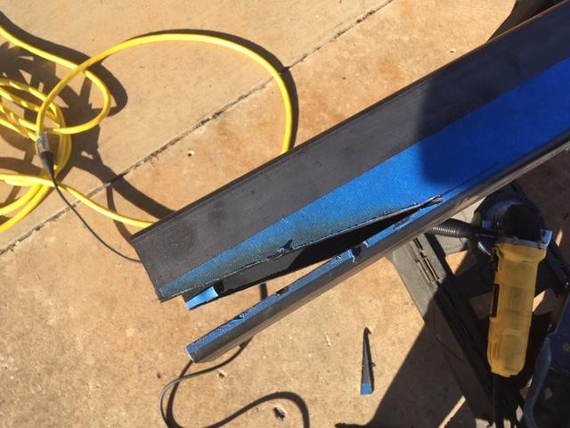

oilwell1415 563 #42 Posted February 16, 2020 Been knocking out other non-tractor related projects lately, but got to spend an hour or so on this today. I got all of the metal in to convert it to a dump bed, extend the tongue, and upgrade to a 2" ball. Step 1 of doing that is a piece of channel for the tongue to ride in, so I worked on that today. The tongue is going to be 3" square tubing (3" square was cheaper than the 2x3 I think I mentioned earlier) and I needed something that would hold it firmly. I had several thoughts on this, including just buying a piece of channel that would work, but I didn't find anything off the shelf that met my needs for a reasonable cost. Another thought was to get some 1/8" steel sheet and form it around the tongue, but I know I would have struggled to do that to my standards with the equipment I have available, so I scrubbed that idea. I ended up just getting 3' of 3.5" square tubing with a 3/16 wall and cutting one side out of it. This is a lot more strength than is needed, but it will make things easier later. In theory, 1/4" wall tubing would have fit the tongue perfectly, but add some paint and a little bit of torque and it would have been locked together. 1/8" wall would have been easier to work with and more in line with the needed strength, but would have left a lot of slop to get rid of. 3/16 seemed like a good compromise. I cut out the side of the tubing with the weld in it for a couple of reasons. Number 1 is that if I left the weld it would probably interfere with the tongue despite having 1/16" clearance on either side. The other reason is that the weld introduces stresses to the material that can cause it to warp if you leave the weld and cut out another side. I've still got some grinding to do, but here's what I ended up with as the sun was setting. The blue line you see in one of the pics was a strip of masking tape I laid down to use as a cutting guide since I was near the edge of the material. 2 Share this post Link to post Share on other sites

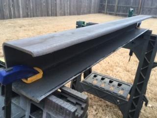

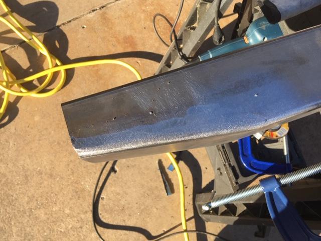

oilwell1415 563 #43 Posted March 22, 2020 It's been a while, but the weather has finally cooperated a little bit and I've gotten a little bit of work done the last week or two. I've been less than motivated since I'm into a part of the project that requires a lot of grinding and I hate grinding. The first thing I had to grind was the channel the tongue will ride in. This is what it started like on the left and what it ended up as on the right. Did I mention that I hate grinding? 2 Share this post Link to post Share on other sites

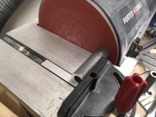

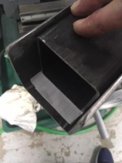

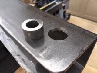

oilwell1415 563 #44 Posted March 22, 2020 After that I needed to mate the tongue to the channel above. The material for the tongue is 1/8" thick and the channel is 3/16" thick. I don't like putting a lot of load on material that thin, so I needed to make some inserts to spread it out. I used a piece of 1" OD x 5/8" ID tubing to make the inserts. I don't have a lathe, so I had to cut them to a rough length and the trim them to the exact length. I rough cut them using a sawzall and then finished them using a disc sander. That's also a really good way to make sure the ends are square. I made 2 inserts that were 3-1/8" long to put in the tongue and 4 about 9/16" long to use in the channel. I couldn't do both sides of the channel inserts on the sander, so I just trued up the end and then cut them leaving one end rough knowing it was going to get ground down anyway. 2 Share this post Link to post Share on other sites

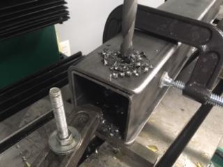

oilwell1415 563 #45 Posted March 22, 2020 After I cut the inserts I had to drill the holes in the tongue and channel to put them in. It is nearly impossible to do this one at a time and make them line up, so I did both pieces at the same time. The most common mistake when doing this is usually forgetting to allow a little space for paint between the pieces. My solution to that is to fold up some paper and put it between the two pieces before I clamp them together. The I put them on the mill and drilled the holes in several steps. The mill is at my work, so I have access to it. I was originally going to do this on my drill press at home, and that would work if it was all you had, but that would have been a nightmare. 2 Share this post Link to post Share on other sites

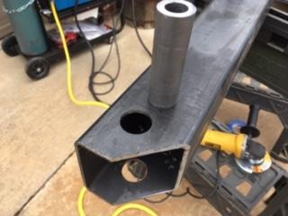

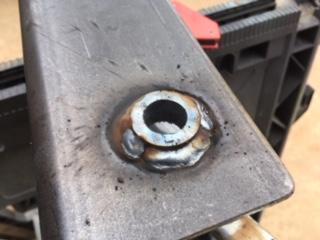

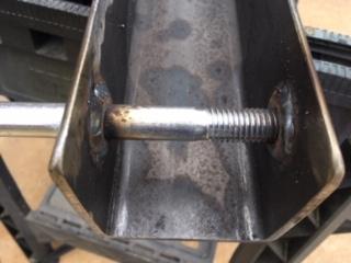

oilwell1415 563 #46 Posted March 22, 2020 With the holes drilled it was time to weld in the inserts. The inserts in the tongue were easy; just put them in the holes, center them up, tack them in place, recheck the location, and weld them in solid. Pretty easy stuff. I welded as much as I could reach on the rear insert where the tongue will pivot just because I had access to it. The front one where the pin will go I was only able to weld on the outside. These inserts don't just spread the load over a wider area, but they prevent the tubing from being collapsed by the bolt. That ordinarily wouldn't happen if you didn't overtighten the bolt, but this joint will see loads in every direction and that might eventually cause it to collapse. I'm sure this is way over engineered, but better safe than sorry and it's a pretty easy thing to do. The pivot joint is shown in the pics. The bevel was cut in it to allow it to pivot. I used my LBR (Looks 'Bout Right) meter to decide where to put the hole. 2 Share this post Link to post Share on other sites

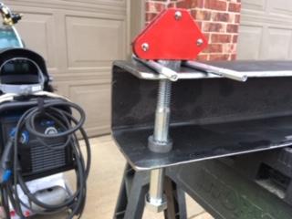

oilwell1415 563 #47 Posted March 22, 2020 The last thing I wanted to get done today is weld the inserts in the channel. This was a little more tricky than the tongue inserts because they needed to protrude equal distance on each side and be square with each other and the channel, but with two pieces to deal with that it easier said than done, but it's still not difficult. The first pic is the channel and insert. You can see here that the insert isn't just going to sit there and be straight because it wants to. I had to help it. This part of the project was what reminded me of how long it's been since I've done any work like this. I like the mental aspect of fabrication as much as the physical part, so solving these problems is fun for me. The solution I came up with was to lay two 1/4" bolts across the channel and hold them in place with a magnet. I butted the insert up against the magnet, put another insert in the opposite side, and ran a 5/8 bolt through the whole thing to keep the inserts straight. The magnet holds the bolt in place as well. I would have preferred to use a piece of 5/8 drill rod for this, but I didn't have any and wasn't going to go buy a piece just for this. When it all goes together I'll use a grade 8 bolt instead of this cheap one. I rough cut the inserts to about 5/8" so there would be a little extra on the inside to weld in the inside as well. Now I've just got to do a lot of grinding to get the inside of the channel done. I got a start on that today, but my grinding wheel is pretty worn out and couldn't reach far enough to get it all. I'll pick up a new one tomorrow and get that done. Our gym is closed indefinitely for the WuFlu, so as long as the weather cooperates I should start making decent headway again. 1 Share this post Link to post Share on other sites

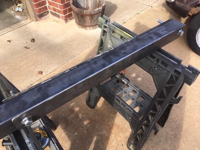

oilwell1415 563 #48 Posted March 25, 2020 I made good headway after work today. Got started with a lot of my favorite thing: grinding. But got the tongue fitted to the channel. Despite everything I did to make sure the holes lined up, I was worried that they wouldn't. But they did. I will run a 5/8 drill bit through the front one to make it a little smoother since it will have a hitch pin in it, but overall I'm pretty happy with how well it works. Share this post Link to post Share on other sites

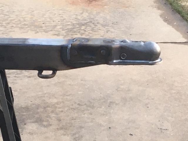

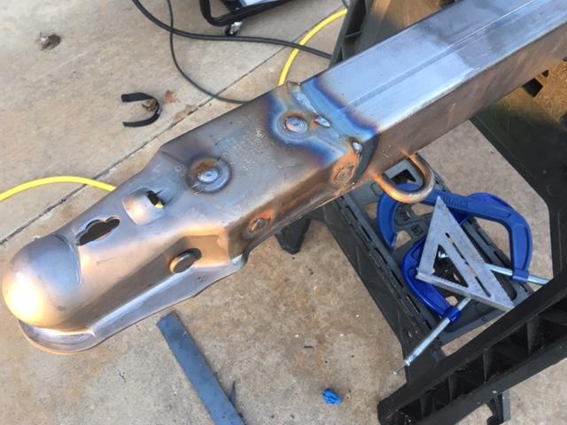

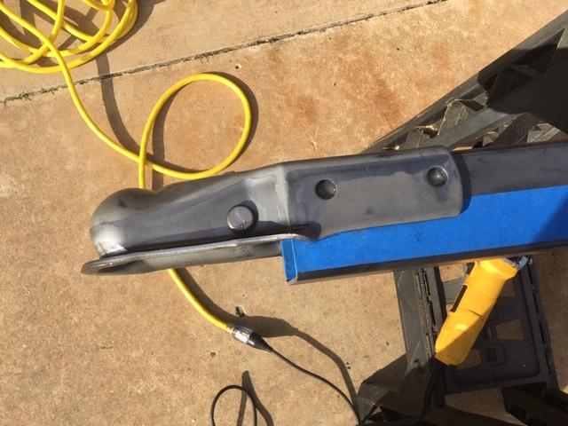

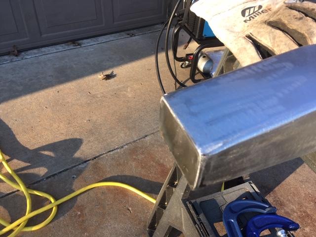

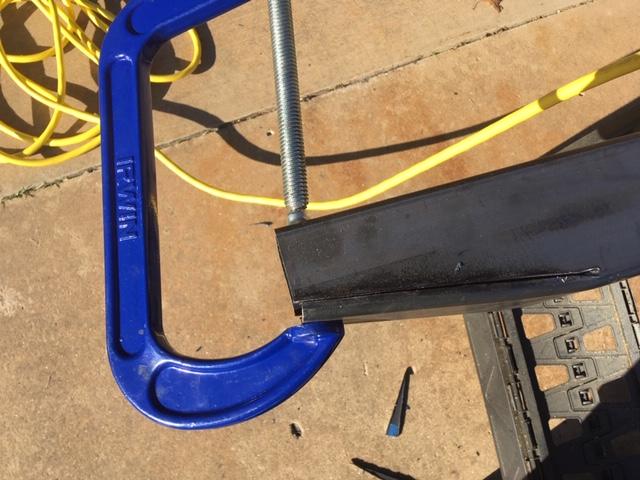

oilwell1415 563 #49 Posted March 25, 2020 Then it was time to mount the hitch. I put it on the tongue and really hated the way the tongue hung down below the hitch. At this point my wife would probably tell you I lost the plot, and you guys probably agree. There was no way I could leave that hanging in the breeze like that, so I decided to cut about an inch out of the front of it and add a taper. I put some tape on it so I could more easily mark where to cut and notched it with a cutoff wheel. I squished it down with a C clamp, welded it up, and ground everything smooth. Turned out pretty good. Looks much cleaner. I was getting ready to weld up the hitch when the ghost of my father came to me with his first bit of advice for the day. "If you ever give wasps or mud dobbers a place to live, they will move in." This is especially true in areas near where you will be putting your hands, so I welded up the end of the tongue before I mounted the hitch. They may still move in under the hitch, but at least I can see them there. If they got inside the tongue I wouldn't be able to see them until they were chasing me. 2 Share this post Link to post Share on other sites
oilwell1415 563 #50 Posted March 25, 2020 With my OCD impulses satisfied, I welded up the hitch. I am not a welder. I can make a weld pretty or I can make a weld strong, but I struggle with doing both at the same time. This was where my father's ghost gave me his second advice for the day: "The ugliest weld in the world is the one that fails and leaves your $%#@ laying all over the #$%& road." I cranked it up and burned it in good. When I was done I christened it with the phrase that man law states must be muttered any time you weld something, hook up a trailer, or tie anything down: "Well, that ain't going nowhere." I put on the loop for the safety chains and called it a night. Just needs some primer and it will be ready to put on the trailer. 3 Share this post Link to post Share on other sites
