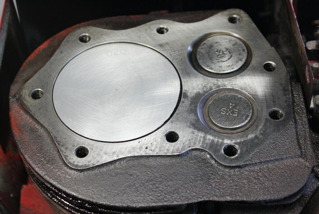

Mr Magoo 226 #30 Posted May 25, 2020 I got some time to get the head and block cleaned up this weekend. After cleaning the carbon off of the top of the piston this is not exactly what I wanted to see. Another rebuild is not happening with this block. Share this post Link to post Share on other sites
Mr Magoo 226 #31 Posted May 25, 2020 Well, looking at the specs I guess it can go over .020 over. That is of course dependent on how the cylinder measures. Share this post Link to post Share on other sites
richmondred01 2,393 #32 Posted May 25, 2020 Your piston reflects that it is at .020 over however, the block is stamped.010 over. It needs to to properly measured to be sure. Share this post Link to post Share on other sites
richmondred01 2,393 #33 Posted May 25, 2020 Your piston reflects that it is at .020 over however, the block is stamped.010 over. It needs to to properly measured to be sure. 1 Share this post Link to post Share on other sites
Mr Magoo 226 #34 Posted May 25, 2020 25 minutes ago, richmondred01 said: Your piston reflects that it is at .020 over however, the block is stamped.010 over. It needs to to properly measured to be sure. I noticed that too. I figured it was stamped .010 on the first rebuild. Share this post Link to post Share on other sites

Tuneup 1,459 #37 Posted May 25, 2020 You might be lucky as it appears that the piston is ground down at the exhaust valve point so is out of round at the top. Maybe the block is OK but a measure is required to be sure. The block is cast iron, after all. 1 Share this post Link to post Share on other sites
Mr Magoo 226 #38 Posted May 25, 2020 Having someone else rebuild one is not cost effective either from the little bit of research I have done. I guess it depends on if you really just want to keep it forever. Paying someone to rebuild one or buying one rebuilt quickly exceeds the market value of the unit. 1 Share this post Link to post Share on other sites
Mr Magoo 226 #39 Posted May 25, 2020 2 minutes ago, Tuneup said: You might be lucky as it appears that the piston is ground down at the exhaust valve point so is out of round at the top. Maybe the block is OK but a measure is required to be sure. The block is cast iron, after all. Okay, here is a question I have. Can the bore be measured with the piston still in the cylinder or do you need to take it all apart? I realize that you could not measure the crank that way. Share this post Link to post Share on other sites
Tuneup 1,459 #40 Posted May 25, 2020 The experts would have to answer that but from a fellow layman, why not? Piston at BDC would allow a measure from the top of the bore to almost where the rings ride. Not the whole bore but, OK for me - again, just a shade tree guy. That piston looks like it's out of round on top. It can use a fresh one so that's an afternoon tear-down anyway. 3 Share this post Link to post Share on other sites

richmondred01 2,393 #42 Posted May 25, 2020 Yes like Tuneup said it can be measured if the piston is at the bottom of the cylinder and .030 pistons are available if the .020 bore is out of spec. 2 Share this post Link to post Share on other sites

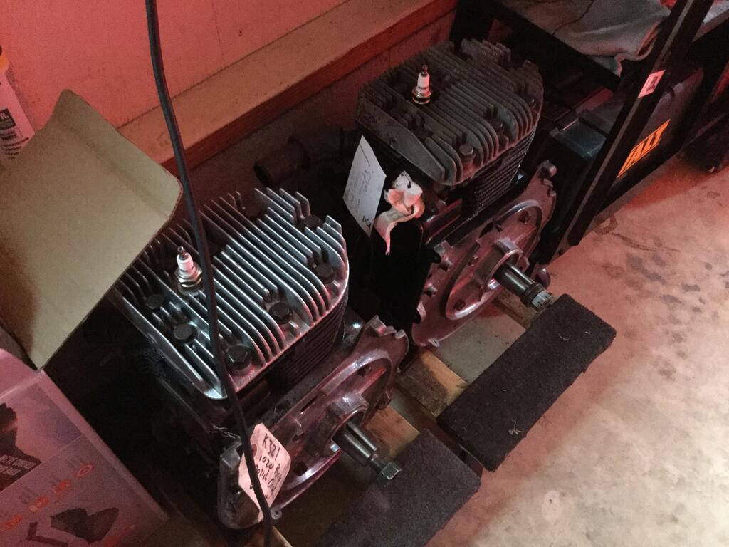

Mr Magoo 226 #44 Posted May 25, 2020 15 minutes ago, richmondred01 said: you should see if someone in your area sells rebuilt long blocks. This way you save buying the complete engine and you still get the satisfaction of using parts off your engine rather then trashing the whole tractor. just make sure the wheel horse spec with the correct length and diameter crank. The long blocks I have seen are in the $700-$800 range. Share this post Link to post Share on other sites
tom2p 2,396 #45 Posted May 25, 2020 junk tractor with a good engine (long block) might be a good option 3 Share this post Link to post Share on other sites
squonk 48,338 #46 Posted May 25, 2020 6 minutes ago, Mr Magoo said: The long blocks I have seen are in the $700-$800 range. You'll spend more than that rebuilding it correctly 2 Share this post Link to post Share on other sites
tunahead72 2,662 #47 Posted May 25, 2020 11 hours ago, richmondred01 said: ... the block is stamped.010 over ... 11 hours ago, Mr Magoo said: I noticed that too. I figured it was stamped .010 on the first rebuild. I don't have any experience rebuilding engines myself, but I have taken several Kohler heads off for inspection and cleaning. I've never seen a marking like that on the block, is Mr Magoo correct that this engine was probably also rebuilt earlier at .010" over? 1 Share this post Link to post Share on other sites
richmondred01 2,393 #48 Posted May 25, 2020 Most quality machine shops stamp the head and crank that have had work done. If previous work had been done they XX out the old and restamp with the new. 3 1 Share this post Link to post Share on other sites

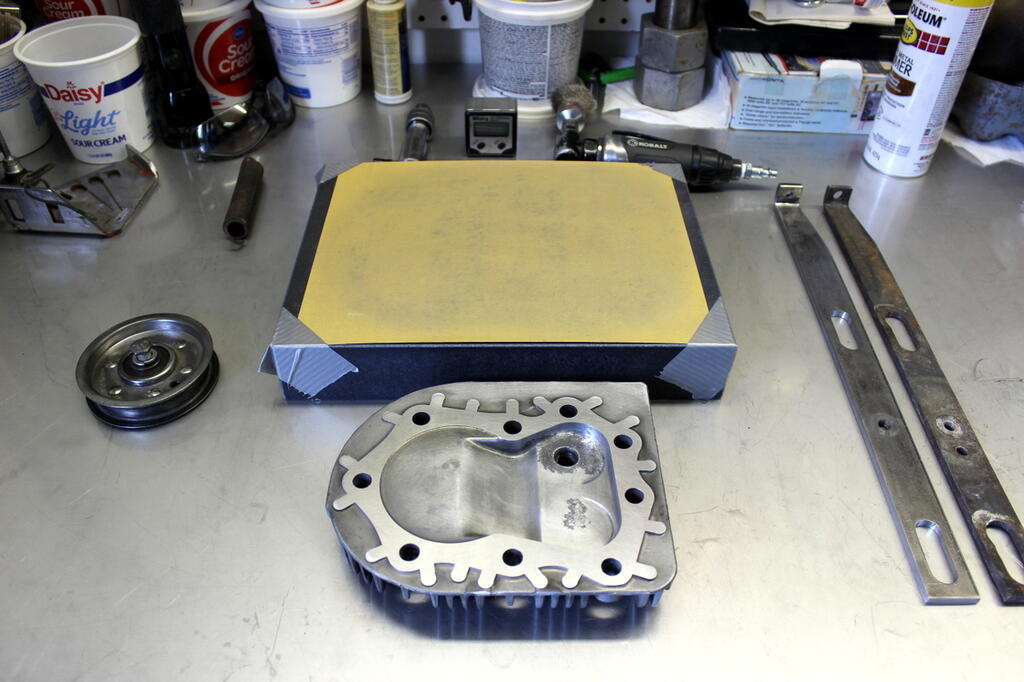

Mr Magoo 226 #49 Posted May 30, 2020 I cleaned up the head and will try and get it put on this weekend. I replaced all of the fuel lines, tank bushing, and shut off valve last weekend. The carb seems to be really clean and tight. I want to try and at least get it running for a little while to assess the transmission. If I have a problem there it will probably not fix the motor. 4 Share this post Link to post Share on other sites
tunahead72 2,662 #50 Posted May 30, 2020 Good luck, and keep us posted! What is that you used as the base for your sandpaper? Share this post Link to post Share on other sites
