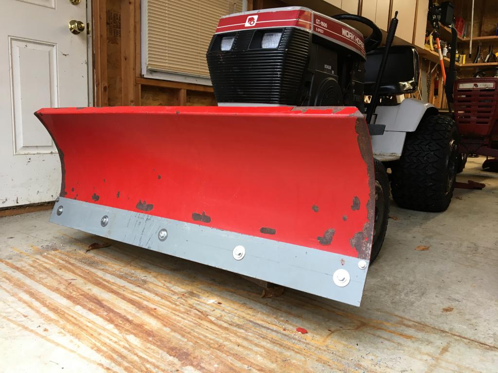

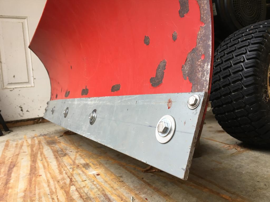

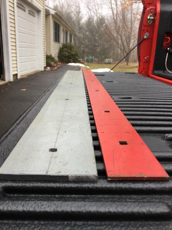

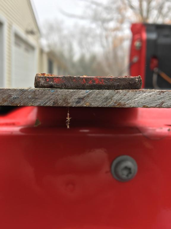

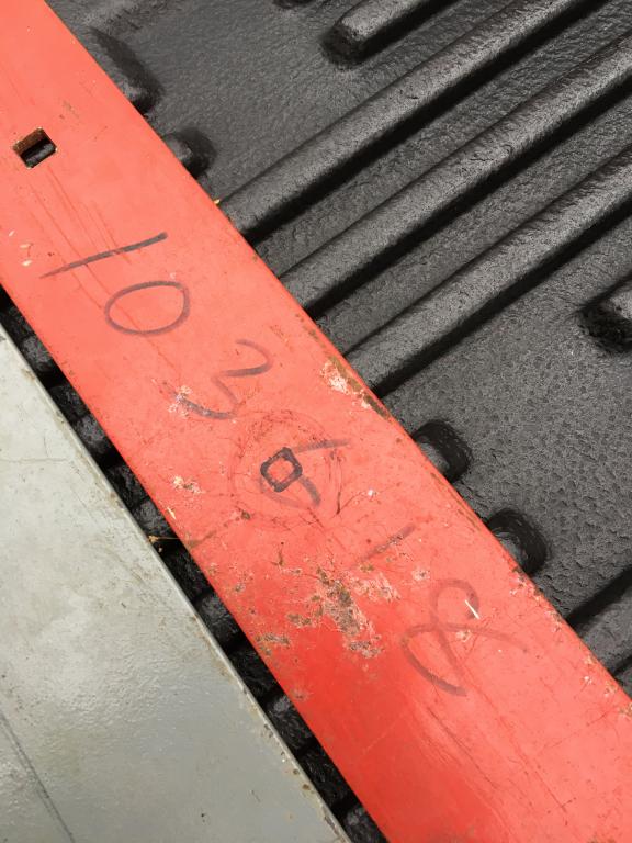

Sparky-(Admin) 25,474 #30 Posted February 1, 2020 On 1/30/2020 at 6:12 PM, Sparky said: I am torn about “wrecking” a brand new 56” plow edge. Will update this thread with how it goes. So I couldn’t bring myself to chop up and drill out this new old stock 56” plow edge. The little Wheel Horse guy in my head kept telling me to save it . Had this piece of scrap metal layin around my garage, it’s been here for years. I had no problem shortening it and drilling out 5 holes in it. Bought all new stainless hardware and it’s done ! No it’s not made of hardened steel or whatever the real ones are made of but it’ll keep me going for a few years before I need to flip it. 103618 is the part# off the plow edge I can’t bring myself to cut/drill. Picture 4 is the old 48” edge on top of new one, is definitely thicker. 4 2 Share this post Link to post Share on other sites
Cvans 1,009 #31 Posted February 1, 2020 You have two cutting edges there so it will last a long time. Just make sure to flip it over before it wears into the blade. 3 Share this post Link to post Share on other sites
Stormin 9,988 #32 Posted February 2, 2020 12 hours ago, Cvans said: You have two cutting edges there so it will last a long time. Just make sure to flip it over before it wears into the blade. When I built my plough/dozer blade that's all I did. Just two sections of flat bar. Didn't have a piece long enough for a full width one. 2 Share this post Link to post Share on other sites
