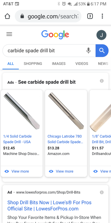

WVHillbilly520H 10,379 #25 Posted January 31, 2020 If I were to buy/use solid carbide drill bits I prefer spade bits over twist JMO working in a machine shop... https://www.regalcuttingtools.com/products/twist-drills/carbide-drill-bits ... Share this post Link to post Share on other sites
