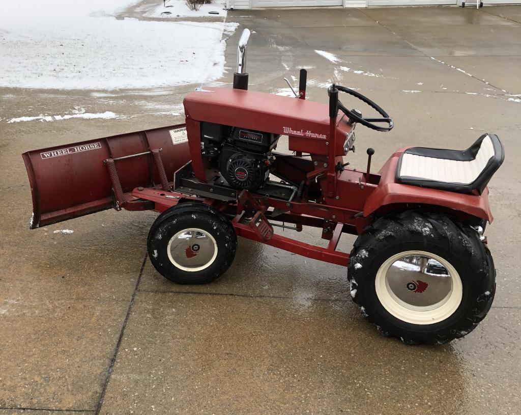

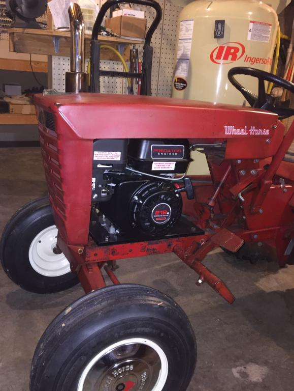

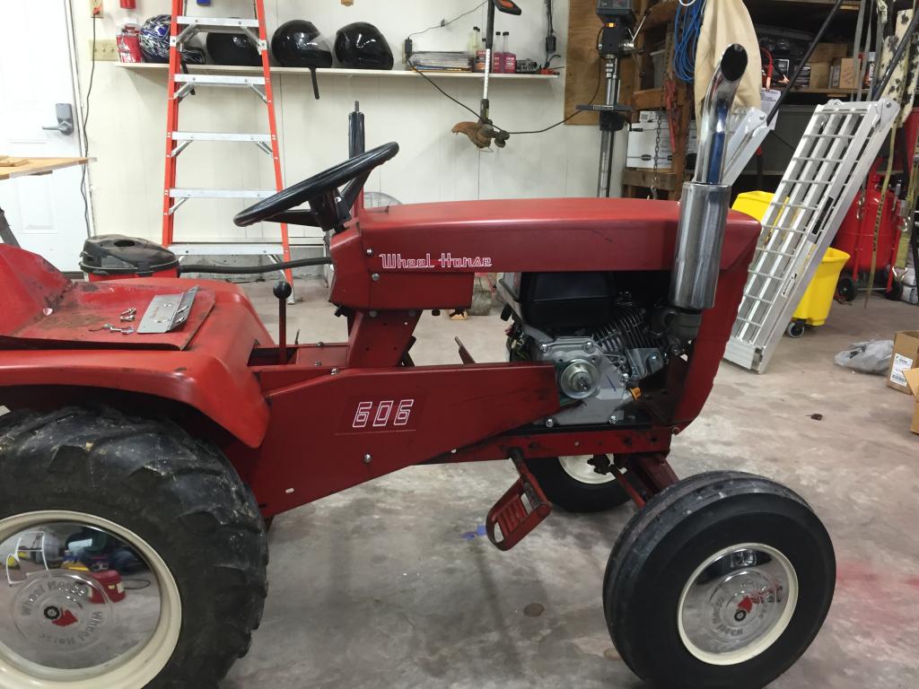

cschannuth 3,821 #22 Posted February 1, 2020 I have Briggs, Kohlers, and a hemi Predator and they are all great. I had a 606 roller and my Dad had a 212cc Predator sitting on a shelf he never got around to using. I had to spread the front of the hood a bit but no cutting was required. I’ve been using it for several years and it still starts on the first pull every time. And the power is amazing. I upsized the engine pulley so that it runs about 9 mph and it pulls trailers and pushes snow effortlessly. IMG_3971.MOV 2 1 Share this post Link to post Share on other sites

tom2p 2,394 #24 Posted February 1, 2020 (edited) 12 hours ago, cschannuth said: I have Briggs, Kohlers, and a hemi Predator and they are all great. I had a 606 roller and my Dad had a 212cc Predator sitting on a shelf he never got around to using. I had to spread the front of the hood a bit but no cutting was required. I’ve been using it for several years and it still starts on the first pull every time. And the power is amazing. I upsized the engine pulley so that it runs about 9 mph and it pulls trailers and pushes snow effortlessly. IMG_3971.MOV 45.67 MB · 0 downloads nice job - looks and sounds great and sweet looking Torino (?) - appears to be in original condition and very clean the tractor seat could use a tad more padding though lol Edited February 1, 2020 by tom2p Share this post Link to post Share on other sites
cschannuth 3,821 #25 Posted February 1, 2020 1 hour ago, tom2p said: nice job - looks and sounds great and sweet looking Torino (?) - appears to be in original condition and very clean the tractor seat could use a tad more padding though lol Ha ha, thanks. That was early on in the build process. I have a better seat on there now. 1 Share this post Link to post Share on other sites
