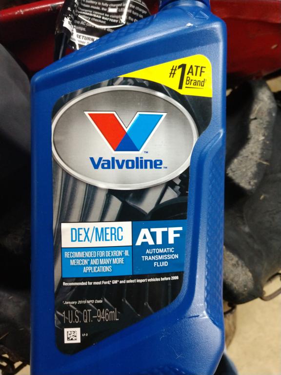

troutbum70 858 #1 Posted January 29, 2020 This is some ATF I have from a vehicle. Is this particular ATF ok to use in the electro 12 with the sundstrands? And yes it does have ATF in it now. A previous owner has labeling under the seat pan that states 5 quarts for hydro. When I do the drain, replace filter will it actually take 5 quarts? 5quarts seems like a lot. I know just rely on what the dipstick indicates. And is it best to check fluid level when cold or after warmed up and running? Share this post Link to post Share on other sites
oliver2-44 11,767 #2 Posted January 29, 2020 That ATF should be fine. My C-160 took a little less than 4 quarts when I changed it. Then I ran it around a while and it took another 1/2 quart. I used about 4.3 or so quarts. 1 Share this post Link to post Share on other sites
troutbum70 858 #3 Posted January 29, 2020 Ok I did not know if seals in it preferred something in particular. And ok on a little over 4 quarts on a filter fluid change. Thank you Oliver Share this post Link to post Share on other sites
