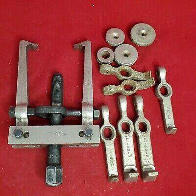

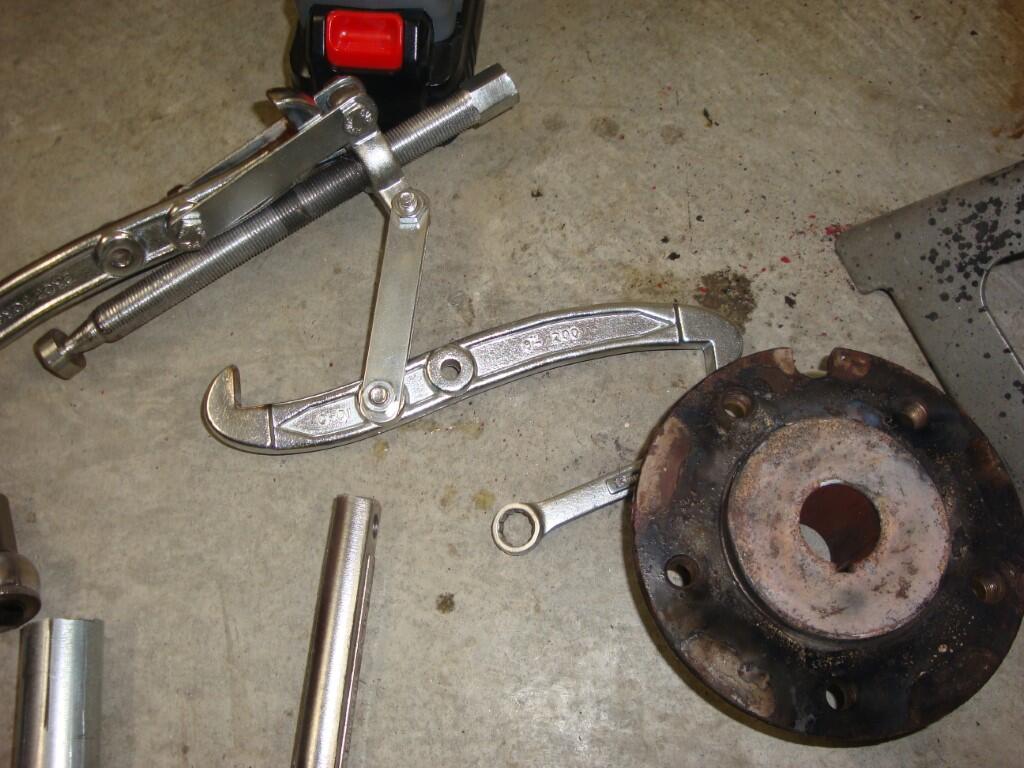

Zeek 2,299 #26 Posted January 18, 2021 On 1/8/2021 at 7:07 AM, 71_Bronco said: Wow, guess I was lucky with mine. I got mine off with one of those big 2-jaw pulley pullers (like the one below). Took a lot of PB Blaster, heat, and a big breaker bar on the puller, but it came off. Same here. Soaked it and used this HF gear puller set. Used the same to get the hubs off (with heat). 2 Share this post Link to post Share on other sites
