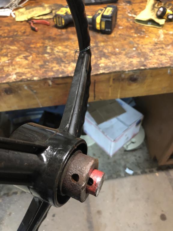

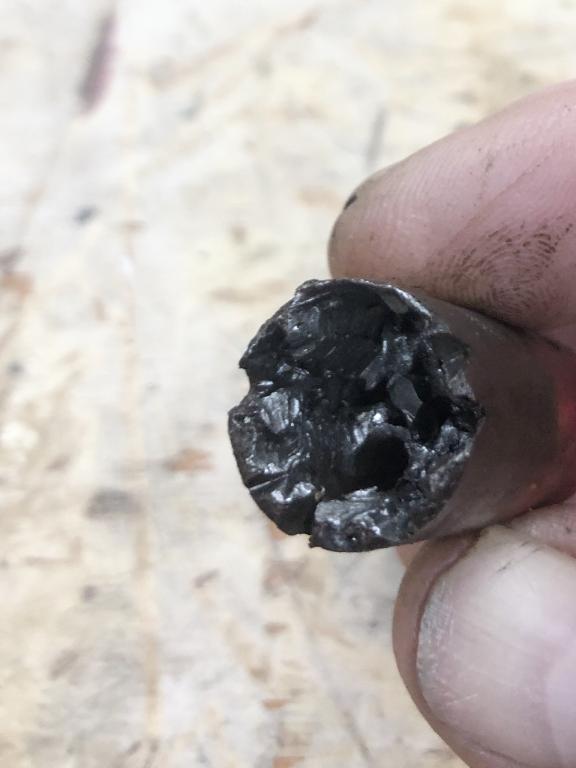

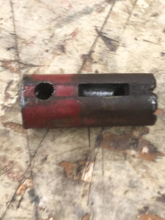

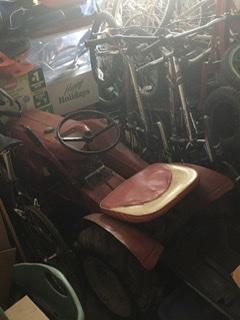

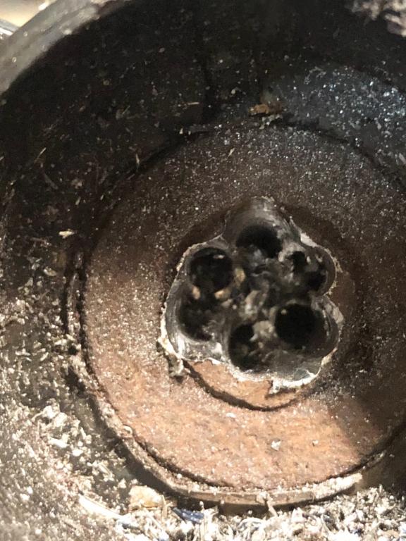

The Tuul Crib 7,354 #1 Posted January 27, 2020 So I've been soaking the steering wheel for the past two weeks and pounding on it and pounding on it with no progress. So today I started to get a little more aggressive and drill several holes in the end of the shaft and ended up cutting the shaft on the other end ! I saved the wheel!! The steering wheel shaft is only an inch and a half shorter but I can weld a new piece on the end of it. 4 Share this post Link to post Share on other sites

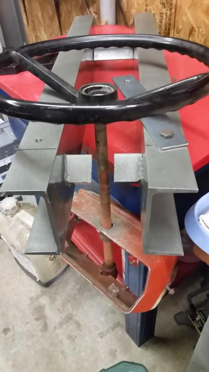

pfrederi 21,274 #8 Posted January 28, 2020 If they are really bad pull the whole unit with instrument panel. Then you can clamp it a vice with blocking under it and drive out the roll pin (use a real roll pin pin punch and soaking with your favorite bug juice). Never had to drill one.,. Then with emery cloth clean up the shaft below the steering wheel. Now stand it up in the vice with the gear end of the shaft against the vice throat. climb up on a step stool and use an deep well impact socket the clears the shaft put in on an wail away with a sledge hammer the steering wheel will eventually slide down the shaft. then clean up the end and pull it back off. 3 Share this post Link to post Share on other sites

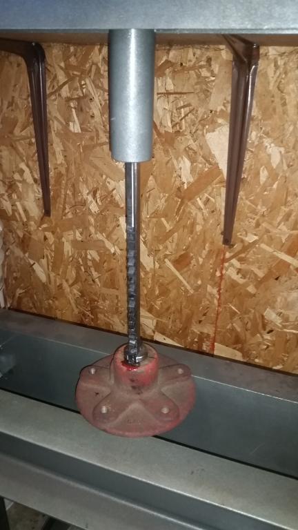

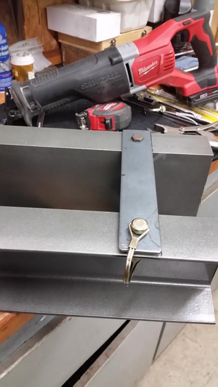

WHX?? 58,324 #10 Posted January 28, 2020 Did you not see my thread Cribs on modified HF press to get the whole dash in it? . Half the battle here like Dan said is getting the pin out. Particularly on the soft touch wheels. Difficult steering wheel removal is a thing of the past in my shop... on to hubs and hitch pins! 2 Share this post Link to post Share on other sites

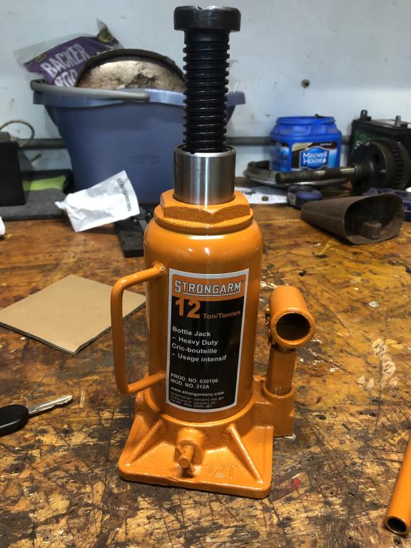

The Tuul Crib 7,354 #11 Posted January 28, 2020 19 minutes ago, WHX24 said: Did you not see my thread Cribs on modified HF press to get the whole dash in it? . Half the battle here like Dan said is getting the pin out. Particularly on the soft touch wheels. Difficult steering wheel removal is a thing of the past in my shop... on to hubs and hitch pins! Yes I did see this thread and I do remember. Kind of curious what did it end up costing you? I just picked up a 12 ton jack from one of these Prevost buses. they come with every bus that we build and they just pitch em . I could've used it on the steering wheel but maybe next time I'll have it set up! 1 Share this post Link to post Share on other sites
WHX?? 58,324 #12 Posted January 28, 2020 The press was heck I don't even remember but way less than 200 with coupon in hand....20 ton bottle jack...... the mod not a dang thing. Way best the thing I got for my shop in years considering wheels, hubs, pins, broaching, bearings.... don't know how I got along without it.... oh yeah I do pounding on stuff with Paul's BFH and ruining it somemore.... 2 1 Share this post Link to post Share on other sites

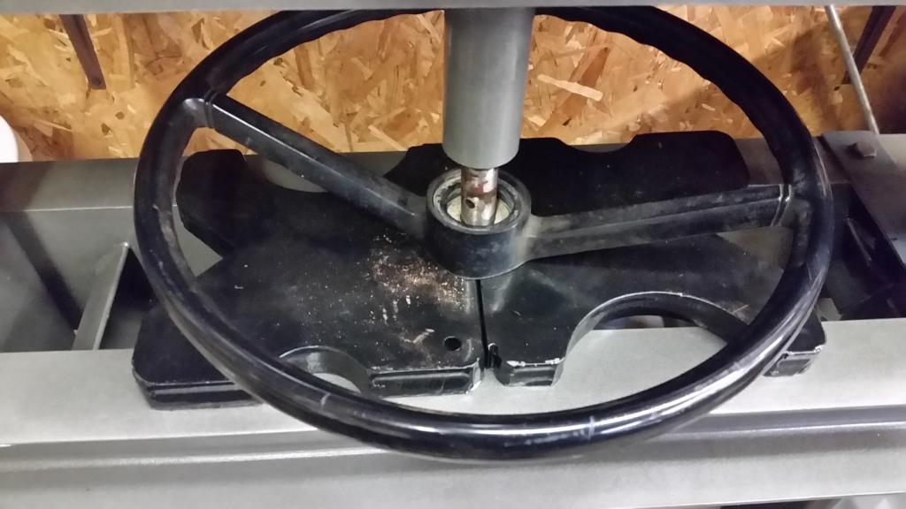

Damien Walker 297 #25 Posted January 18, 2021 After much fighting, I managed to get the roll pin out, but the shaft steadfastly refused to budge. As the centre cap was missing from the wheel, that gave me the idea of pushing it out in a press.... Drill through the plastic in the centre of the wheel, put in the press, supporting the boss from underneath and press out using a drift. There is no way it would have come out with any other method save for drilling out as The Tuul Crib describes. Using a puller is likely to damage the underside of the boss. 3 Share this post Link to post Share on other sites
