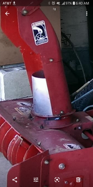

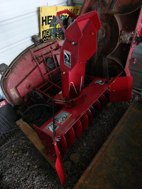

Ed Kennell 47,255 #4 Posted January 27, 2020 (edited) I believe the tall chute maintains a tighter column of snow at a higher velocity therefore being able to throw it further. This is due to the tall chute having a longer straight section before the deflector. Most tall chute owners also add a front section to create a full pipe section to keep a tighter pattern. Like a shotgun, a long barrel with a tight choke throws lead farther then a short open bore barrel. Of course the gear drive vs cable drive chute angle is a no brainer. Edited January 27, 2020 by Ed Kennell 2 3 Share this post Link to post Share on other sites

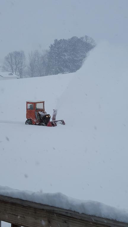

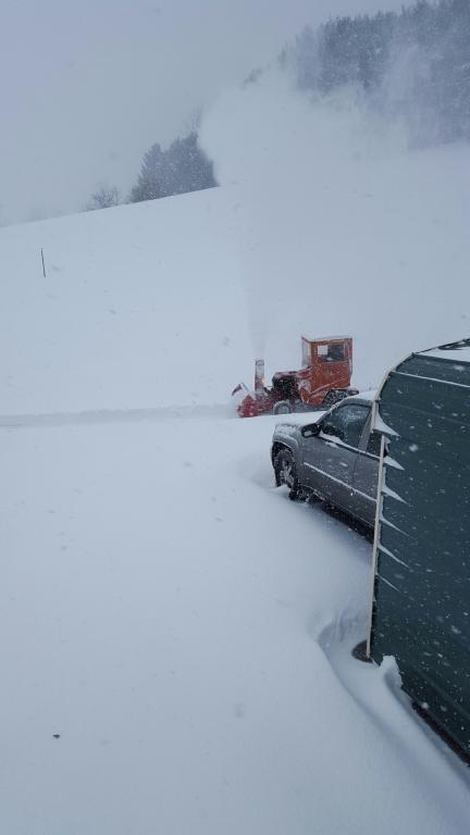

c-series don 12,421 #12 Posted February 2, 2020 Here’s one from a few years ago. Haven’t needed it yet this year at all! 1 Share this post Link to post Share on other sites
