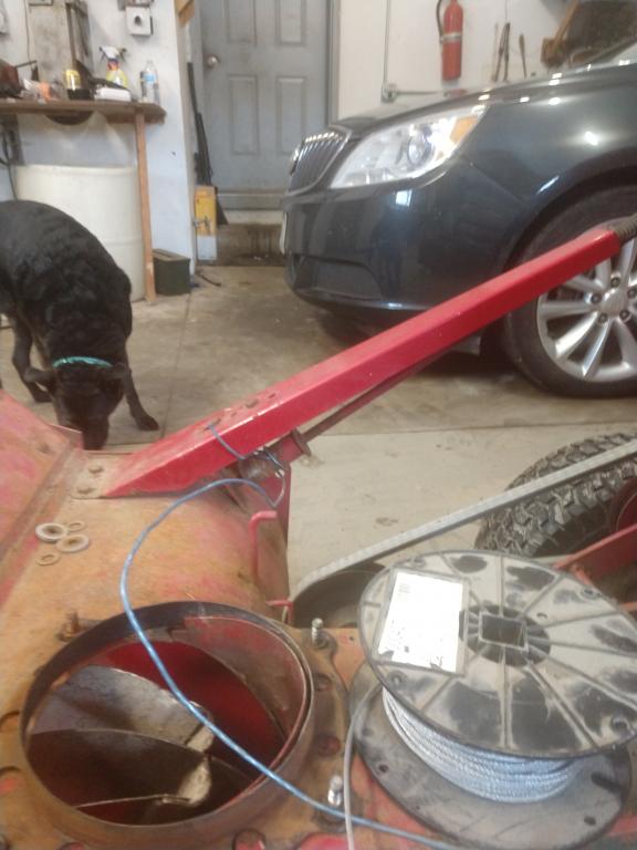

seven 202 #1 Posted January 26, 2020 Last year mine broke so I replaced it with a steel clothes line cable that had an outer sheild on it it finally broke also.im thinking now a plan 3/16 diameter steel cable any thoughts? Share this post Link to post Share on other sites
wallfish 20,680 #2 Posted January 26, 2020 Seems like something might be binding if they're breaking that quick. Try the galvanized wire rope, 3/16 might be a little thick but that's just for bending tight around the handle spool. Only way to know for sure is to try a piece and find out. The more strands it's made out of, the more flexible it is. Share this post Link to post Share on other sites
Ed Kennell 47,610 #3 Posted January 26, 2020 I agree with John, 0.187" dia. cable will be pretty stiff to stay wound on the spool. I've had some success using 0.105" dia string trimmer line. 1 Share this post Link to post Share on other sites
vanillaman 11 #4 Posted January 26, 2020 I tried 3/16 cable and found it too stiff to work with. I tried 1/16 cable that was very easy to wind on to the drum but it broke over time. I am now using 3/32 cable that wound on easily. I think that this will work for me. I found it at a salvage store for 10 cents per foot. I have an ample supply if needed. Dick 1 Share this post Link to post Share on other sites
peter lena 10,091 #5 Posted January 26, 2020 initially i used a grass trimmer line to route and get the right operation before going over to 1/8 " cable ,available at your local hardware store. another thing that i added to the base of the chute was electrical lugs , back to back to hold the cable in a very solid way , https://www.homedepot.com/p/2-to-14-Dual-Rated-Mechanical-Wire-Connector-with-Single-Conductor-Mount-10-Pieces-ADR2-B2-5/202207165?mtc=Shopping-VF-F_Vendor-G-D27E-27_11_TOOLS_And_ACCESSORIES-Generic-NA-Feed-PLA-NA-NA-TOOLS_ACCESSORIES&cm_mmc=Shopping-VF-F_Vendor-G-D27E-27_11_TOOLS_And_ACCESSORIES-Generic-NA-Feed-PLA-NA-NA-TOOLS_ACCESSORIES-71700000033101173-58700003868916496-92700048703499442&gclid=CjwKCAiAjrXxBRAPEiwAiM3DQuc84Y38nlZicuZA0Id3xuBpMT9kudKgJUhupmu8wZ4JMVxS-3MxMxoCCe4QAvD_BwE&gclsrc=aw.ds, drill out original cable clamps, use new1/4" hole to bolt back to back the lugs , very secure cable grip to swivel chute . that 1/8" cable is very strong , and easy to use, lubricate all friction points, pete Share this post Link to post Share on other sites
moe1965 774 #6 Posted January 28, 2020 I used a garage door cable. Works good Share this post Link to post Share on other sites
AHS 1,701 #7 Posted February 2, 2020 The original WH cable is very thin! And works good! I don’t know what the diameter is. Also, double crimp at the end; the stock crimps, and then another screw style crimp. Share this post Link to post Share on other sites
peter lena 10,091 #8 Posted February 2, 2020 i think a lot of the problem is lack of lubrication, rust and scale will make anything very hard to use and regularly bind up on itself. that is why i used the grass trimmer line to verify tracking and function. its easy slide and strength is ok for many units. those aluminum wire lugs using a 1/4 " bolt in place of the original pop rivet, mounted in oppose ways are the perfect solid pull point for chute rotation. i spent time at each problem or drag area,improving and increasing function . i also added a smooth round screw on ball end on the chute rod, works very well with mittens , easy die nut thread cutting , make it as smooth as you want, pete Share this post Link to post Share on other sites
