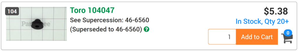

Lman 14 #24 Posted October 23, 2022 On 4/29/2021 at 2:50 PM, 6wheeler said: The valve and grommet are both available from Toro #'s are 104048 and 104047. I found the numbers on the TORO MPV. Then? I had to go through my local dealer. Unfortunately? Toro decided not to sell to private parties any more. I just look up the parts. Then? Call my dealer. Saves time. I got a Toro 104047 bushing from the local mower shop but I'm wondering whether I was sold a dud. It's been superseded to part # 46-6560. I felt it went into the tank far too easily and yes, it leaks. When they went hunting for it in inventory, I noticed it was the last one in the bag, rubber had gone a bit white but that did clean off. Maybe I ought to take it back, but they seem to have a policy not to take back spare parts. I tried to use silicone sealant, big mistake of course, petrol ate right through that. Share this post Link to post Share on other sites
