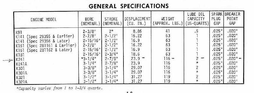

bottjernat1 2,196 #11 Posted January 24, 2020 What acho says but i believe the gap is .020 Share this post Link to post Share on other sites
bottjernat1 2,196 #12 Posted January 24, 2020 Here is the gap cart it is the same for most of the old kohlers. I even set my old 16hp onan on the sear i use to own at that. 1 Share this post Link to post Share on other sites
wallfish 20,231 #13 Posted January 24, 2020 Points gap seems to be very touchy on K91s compared to other size engines. Don't get stuck on that .020 setting. What Dan @Achto is referring to is the .002 change he made to the gap by doing a static timing procedure and not the initial setting of .020. Very very slight changes to the gap on these K90-91 engines can make a big difference. I've had some which are clearly more sensitive to it than others so it's a good place to start. 2 2 Share this post Link to post Share on other sites
Achto 32,117 #14 Posted January 24, 2020 6 minutes ago, wallfish said: Very very slight changes to the gap on these K90-91 engines can make a big difference Thanks John, I guess I should've explained myself better. At .020" points gap my K91 was a PITA to get started, didn't matter if it was warm or cold. After setting them using the static timing method the points gap ended up at .022". Now most of the time it only takes one pull to get it started, warm or cold. 1 Share this post Link to post Share on other sites
wallfish 20,231 #15 Posted January 24, 2020 Have ended up at .018 too 2 Share this post Link to post Share on other sites
