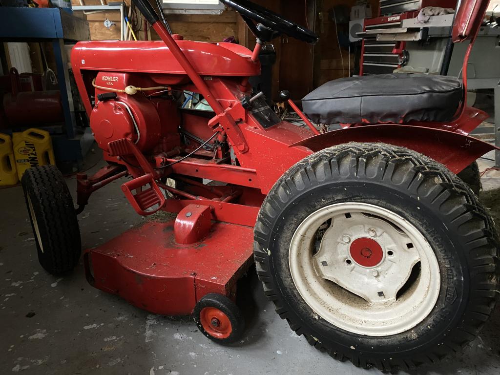

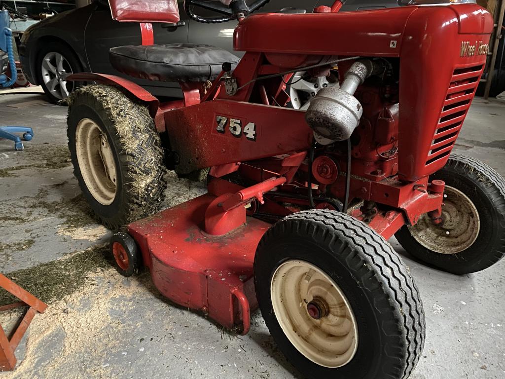

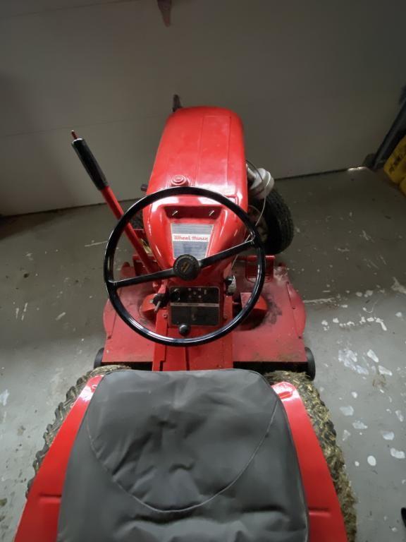

Barney22 8 #1 Posted January 23, 2020 Would anyone be able to tell me the year and model of this one? Thanks! 3 2 Share this post Link to post Share on other sites

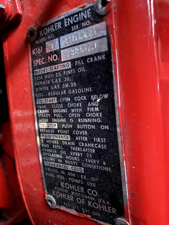

Sparky-(Admin) 24,628 #3 Posted January 24, 2020 If that decal is correct it’s a model 754. That equates to 7 HP, electric start and made in 1964. But it’s a pull start Kohler so.... Share this post Link to post Share on other sites

wallfish 19,291 #5 Posted January 24, 2020 It's not a 754. I'm guessing someone transplanted that 7 hp Kohler engine into a 604 or 654. 3 Share this post Link to post Share on other sites

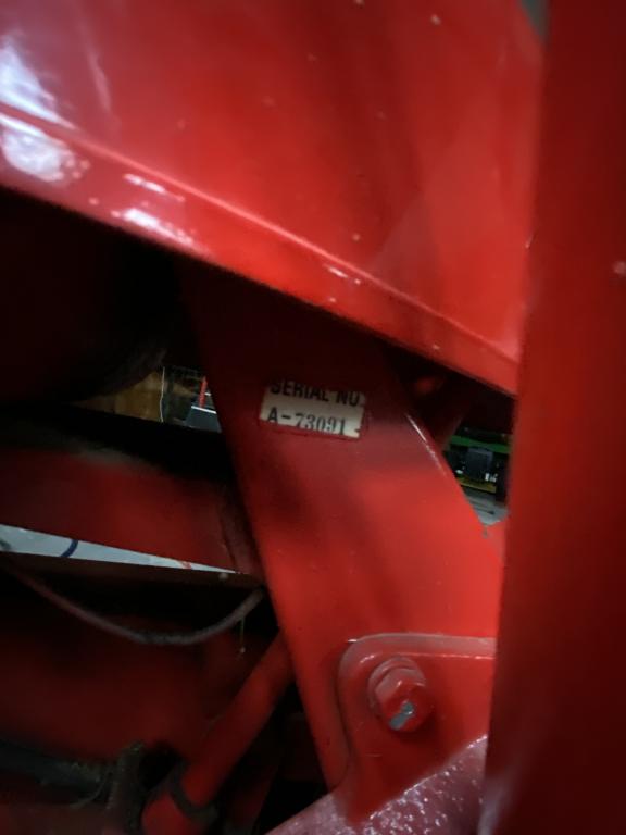

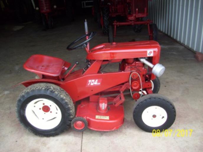

gwest_ca-(File Mod) 12,000 #6 Posted January 24, 2020 A-73091 is a left over serial sticker from a 1962-63 attachment. Some showed up on early 1964 models but none of the 754 have revealed any of them. Engine was used on the 704. Click on the picture Garry 1 Share this post Link to post Share on other sites
oliver2-44 11,212 #7 Posted January 24, 2020 (edited) Looks like you found yourself a great tractor. On a 50-60 year old tractor its common to find a few parts from other years. The Kohler engine serial number beginning with a "C" make the engine a 1967. The spec number comes up as a "Wheelhorse 7hp spec#. So a dealer could have changed the engine out a few years later. Wasn't this "Sloped Dash and hood design at the steering wheel only used on the 603? PS That seat back rest is a nice unique item. While not rare, their not common either. Edited January 24, 2020 by oliver2-44 2 Share this post Link to post Share on other sites
WHNJ701 4,169 #8 Posted January 24, 2020 (edited) are they really tiny emblem stickers on the hood? nice looking, looks like it was kept well over the years. maybe check the belt guard if the original numbers were painted over? Edited January 24, 2020 by jabelman 1 Share this post Link to post Share on other sites
Achto 30,997 #9 Posted January 24, 2020 (edited) 1 hour ago, oliver2-44 said: Wasn't this "Sloped Dash and hood design at the steering wheel only used on the 603? This design was also used on a 704. If it was a 603, some one installed the wrong steering wheel and added fenders. A pic of a 603. A 704 Edited January 24, 2020 by Achto 3 1 Share this post Link to post Share on other sites
WHX?? 54,973 #10 Posted January 24, 2020 Barney.... I'm with the others on a mislabeled 604 with a replacement engine but does not matter... still a nice lookin survivor and appearance tells somebody in the past has loved it. 1 Share this post Link to post Share on other sites

wallfish 19,291 #12 Posted January 24, 2020 but not so sure it's been modified. I forgot about the 704 and that appears to me exactly what it is, Garry and Dan nailed it. A 1964 704. The engine spec may confirm this. Either way the the 604, 654, 704 tractors would've basically been the same tractor except with minor differences and different engines 2 1 Share this post Link to post Share on other sites
WHX?? 54,973 #13 Posted January 24, 2020 (edited) 16 hours ago, oliver2-44 said: The Kohler engine serial number beginning with a "C" make the engine a 1967. The spec number comes up as a "Wheelhorse 7hp spec#. So a dealer could have changed the engine out a few years later. Thinkin you may be on to something there Jim. Maybe a 604 with a finicky Tecky ….. PO suffered a rotator cuff injury from yanking on a dead Tecky and just told a dealer to put the Kohler in? I forgot about the 654 so maybe that with a sour Tecky hence the 754 custom label?? This is all just speculation Barney but it keeps us occupied! Chances are one may never know the true model but as Richard said fun factor! Edited January 24, 2020 by WHX24 1 1 Share this post Link to post Share on other sites

Barney22 8 #16 Posted January 24, 2020 Thank you all for your expertise.its been in the family for Forty six years.What puzzles me is why my dad put 754 on it when he repainted it about 40 years ago.Back then before the internet I don’t know if he would have known the different models.The only thing I can think of is when We bought it there were two tractors there.This one and one that was rusted badly (Electric start)maybe the other one had 754 on it..Good stuff guys and thanks again! Share this post Link to post Share on other sites
