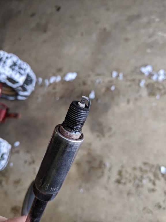

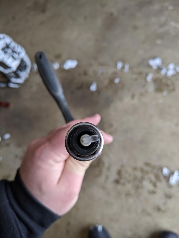

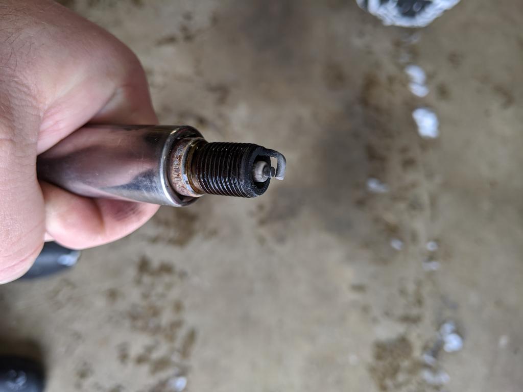

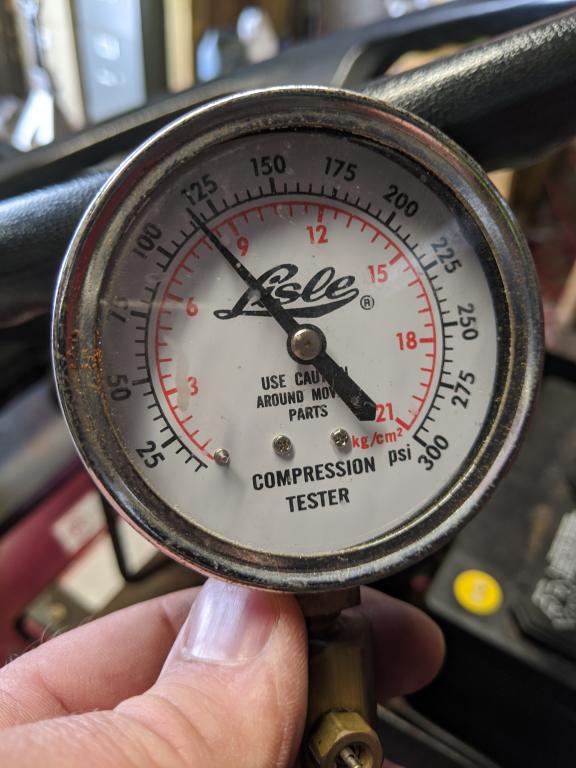

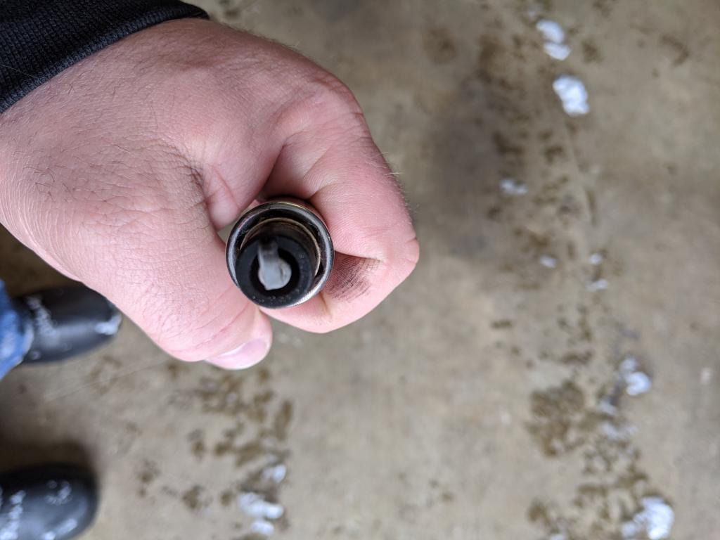

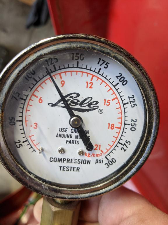

WildmanC120 613 #24 Posted February 8, 2020 OK, Had a few minutes today to look at this. I fired her up and did the spray test. Didn't notice anything with that. Found that if I close the choke flap a little on the carb that it would fix the issue with still leads me to believe its a fuel problem. I also removed the plugs and performed a compression check. Engine looks and sounds very healthy to me. I'm not sure I need to do a valve adjustment at this time. It might just complicate things honestly. The first 3 photos below are of the rear cylinder and the last 3 photos are front cylinder. P216 Running Share this post Link to post Share on other sites
lynnmor 8,844 #25 Posted February 8, 2020 The vacuum port in the intake next to the carb appears to be OK and closed, just make sure it is not drilled thru. There is a welch plug next to the idle mixture screw, make sure it is there and sealed. Make sure that you didn't use E15 or E85 fuel. The spray you are using evaporates so fast that the test may not be valid, try again with some oily spray or just plain oil. Are you using the correct Champion spark plugs? That black/white contrast is extreme. A valve that has near zero clearance will show an excellent compression test, but the clearance will quickly go away with just a little warm up. It sure does seem like it is sucking air. Share this post Link to post Share on other sites
