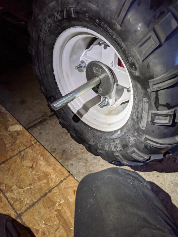

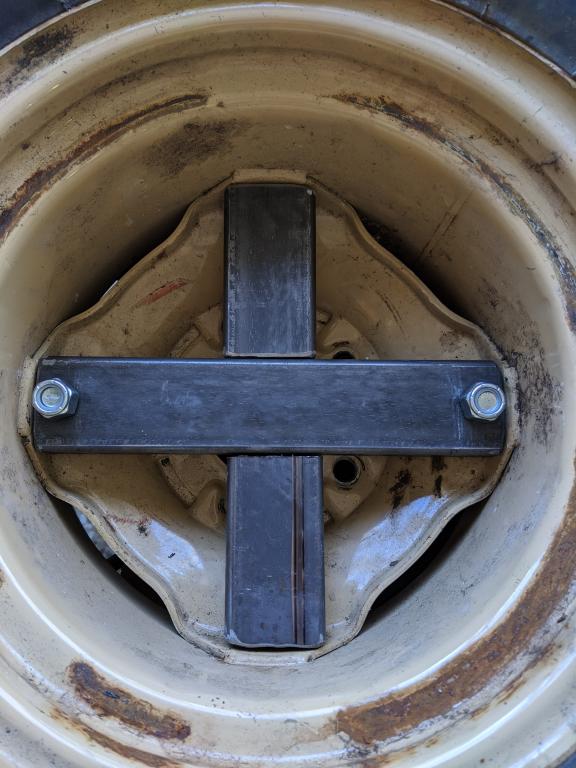

wheelwhores 107 #113 Posted February 17, 2020 so here is what the brackets look like on the rears and a picture of it while i was fabricating everything, with the 11" bolt I was able to hang and additional 5, 10, 10, 25, 50, and 10 on each wheel, that paired with 8.5 gallons or rimguard 8ish gallons of rimguard at 88lbs puts me just under 200lbs per tire of additional weight. I have the fronts off now for paint and will be new turf tires ordered this week to start in on that project. At first glance there isn't a lot of room to hang weight inside the rim as the valve stems are in the way....anyone know if the typical front rims are steel or aluminum? If they are steel i may just weld closed the old stem holes and flip em to the other side of the rim. O a side note glad i had time to take the tires off as my steering linkage had a lot of loose goose connections all down the line. 1 Share this post Link to post Share on other sites
ebinmaine 80,600 #114 Posted February 17, 2020 1 hour ago, wheelwhores said: typical front rims are steel All the 60s and 70s rims I have here are steel Share this post Link to post Share on other sites
wheelwhores 107 #115 Posted February 18, 2020 16 hours ago, ebinmaine said: All the 60s and 70s rims I have here are steel i have to imagine that given aluminum of softer and more expensive from a production side most companies would opt to go steel, but ya never know. Share this post Link to post Share on other sites
