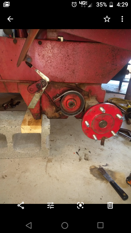

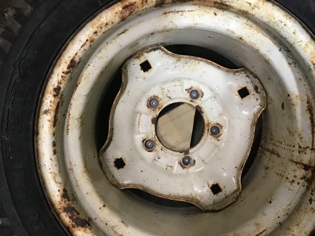

8ntruck 9,386 #77 Posted February 6, 2020 On 2/3/2020 at 11:24 PM, bcgold said: My reversible rim has a bolt pattern to suit the side being used. BCGOLD - I'd like to see a picture of the bolt circle from the other side, if you ever have an occasion to take one off of the tractor. It will be interesting to see what sort of mount pad arrangement is on the or her side. Share this post Link to post Share on other sites
bc.gold 3,406 #78 Posted February 6, 2020 (edited) 2 hours ago, 8ntruck said: BCGOLD - I'd like to see a picture of the bolt circle from the other side, if you ever have an occasion to take one off of the tractor. It will be interesting to see what sort of mount pad arrangement is on the or her side. The center came from a damaged implement rim that I found at the landfill metal pile. The dual use bolt pattern throw me for a loop when it came time to weld in the center I had to look at the other wheel on the tractor to make sure I was installing the right side facing out. The nice part, did not have to remove the liquid fill or the tire to make this repair. This Allis 720 has the wide boots on the rear with what looks to be a wide turf on the front, compared to the Simplicity which has Ag's on the rear much better traction and the tri-rib farm style tires up from make steering super easy. Even with that heavy snow thrower mounted on the front just the palm of my hand on the rim of the steering wheel is all it takes to steer the tractor. Previous owners can be a bit dense, trying to fit another Onan different model, they cut a huge chunk out of the front axle and still could not make the engine fit. And the old engine laid bare to the elements was going to be an expensive rebuild. Two years later I had found a decent running CCKB Onan, first year blowing snow fell in love with the Simplicity 9020 but always had it in the back of my mind that torch job. Then this Allis Chalmers 720 becomes available, blown hydro and the price was very reasonable, now that I've had a chance to use both tractors and now know what items and parts will make up the best package. The Simplicity becomes a parts donor. If the weather keeps warming up as it has been, you'll soon have your pictures of the other side of that rim. Edited February 6, 2020 by bcgold Share this post Link to post Share on other sites

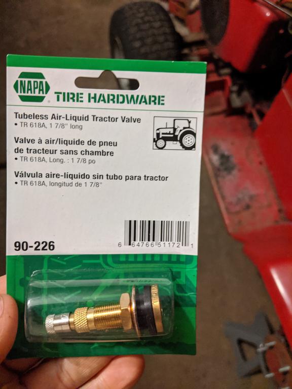

wheelwhores 107 #79 Posted February 7, 2020 Here is an update. The juice is flowing. 24 gallons of rimguard cost me about $90. (5)-5gallon buckets we free from a buddy who sells paint for SW. Here are the other parts which totaled around $23. I basically put the same tuben inside the large one, then weighted one end and dropped into a full bucket raised up high, taking car to keep the smaller tube our of the RG so air could move out of it. Then it was a strong suck on the tube and a quick clamp on tube once the siphon started. Little tube was passed inside the valve stem with the core out, and the large tube went over top of the threads with a hose clamp to seal it. Clamp off and about 3 hours later one tire is filled. Almost no mess, cheap and very effective...albeit slow. Spent the down time welding up and grinder some rear weight brackets which I will post this weekend after paint. 2 1 Share this post Link to post Share on other sites
wheelwhores 107 #80 Posted February 10, 2020 one of the two plow bracket that ties the a frame to the axle rotated open and dropped the plow down enough to wiggle free the other connection point while plowing, i didn't notice it until it was too late! , the a frame pushed back into the tire rim shearing off one of the brass valve stems spraying about a half to a full gallon of rim guard all over the tractor, house, and driveway......ugh. fortunately some quick action and a spare stem saved the day and i was able to get the tire off, emptied or rim guard enough to bread bead in a spot and get the new valve stem in and get the driveway done the same day. We had just gotten 6-8" of snow and i was so excited to try the weighted tires out that the only thing i can thing may have happened is that i hit one of the a-frame releases with the floor jack while installing the tires. It depressed the **** out of me for a couple of hours, but in the long run all was well....no major damage. That timre was refilled last night and will go on this evening. On a side note, if anyone wants to do rimguard in the twin cities (MN) metro area, either themselves or pay me to do it PM me, i have a good setup that takes a while to work, but does the job pretty cleanly and with no moving parts, just buckets and hose. 1 Share this post Link to post Share on other sites

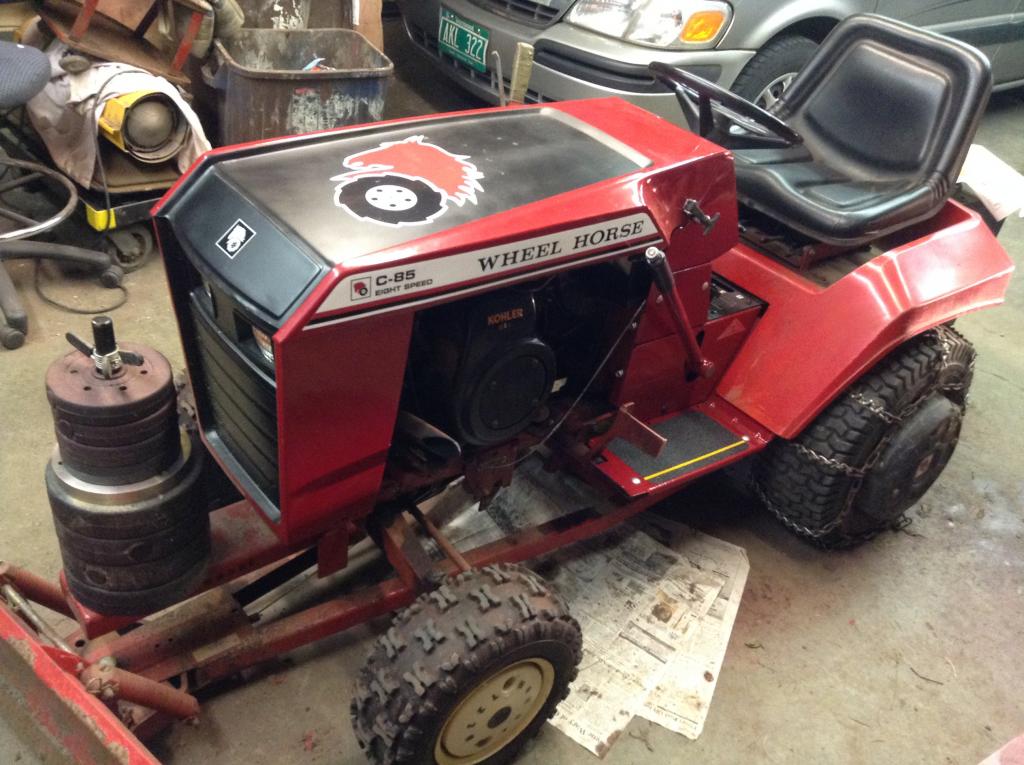

C-85 829 #84 Posted February 10, 2020 This is what I did for weight and now this little 8hp tractor is nearly like a bulldozer! We put so much weight on the back I had to add some to the front too! C-85 1 1 Share this post Link to post Share on other sites

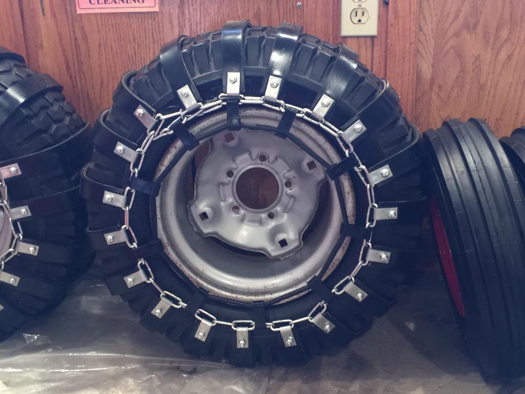

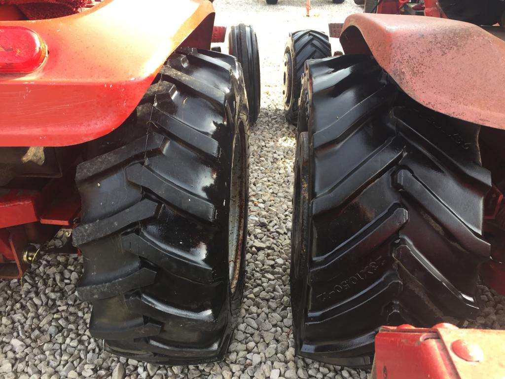

GlenPettit 1,719 #95 Posted February 11, 2020 (edited) A couple of suggestion here: 1. Best to add weight on the axle, least stress one the bearings. Weight added beind the rear axle will tend to act like a titter-todder, lifting the front end slightly, and the blade it-self unless, you have weight on the front end too. 2. IMO; weight inside the tire, like RimGuared is the best way to go, 'low & close to tractor'. 3. Rubber chains are very safe, no damage, 2- link will give a very smooth ride. but $$$ 4. An engine block pad heater will make starting much easier on those 0º mornings. 5. Early in the morning before any sun comes out, the snow is very dry and light; for me it's well worth getting out at 5am for clear snow. 6. A trickle-charger will keep the battery at 12-13 volts which is what it takes to start on a very cold day. (I'm in Michigan and love it). 7. Wire all 110v extra plugs to just one plug so it's easy to unplug once the tractor is started, consider allowing for using with warm gloves. 8. I'm near a busy highway and allowed for extra HF magnetic lights. 9. (I wished there was a back blade available with sides to pull snow away from a garage door). 10. A heated car seat pad is very easy to install and really helps to make plowing more comfortable. Left: regular Carlisle Lugs Right: Firestone 23º Lugs Edited February 11, 2020 by GlenPettit 2 Share this post Link to post Share on other sites
ebinmaine 81,150 #96 Posted February 11, 2020 6 hours ago, GlenPettit said: Left: regular Carlisle Lugs Right: Firestone 23º Lugs That may be reversed. The right side tire looks my Carlisle. LOVE the seat warmer idea. Can a car type 12v one be used? Share this post Link to post Share on other sites

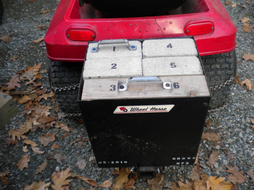

wheelwhores 107 #97 Posted February 12, 2020 So this weekend i think i am going to give Eric's roller chain idea a try. The 100 or so pounds of weight I currently have on the hitch tongue is going to come of and get hung on the custom rear wheel brackets i made. i'm really interested to see if just removing weight from that position which i think you guys are correct is actually taking weight off the fronts AND dong the roller chain idea will improve my steering traction a substantial amount. The next thing after that is a new set of turfs in the front with rim guard and wheel weight brackets like i have in the rear. 2 Share this post Link to post Share on other sites
