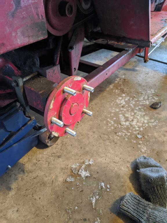

wheelwhores 107 #52 Posted January 30, 2020 I couldn't wait. Got off work and needed to wrench on something. 1 1 Share this post Link to post Share on other sites

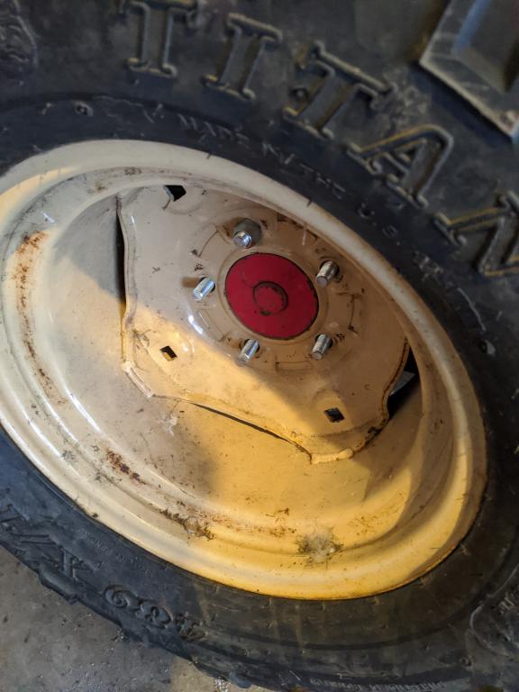

wheelwhores 107 #53 Posted January 30, 2020 Any reason I can't fill the rims around so the deeper dish is on the outside so I can load more weights in there?...as opposed to buying the spendy inner wheel weights? Share this post Link to post Share on other sites

ebinmaine 80,600 #56 Posted January 30, 2020 3 minutes ago, wheelwhores said: Any reason I can't fill the rims around so the deeper dish is on the outside so I can load more weights in there?...as opposed to buying the spendy inner wheel weights? I hope others say it's okay to run rims backwards because I definitely have tractors set up that way. For exactly that same reason. Wheels haven't fallen off yet so..... Share this post Link to post Share on other sites
8ntruck 9,278 #57 Posted January 31, 2020 (edited) I retired after 40 years as an engineer in the automotive steel wheel industry. My assignments ranged from product design to process engineering and tooling engineering. The 60 degree angle in the bolt holes and matching 60 degree angle on the lug nuts are there to help prevent the lug nuts from coming loose. The face of the wheel that mounts to the hub is also slightly concave towards the center hole. This helps distribute the load properly into the wheel and to keep the lug nuts tight. Wheels designed for dual use are reversible. They can be mounted either side out. Wheels designed for single use are not reversable. You can mount a wheel 'back side out', BUT IT IS NOT RECCOMMED. Doing this leaves you open to lug nuts coming loose and a very good possibility that the wheel will develop a crack. Edited January 31, 2020 by 8ntruck 1 Share this post Link to post Share on other sites
ebinmaine 80,600 #58 Posted January 31, 2020 3 hours ago, 8ntruck said: I retired after 40 years as an engineer in the automotive steel wheel industry. My assignments ranged from product design to process engineering and tooling engineering. The 60 degree angle in the bolt holes and matching 60 degree angle on the lug nuts are there to help prevent the lug nuts from coming loose. The face of the wheel that mounts to the hub is also slightly concave towards the center hole. This helps distribute the load properly into the wheel and to keep the lug nuts tight. Wheels designed for dual use are reversible. They can be mounted either side out. Wheels designed for single use are not reversable. You can mount a wheel 'back side out', BUT IT IS NOT RECCOMMED. Doing this leaves you open to lug nuts coming loose and a very good possibility that the wheel will develop a crack. Now that you mention it the ones I have may be reversible. I have seats for lugs that are slightly concave on both sides. Share this post Link to post Share on other sites
wheelwhores 107 #59 Posted January 31, 2020 9 hours ago, 8ntruck said: I retired after 40 years as an engineer in the automotive steel wheel industry. My assignments ranged from product design to process engineering and tooling engineering. The 60 degree angle in the bolt holes and matching 60 degree angle on the lug nuts are there to help prevent the lug nuts from coming loose. The face of the wheel that mounts to the hub is also slightly concave towards the center hole. This helps distribute the load properly into the wheel and to keep the lug nuts tight. Wheels designed for dual use are reversible. They can be mounted either side out. Wheels designed for single use are not reversable. You can mount a wheel 'back side out', BUT IT IS NOT RECCOMMED. Doing this leaves you open to lug nuts coming loose and a very good possibility that the wheel will develop a crack. again, this forum is awesome...i get an answer to any question in less than a day. You guys are the best! 2 Share this post Link to post Share on other sites

8ntruck 9,278 #65 Posted February 1, 2020 16 hours ago, ebinmaine said: Now that you mention it the ones I have may be reversible. I have seats for lugs that are slightly concave on both sides. Yup. If the wheels have countersunk bolt holes on both sides, they are intended to be reversible. Share this post Link to post Share on other sites

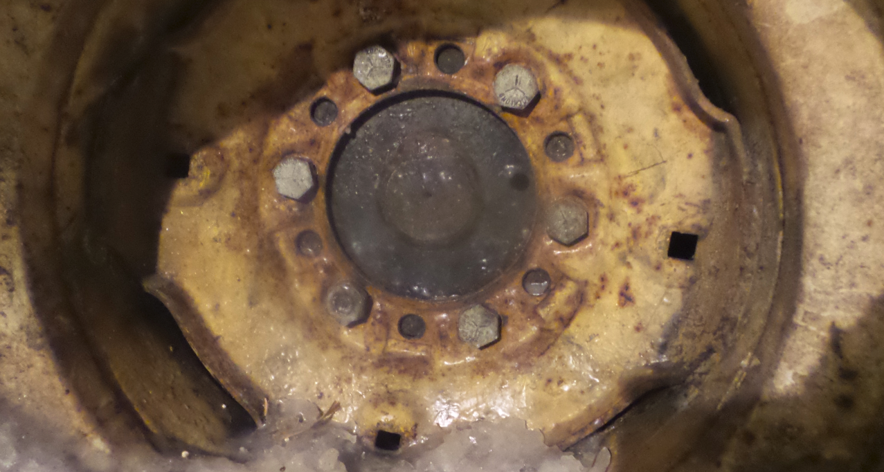

bc.gold 3,406 #74 Posted February 4, 2020 (edited) On 1/31/2020 at 3:25 AM, ebinmaine said: Now that you mention it the ones I have may be reversible. I have seats for lugs that are slightly concave on both sides. My reversible rim has a bolt pattern to suit the side being used. Edited February 4, 2020 by bcgold 3 Share this post Link to post Share on other sites
ebinmaine 80,600 #75 Posted February 4, 2020 3 hours ago, bcgold said: My reversible rim has a bolt pattern to suit the side being used. Now there's a neat idea..... 1 Share this post Link to post Share on other sites
