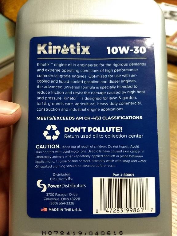

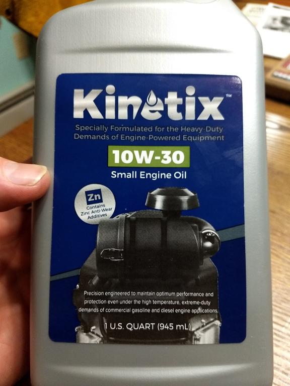

ebinmaine 80,777 #1 Posted January 22, 2020 I was at a small engine repair shop today and asked them what they are doing for oil in the older equipment. They've been using this name brand of Kinetix. Online price $4.29 a quart, give or take. Heard of it? Thoughts? Comments? Anyone have any experience with it? Share this post Link to post Share on other sites

953 nut 69,577 #5 Posted January 22, 2020 9 hours ago, ebinmaine said: They've been using this name brand of Kinetix. Online price $4.29 a quart, give or take. Heard of it? Thoughts? Comments? Don't have any experience with this brand. My thought is that many businesses sell products that are labeled as being superior to other similar products because the profit margin is greater. While it probably is a perfectly good lubricant I doubt that it is any better than any other high zinc oil. Share this post Link to post Share on other sites
ebinmaine 80,777 #6 Posted January 22, 2020 26 minutes ago, 953 nut said: Don't have any experience with this brand. My thought is that many businesses sell products that are labeled as being superior to other similar products because the profit margin is greater. While it probably is a perfectly good lubricant I doubt that it is any better than any other high zinc oil. I'm not really so much concerned with it being better than another oil as long as it isn't worse. Perhaps I am missing something in my searching but I have not been able to find ANY high zinc content oils for less than $6 to $9 a quart. I can buy this stuff off the shelf at $5 per quart and as listed above, less expensive. Share this post Link to post Share on other sites
bottjernat1 2,197 #7 Posted January 22, 2020 I have heard it is good oil i have never tried it tho. Check out there web page lots of interesting stuff! https://www.kinetix-products.com/ I have been trying to find more info on the brand it is not easy to find info on this oil. LOL but everything i have found is good! Share this post Link to post Share on other sites
gwest_ca-(File Mod) 12,489 #8 Posted January 22, 2020 The API classification CH and SJ is what you need to look for. C = compression = diesel class H S = spark = gasoline class J Garry 2 3 Share this post Link to post Share on other sites
lynnmor 9,042 #9 Posted January 22, 2020 Might be a good oil, at least they understand that zinc should be in it. The shop nearest my house sells a lot of mowers and carries the oil, just not my favorite place to do business. I see Amazon sells the oil and of course the price is double, but wait, the shipping is "free". Thanks for the information, I wasn't aware of that oil. 1 Share this post Link to post Share on other sites

bds1984 1,519 #13 Posted January 23, 2020 I'd am curious to see what the VOA is on this stuff. My money is that this oil is playing marketing games more than anything. Too many people are hung up on zinc content, when in fact that too high of zinc is corrosive, and for many engines is not necessary. Any 40 grade oil will have higher zinc than 30 or 20, Eric, so if you want to spend less money, just run an API rated 10w40 gas or 5/15W40 diesel oil. For a Wheel Horse engine, it is insane to think these engines need some expensive oil with "additives" added. A good read for oil: https://pqia.org and www.bobistheoilguy.com are two sites with plenty of info. 1 1 Share this post Link to post Share on other sites
lynnmor 9,042 #14 Posted January 23, 2020 27 minutes ago, bds1984 said: For a Wheel Horse engine, it is insane to think these engines need some expensive oil with "additives" added. Some are just looking for oil that didn't have additives deleted for the sake of a catalytic converter. Zinc and phosphorus have been used as an anti-wear additive for three quarters of a century and it is insane to believe that removing it is something we want. Share this post Link to post Share on other sites
bds1984 1,519 #15 Posted January 23, 2020 2 hours ago, lynnmor said: Some are just looking for oil that didn't have additives deleted for the sake of a catalytic converter. Zinc and phosphorus have been used as an anti-wear additive for three quarters of a century and it is insane to believe that removing it is something we want. I never said zinc was removed, it hasn't. I balk at some boutique oils advertising their "content" of zinc to an otherwise mediocre oil that is being sold at an above merit price. I am willing to bet that most don't even know the ppm of zinc for oil now, thirty years ago, or sixty years ago; one would be surprised to find that for some grades it has actually increased. If zinc is such a concern to a low compression, low valve-spring pressure, low stress engine, where it is needed for engines with those characteristics, then use any 15W-40 diesel oil that is serviced out accordingly. Technologies improve over time, engines improve over time, and so does oil and it is insane to think that they haven't. Share this post Link to post Share on other sites
