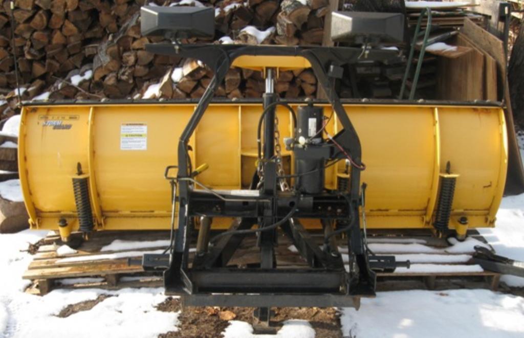

ebinmaine 80,302 #2 Posted January 20, 2020 I understand what you're intellectually engineering there. You are not wrong in that it would offer an amount of down pressure. A couple of major differences. I'm sure you are well aware that the snow plow is one solid stick. I am thinking that putting down pressure on something behind the seat tunnel would put up pressure in the tunnel itself causing that to wear. I'm not saying it wouldn't work. I'm just saying it's not something you want to do very often. Share this post Link to post Share on other sites

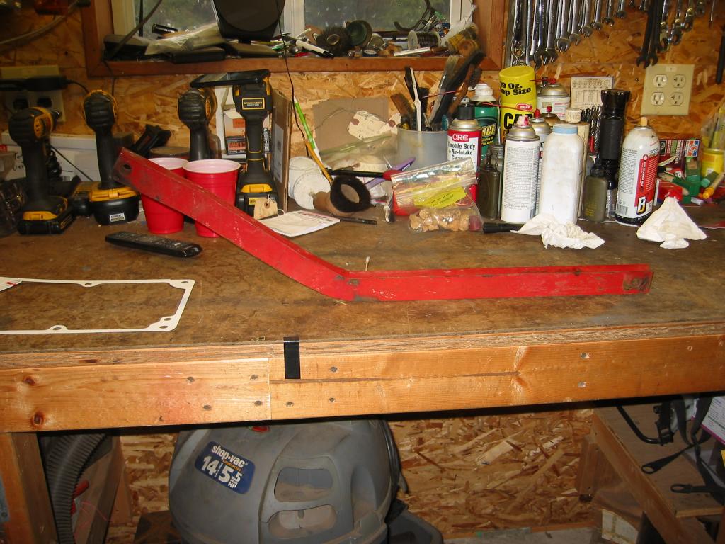

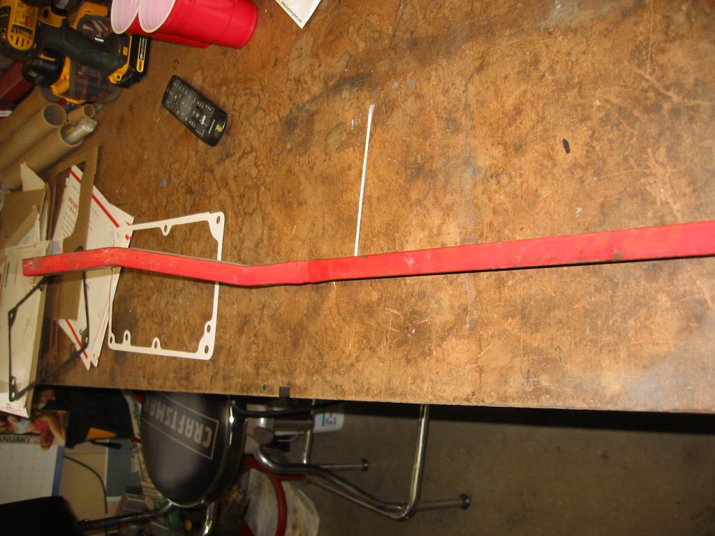

pfrederi 21,051 #12 Posted January 28, 2020 First issue The solid bar used on a GT 14 sneaks between the Sunstrand hydro pump body and the transaxle. there is no such gap if your C series has an Eaton. Making one if you had and older Sunstrand C series would be a challenge. Not exactly a straight solid link either. That is 3/4" by 1-1/2 stock. 1 Share this post Link to post Share on other sites

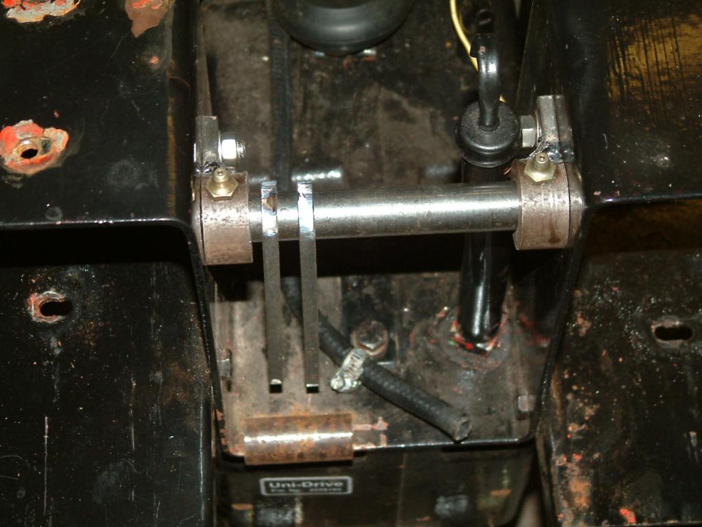

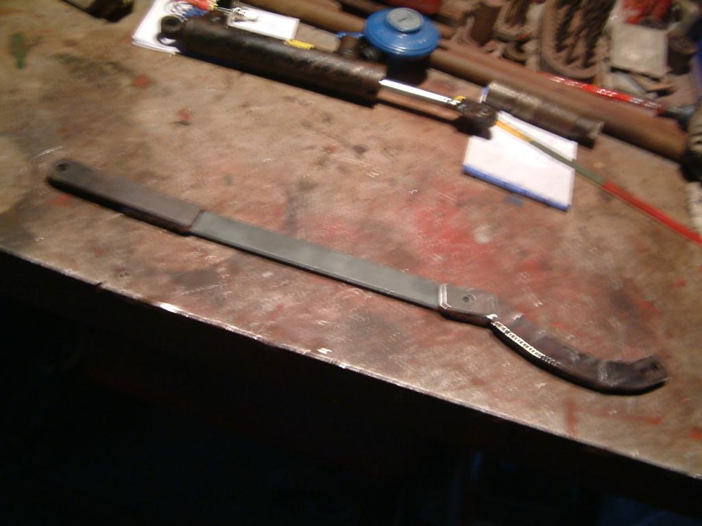

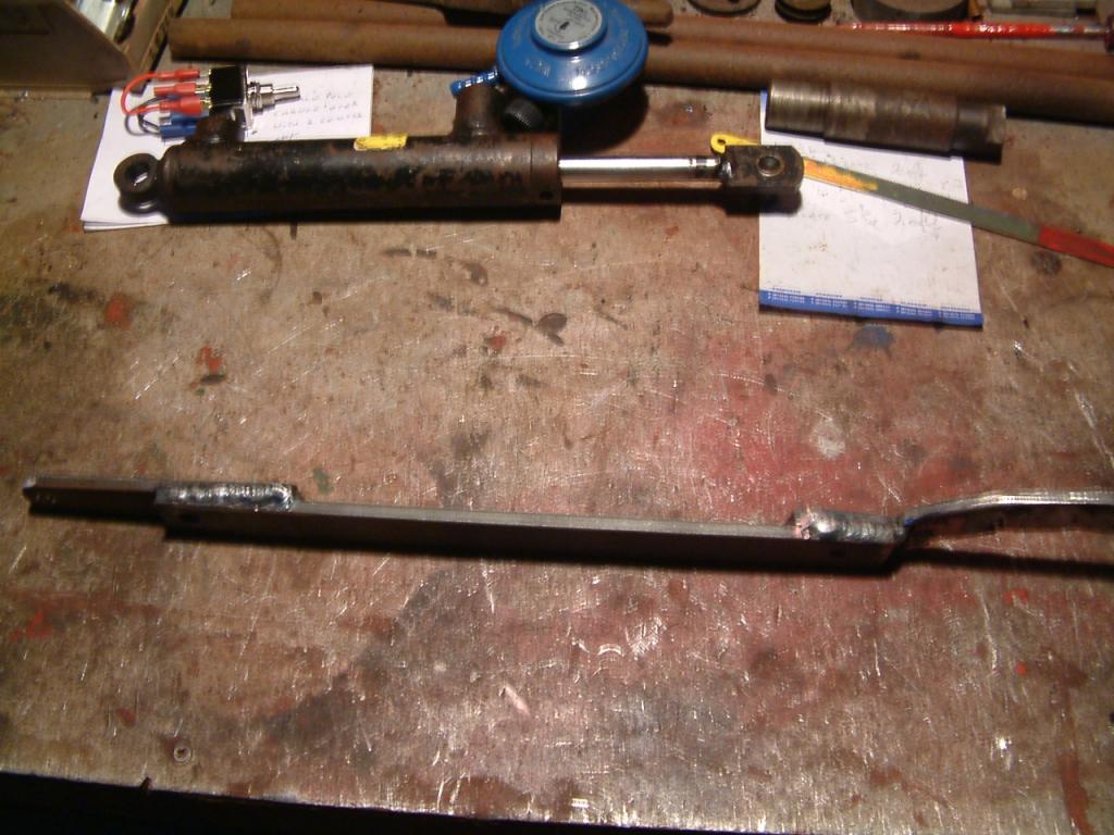

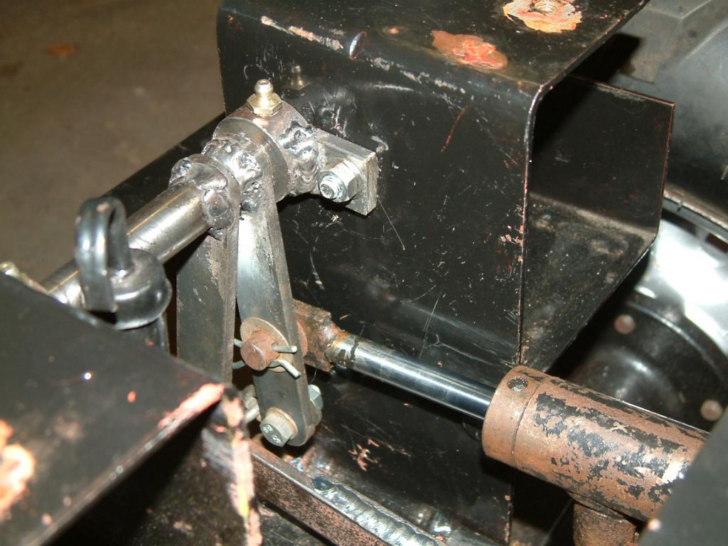

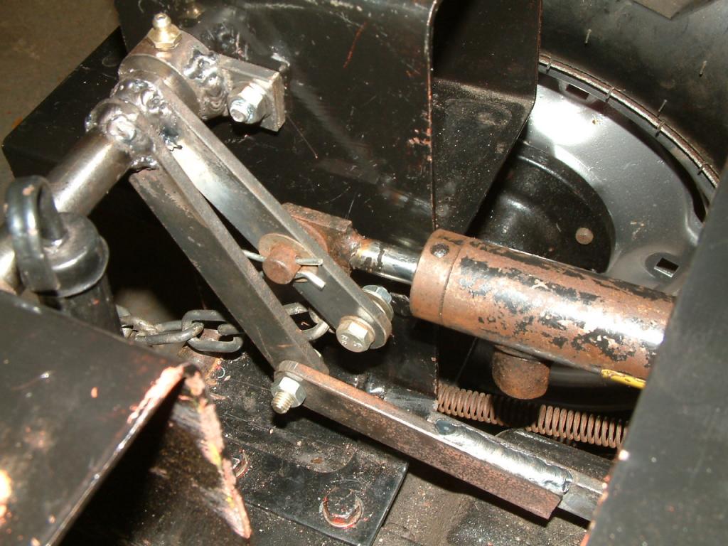

Stormin 9,988 #16 Posted February 3, 2020 I've a solid bar on my C-121 (Black Horse) Made some time ago. I'll try and see if I can find how I did it. Meadowfield did the same on one f his tractors. Share this post Link to post Share on other sites
Stormin 9,988 #17 Posted February 3, 2020 (edited) These photo's may give you some ideas. They're all I have I'm afraid. Ignore the hydraulic cylinder. That's no longer on. The off set bar just clears the gear lever. Edited February 3, 2020 by Stormin 1 1 Share this post Link to post Share on other sites
Goldnboy 1,147 #18 Posted February 3, 2020 (edited) Thanks I knew that others surely had the same idea! I posted to get ideas on the failures of metal size or bends needed to make it happen. I do say that is a nicely upgraded rockshaft there. Edited February 3, 2020 by Goldnboy 1 Share this post Link to post Share on other sites
