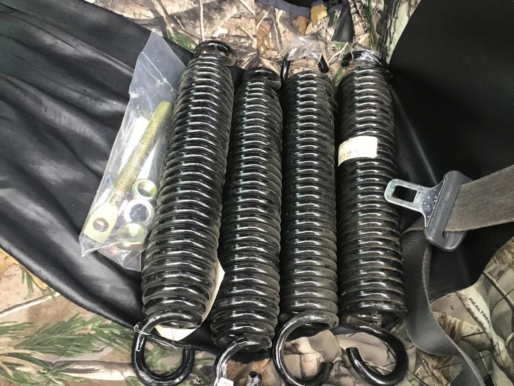

Pullstart 71,482 #8 Posted January 22, 2020 Is this overkill? They’re about 15” long. I have two used ones from my plow truck! 1 Share this post Link to post Share on other sites
