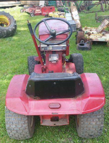

bottjernat1 2,196 #3 Posted January 20, 2020 This commando v8 came from kentucky. My late dad craig bottjer bought it from a guy he worked with at walmart distribution in garrett indiana. Then my wife bought it from my dad back in 2006 or so i believe! It has not ran since 2014 it is always stored inside except this last couple months. i finally brought it home to get it going. This means alot to my wife he grandpa had one when she was a little girl. Share this post Link to post Share on other sites

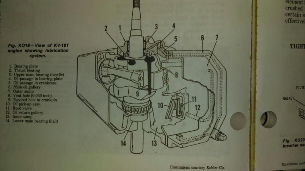

ol550 863 #9 Posted January 20, 2020 1 hour ago, Sparky said: So is that V181 the same as a K181? Just laying on its side . I wonder is K parts would interchange with V parts. And thanks for being a supporter!! Most parts will interchange. Rod works with the dipper cut off. Carburetor will not work as the mounting is different. The governor shaft has a seal as it is near the bottom. Very unique oiling system as it is dry sump system. The sump is mounted where the pan would be on a horizontal engine. 2 Share this post Link to post Share on other sites
bottjernat1 2,196 #11 Posted January 20, 2020 (edited) 2 hours ago, ol550 said: wow thanks a million for the photo!!!!! do you happen to have the parts list for this? i also need to replace the govner seal! i have lots of k181 kits but im sure that is not in there i bet. my late dad was a stens parts dealer for i have kohler gasket and seal sets Edited January 20, 2020 by bottjernat1 Share this post Link to post Share on other sites

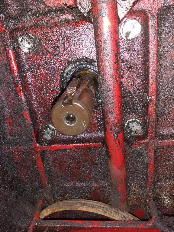

bottjernat1 2,196 #12 Posted January 20, 2020 "Anybody know what i can do for the front pin bushing? Has anybody used a different part? or does anybody have a part number so i may go get what i need. it almost seems to me like it was a solid rubber insert or something of that nature. Share this post Link to post Share on other sites
oilwell1415 563 #13 Posted January 21, 2020 Someone has probably already done the homework, but you just need some good measurements to look for in a bronze bushing catalog. 1 Share this post Link to post Share on other sites
Rfp55 33 #14 Posted January 21, 2020 I bought a Charger V8 awhile ago. First drastic need was front axle bushing replacement. The original rubber bushing STUFF was toast so I sleeved together two bigger pieces of pipe I had. Probably were 1/2" & 3/4" (maybe 3/4 & 1"). Assemble well greased, lock in by flange/ groove/ washer or something so it won't slide out. I won't be using so much it'll ever wear out. Just can't get by turning the steering wheel left and having the whole axle turn 4" right first. The bronze or brass bushing advice the best for long term. The engine has the sump on the back and is Pulse lubed by piston vacuum and pressure in the crankcase like a big crankcase breather with Reed valves. If you need to remove and replace the intake and exhaust valves for work - turn the tractor on it's right side to land the valve keepers. It's not very heavy. If you have taken the bottom pulley off you probably have engine out by now. And inspect the front cast subframe mount to channel frame area, they can crack there. They are unusual, to some extent unloved, but good little 500# tractors. There is an important KV181 service bulletin modification to drill out or check a hole under all the crankcase breather pieces. Casting flash mostly covered a hole there they have problems with. They're fun with a 36" rear disharge deck. Much tighter and easier turning compared to what I was used to, like the 16 - 20 HP horses. 1 Share this post Link to post Share on other sites
