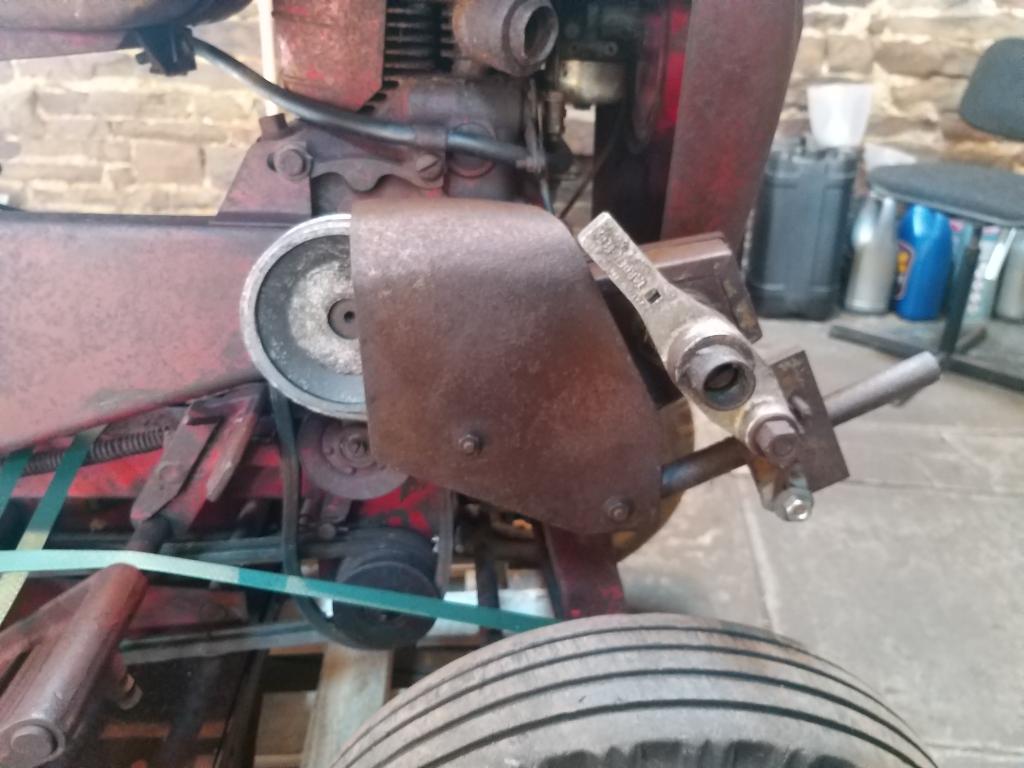

Bertie 314 #1 Posted January 20, 2020 Morning all.. Can you identify this part on my 704, I presume its hooked up to drive an implement of some sort? 1 Share this post Link to post Share on other sites
The Tuul Crib 7,354 #2 Posted January 20, 2020 I dont recognize it. Obviously a homemade attachment for an implement of some kind. Maybe someone else here might recognize it. 1 Share this post Link to post Share on other sites
Pullstart 71,369 #3 Posted January 20, 2020 I think it’s a bottle opener. Toss it in there and BANG! it’s open. 6 Share this post Link to post Share on other sites
Herder 2,356 #4 Posted January 20, 2020 6 minutes ago, pullstart said: I think it’s a bottle opener. Toss it in there and BANG! it’s open. A&W Root Beer 1 Share this post Link to post Share on other sites
SylvanLakeWH 32,703 #5 Posted January 20, 2020 Seems like some kind of clutch or brake for a front end implement...? Share this post Link to post Share on other sites
Stepney 2,356 #6 Posted January 20, 2020 It is driven by anything on the other side? Or is it a lift arm of some sort? I remember early Jacobsen tractors had a somewhat similar post off the front end for lifting the dozer blade. 1 Share this post Link to post Share on other sites

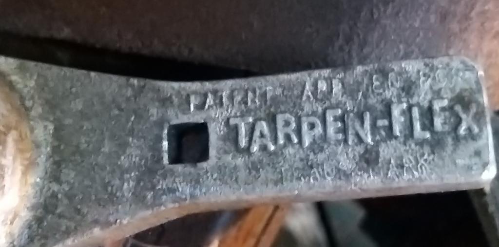

ebinmaine 80,967 #7 Posted January 20, 2020 25 minutes ago, SylvanLakeWH said: Seems like some kind of clutch or brake for a front end implement...? that was my thought as well. Looks like numbers or letters on the lever. What do they say? 1 Share this post Link to post Share on other sites
Bertie 314 #8 Posted January 20, 2020 3 hours ago, ebinmaine said: that was my thought as well. Looks like numbers or letters on the lever. What do they say? 1 Share this post Link to post Share on other sites
stevasaurus 23,857 #9 Posted January 20, 2020 I don't think it is Wheel Horse, but it looks like it just tensions the belt with that handle. Share this post Link to post Share on other sites

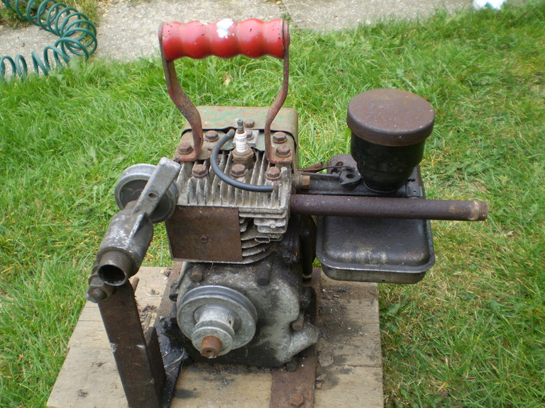

ebinmaine 80,967 #10 Posted January 20, 2020 Here's what I see on a Google search Looks like some sort of a drive mechanism with various implements available. Scroll down through and you'll see pictures. Appropriate credit given to whatever website this is... http://tractorbox.co.uk/forum/forum_posts.asp?TID=2335 1 2 Share this post Link to post Share on other sites
Bertie 314 #11 Posted January 20, 2020 12 minutes ago, ebinmaine said: Here's what I see on a Google search Looks like some sort of a drive mechanism with various implements available. Brilliant and thanks for taking the time to look..👍 4 Share this post Link to post Share on other sites
ebinmaine 80,967 #12 Posted January 20, 2020 2 minutes ago, Bertie said: Brilliant and thanks for taking the time to look..👍 I don't know about brilliant but you're welcome. That's what we're all here for. 4 1 Share this post Link to post Share on other sites
Tractorhead 9,217 #13 Posted January 20, 2020 Found another Source https://www.vhgmc.co.uk/photo-galleries/tarpen/tarpen-briggs-stratton-engine-imgtarp017/ 3 Share this post Link to post Share on other sites
