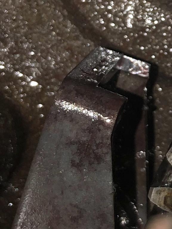

pfrederi 21,097 #26 Posted January 21, 2020 On 1/20/2020 at 10:38 AM, The Tool Crib said: Can that parking brake pawl be repaired or get one somewhere ? Ive heard this is a common thing? If you have the bail style (#31) If you have a welder just build it back up and file grind back to shape i have done a few and I not good at welding.... There is another style, finger with teeth that is not as easy for and amateur welder to fix. Share this post Link to post Share on other sites
The Tuul Crib 7,354 #27 Posted January 21, 2020 I was thinking that It could be repaired not sure if it was you or someone had a thread about it. When I get it tore down to that point I should find out what I need to do. I have lots of welding experience and we have a wire welder here at work that I can use. Are these parts hardened? Share this post Link to post Share on other sites
pfrederi 21,097 #28 Posted January 21, 2020 3 hours ago, The Tool Crib said: I was thinking that It could be repaired not sure if it was you or someone had a thread about it. When I get it tore down to that point I should find out what I need to do. I have lots of welding experience and we have a wire welder here at work that I can use. Are these parts hardened? The bail type are not. Share this post Link to post Share on other sites

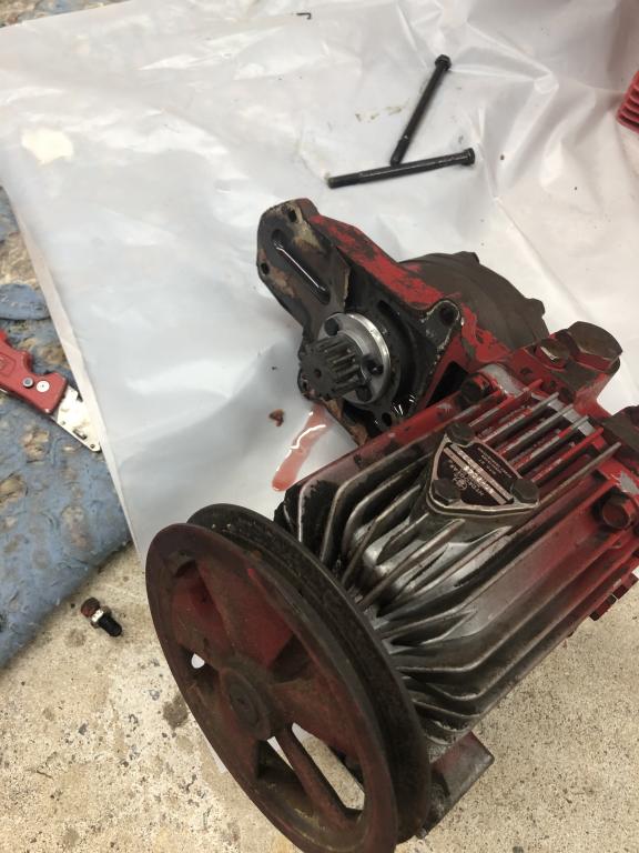

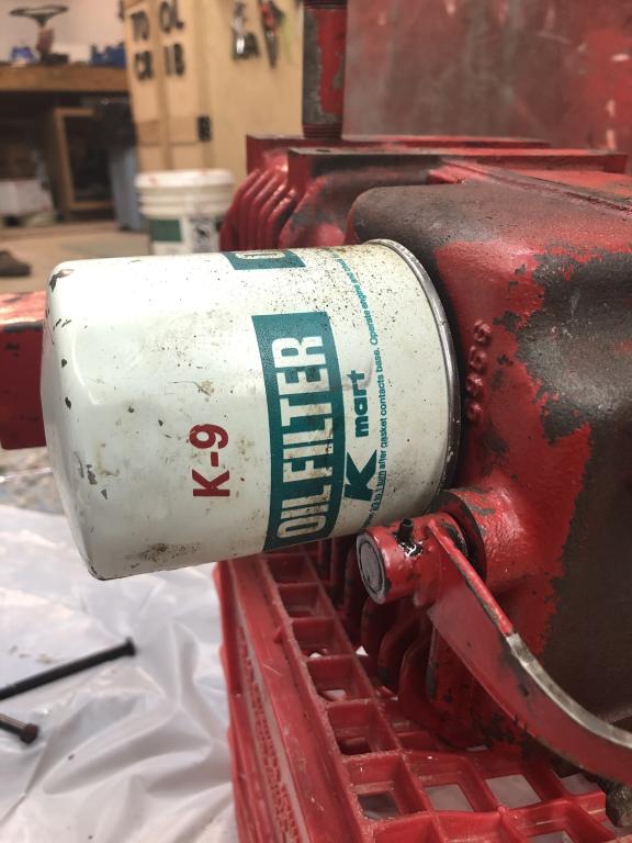

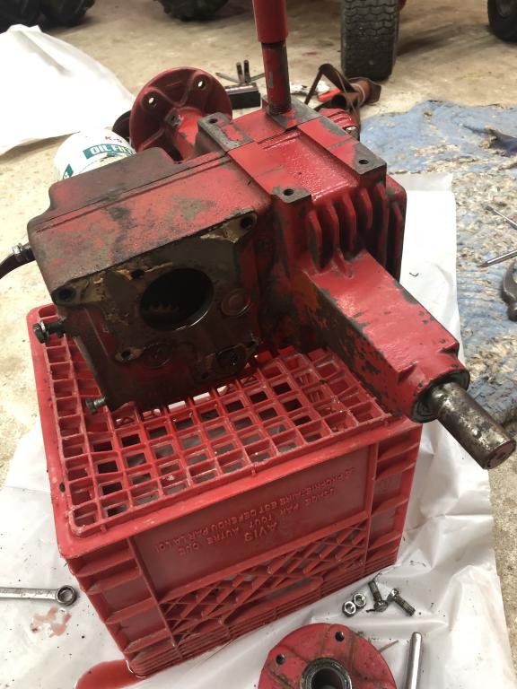

The Tuul Crib 7,354 #29 Posted January 21, 2020 So when l got home l got to tearing apart the old sunstrand and ill have to say l think it is in good shape. The paint on the outside is still good and the fluid was pink and smelled normal. It has an old Kfart oil K9 filter on it.Looks like the the brake pawl will need to be repaired . I will take that to work and fix. l have a question tho. If this pawl was ate up like it is would the metal shavings from it have been filtered out and would they would have gone thru the pump? Share this post Link to post Share on other sites

953 nut 68,846 #35 Posted January 24, 2020 On 1/21/2020 at 6:35 PM, The Tool Crib said: brake pawl will need to be repaired . I will take that to work and fix. If you have access to a piece of copper (old electrical panel bus ber works) you can clamp it under the pawl and then weld it back into shape. Weld won't stick to the copper. That K9 filter was an automotive filter, you need a hydraulic filter like a NAPA 1410. 1 Share this post Link to post Share on other sites
