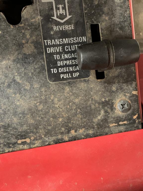

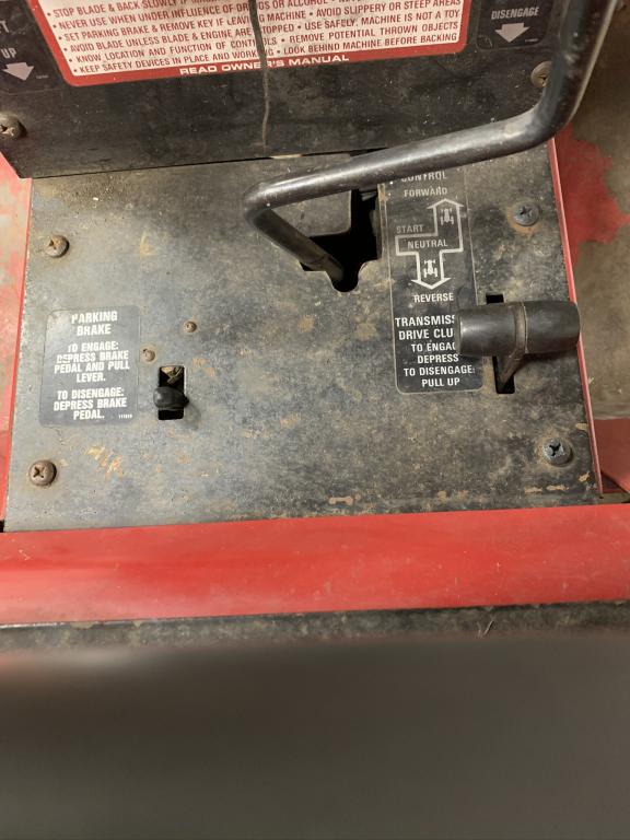

Andy N. 2,881 #3 Posted January 19, 2020 (edited) The 518-H was produced in 1988 & 1989 only. Manual says hand push only. Probably can be towed at slow speeds the same way or winched up onto a trailer. You will need to disengage to the trans either way. Pics are from my '89 520-H which should be the similar if not the same. Edited January 19, 2020 by Andy N. 2 Share this post Link to post Share on other sites

grinchsr 675 #5 Posted January 19, 2020 I had to drag the tractor on to the trailer with the wheel locked up using a winch. I did take the tension off of the belt Share this post Link to post Share on other sites

Stepney 2,356 #11 Posted January 20, 2020 Was always told pulling a hydro with locked wheels was a huge no-no.. especially something fragile like a 7. I had a heck of a time rescuing a 516 from the woods. But when it came to moving it, I slipped the belt right off the hydro pump. It would freewheel then if you were gentle. It could never be moved with even the friction of a loose belt on it. 1 1 Share this post Link to post Share on other sites
grinchsr 675 #12 Posted January 20, 2020 Thanks for the info. I did pull up on the belt tensioner but I guess it still had some contact with the belt. Hopefully I didn’t do any damage. Will know more when I get it running Share this post Link to post Share on other sites
