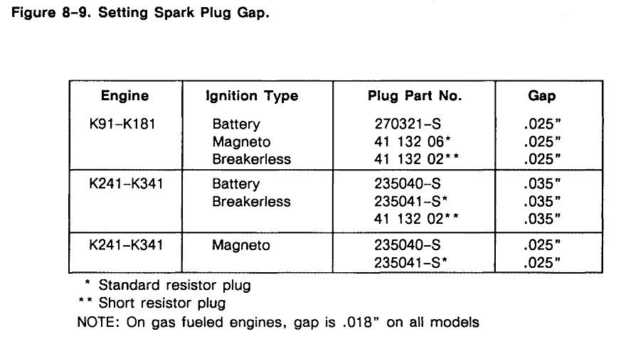

donnie crawford 1 #1 Posted January 19, 2020 (edited) I have a question if you go to k301 engine manual it says 0.025 on plug gap but you go 1982 c-125 owners manual it says 0.030 on plug gap. So? I have little skip or vibration at idle just trying the little things first. Edited January 19, 2020 by donnie crawford Share this post Link to post Share on other sites

gwest_ca-(File Mod) 12,532 #5 Posted January 19, 2020 It is possible the recommendations changed over the years. This is from a service manual dated April 1990 and revised November 1992. Gas fueled engines in the chart are propane and natural gas. Garry Share this post Link to post Share on other sites
