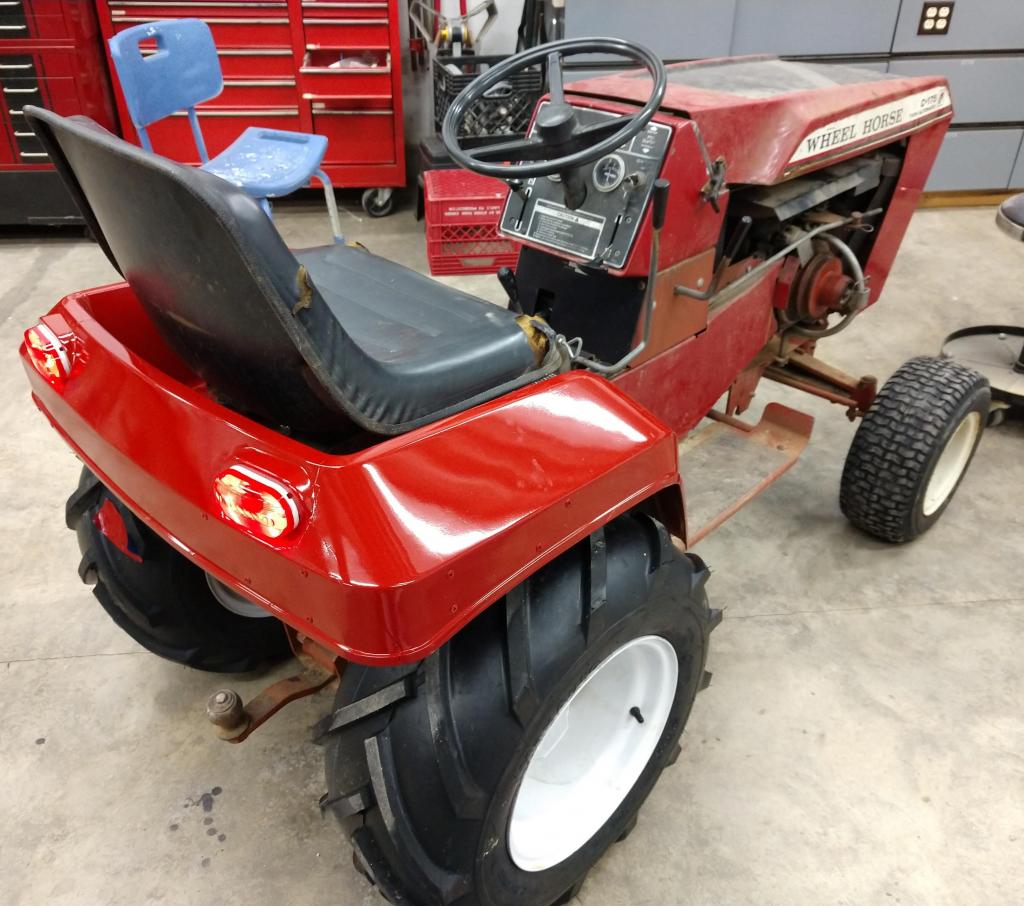

wheelwhores 107 #4 Posted January 15, 2020 Here she is, not a great photo but it's all i have right now. Agreed on power vs traction, never felt wanting for power with it yet, but it feels like it breaks lose front and back a good bit. I might run to TSC, Fleet Farm or the like to get some chains as a first step. Then going to look for a method to add a suitcase weight setup on the back and maybe in the front too 1 Share this post Link to post Share on other sites

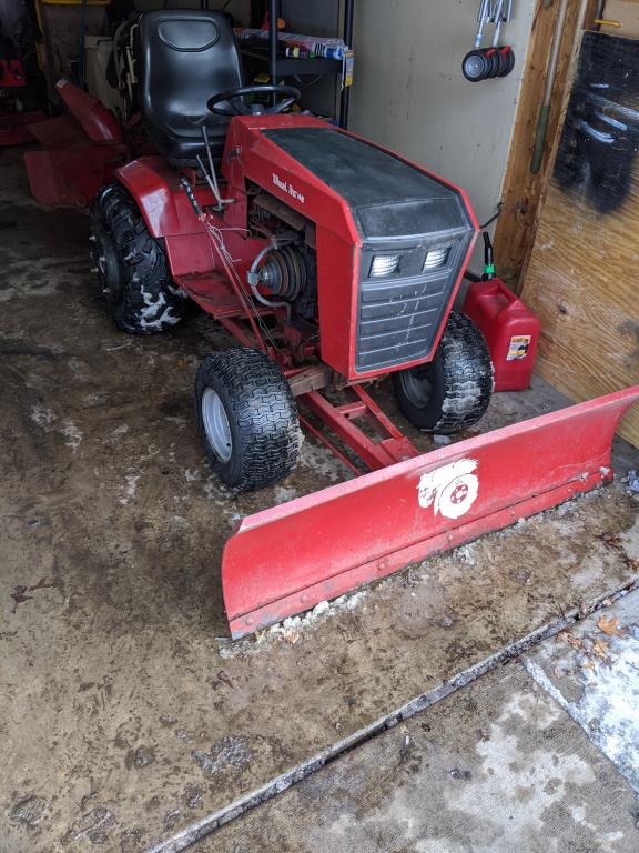

Gas Man 19 #8 Posted January 15, 2020 I've got Ag tires on my C175 and they work very well. I'll bet that chains would work at least as well, maybe better, but the Ag tires look cool!! I just got this tractor running 2 days before we got 10 Inches of wet snow!! It went pretty well, but we don't get that much snow at a time very often. Share this post Link to post Share on other sites
wheelwhores 107 #9 Posted January 16, 2020 Love the black hoods! 1 Share this post Link to post Share on other sites
