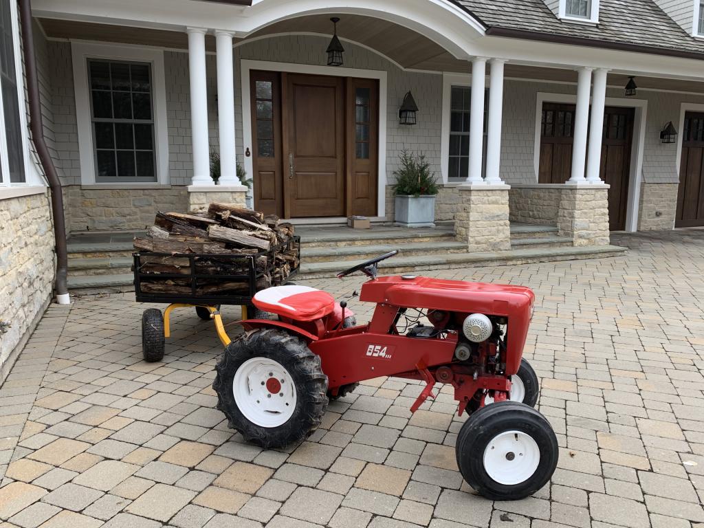

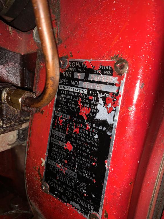

Dr.D 9 #1 Posted January 14, 2020 Hello All Last year I bought (what I thought) was a 854 with original snow thrower from guy in South Bend. It had-has a 854 sticker on the side.The PO bought it from his next door neighbor in 1976 who bought it new. I got it home, pulled it apart (except the engine) and stripped, repainted, restored. Looks nice and runs but I smell like gas after every use. The engine is 56 years old so I start gathering parts for a rebuild until... yesterday I found a NOS K181 replacement engine on ebay (easy button-never been started). The engine was pricey but now on its way... Now this is where the 754 part comes into the story. I scratch the paint off the engine tag and it clearly says its a K161 #700688 Spec # 28626E. Not sure why it would have a seven horse engine... Thought it might be a replacement engine shroud... Either case I went ahead and ordered the NOS K181. Then I read a thread on Red Square about the mythical 754... hmmm.... What do you think guys? Could mine be one? How would I know? If it is do I need to back the truck up on an engine swap? Share this post Link to post Share on other sites

953 nut 69,147 #6 Posted January 15, 2020 1 hour ago, Dr.D said: bought (what I thought) was a 854 with original snow thrower from guy in South Bend. It had-has a 854 sticker on the side.The PO bought it from his next door neighbor in 1976 who bought it new. Few of us have that kind of history on our . The Pond family left us a lot of little mysteries to make things interesting, Hang on to the K-161, you could always rebuild it later on to make it a 754. 1 hour ago, Dr.D said: Spec # 28626E That spec number is correct for a 1962 model 702 wth electric start or a 1963 model 753 so the plot thickens. . Share this post Link to post Share on other sites

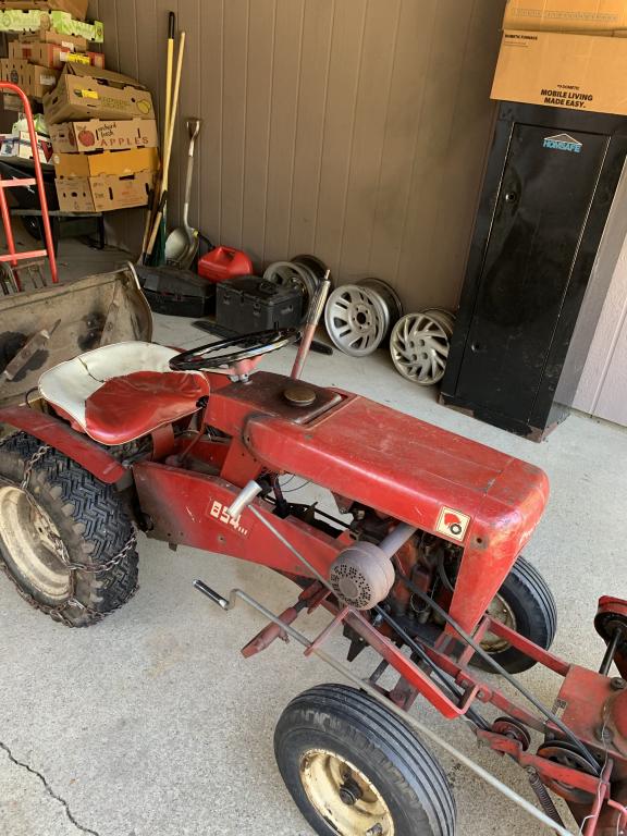

Dr.D 9 #7 Posted January 15, 2020 Well... I said I stripped it down for paint... that included all the old stickers with the serial number. I think the PO listed it in his advertisement. I was the first person to say yes so he held it till I picked it up a few days later. The PO said that the phone been ringing off the hook about it and one guy offered 1100 for it sight unseen. I bought it for 650 because it had the snow blower... did not think anything of it but now will check to see if I can find the serial number. The first photo is with fresh paint, second is the engine and the last is from the day I picked it up. 2 2 Share this post Link to post Share on other sites
hcminis 1,796 #9 Posted January 15, 2020 IF it is a 754 the the serial number will definitely tell you. There were only 422 of the 754 models made. The serial number range for those is 47916 - 48337. If your serial number does not fall in between those then it isn't a 754. As mentioned the spec number is correct for 1963 1 Share this post Link to post Share on other sites
