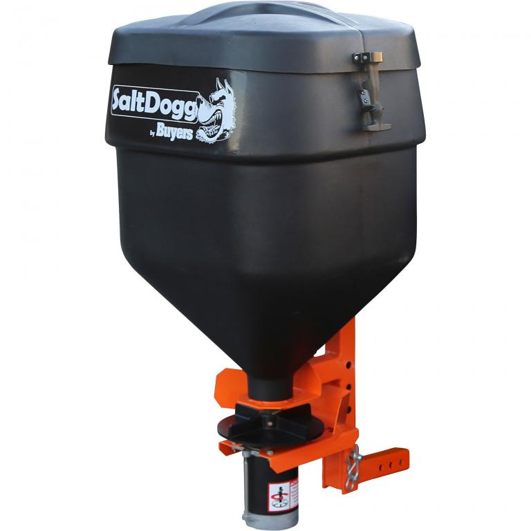

Alex175 785 #1 Posted January 13, 2020 I have a spare salt spreader that we don't use at our offices anymore and I am debating bringing it home and trying to hook it up to my C-195. The spreader in question is a Salt Dogg with a 1/2 horsepower electric motor. It fits into a 2 inch receiver and I have a receiver on my 3 point hitch on the C-195 so physically it will mount with ease, but the question I am asking myself is will the charging system put out enough power to run the spreader. My driveway isn't crazy long, maybe 200 feet so I figure that the battery should have enough power to run it while I salt once in either direction and then I could park the tractor back in the garage and charge it up, but if the charging system was powerful enough to run it that would be even better. Does anyone have any experience doing something like this, or know more about electrical than me when it comes to running extra accessories on these machines? 1 1 Share this post Link to post Share on other sites

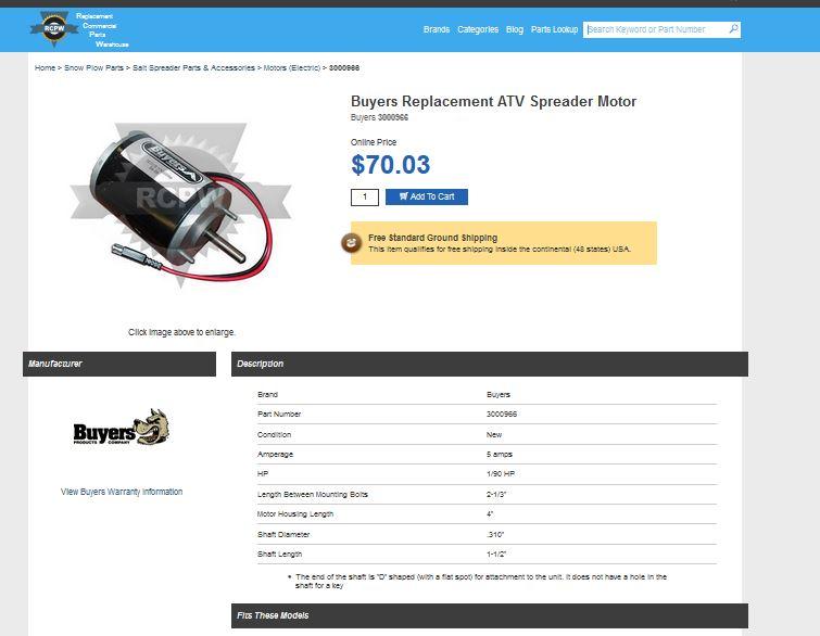

pfrederi 21,183 #5 Posted January 13, 2020 12 minutes ago, N875ED said: A typical 1/2 horsepower motor draws around 8 amps at 120 volts, or 80 amps at 12 volts. (Ever see the cables going to a Jeep winch?...they use 00 battery cable to feed it.). This amount of current will draw down the garden-tractor battery pretty fast, even subtracting the 12 - 15 amps provided by the engine's alternator. (Automobile or truck alternators generate about 80 amps or more) Did you check the dataplate on the spreader's motor? It should give you a current rating at 12 volts. Found rating for a buyers spreader motor 300096 Which uses 5 amps they have a lot of salt spreaders but even the bigger ones do not use a 1/2 hp motor. Share this post Link to post Share on other sites

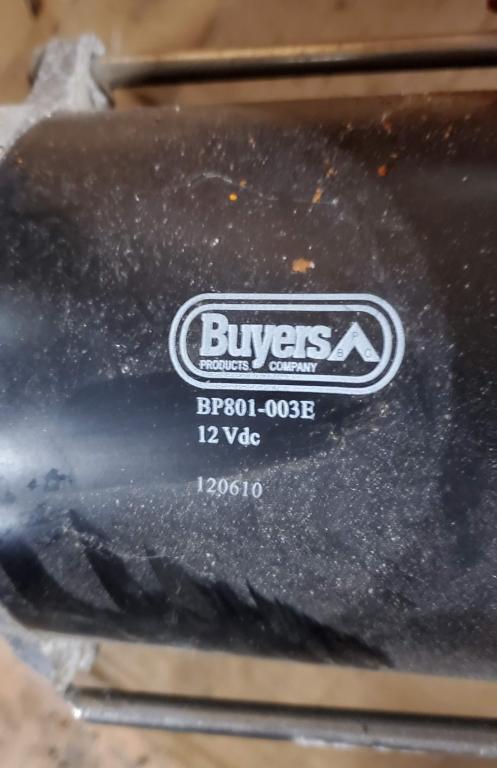

Alex175 785 #6 Posted January 13, 2020 (edited) 1 hour ago, N875ED said: Did you check the dataplate on the spreader's motor? It should give you a current rating at 12 volts. Sadly there isn't much info on the motor itself besides 12v and the part number which I haven't been able to tie back to an amperage rating yet. But regarding cable sizes the newest version of this salter can be powered off of a cigarette lighter, so it doesn't have the same kind of draw as a winch. I may have also been hasty in stating 1/2 hp, that seems to be the bigger version of this salter, the more economy version that I believe I have looks like it may be 1/8 hp. Edited January 13, 2020 by Alex175 Share this post Link to post Share on other sites

pfrederi 21,183 #8 Posted January 13, 2020 BP 801-003E crosses to motor number 3014441 Can't find an amp rating but the wires are very skinny.... Share this post Link to post Share on other sites

Tractorhead 9,217 #12 Posted January 14, 2020 (edited) I found a site with spare part motor. https://www.radwell.de/en-GB/Buy/BUYERS PRODUCTS/BUYERS PRODUCTS/BP801-003E/?redirect=true But there is also no closer info about. If i see this cables, but on the Picture they look no too thick, but this can be an illusion. The correct Way will be a Current measurement in use, To know how strong the fuse must be, was Measuring via an Amp- meter clamp while running. Another reference will be the Motor Cable itself. What AWG is the cable? This should give you a basic info, what max current can be happen. Because each AWG has its maximum ratings, no honest company will run a thing above this ratings. if you ain‘t sure, ask an electrician, what AWG this cables directly on the motor are. Than you get an idea, about the Current, it can reach. Searching for more info‘s.. Ha, found something interesting.... 😎 https://images-na.ssl-images-amazon.com/images/I/A1wfsXuqciL.pdf Aunt edit..😎 in this link at the seller (or manufacturer) they told something about an 40 Amp fuse in the motor internal. https://pimimages.buyersproducts.com/Products/Documents/3019468_C.pdf the followed Version has a 50A Circuit breaker. https://pimimages.buyersproducts.com/Products/Documents/3011864_2018.pdf That will be inserted for the worst case, so i guess it should drawn something between 15-30A in working condition. Current draw May increasing shortly up to 40A depending on weight of salt onto the spreaderplate, to start moving. If it moves, i would calculate something between 12-20A for working condition. ( no Warranty, without measurements). just a feeling about similar thing’s i installed allready. Edited January 14, 2020 by Tractorhead Share this post Link to post Share on other sites
