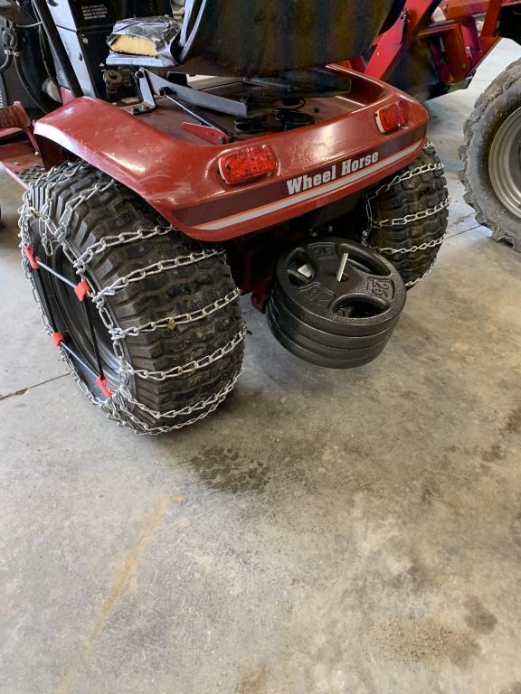

Stewrun 6 #35 Posted January 25, 2020 Here’s my finished attempt. Next snow we’ll see if I get stuck! I just put 1/2 inch allthread through the existing hitch hole and then stacked 4 25 lb weights on it. 3 Share this post Link to post Share on other sites
