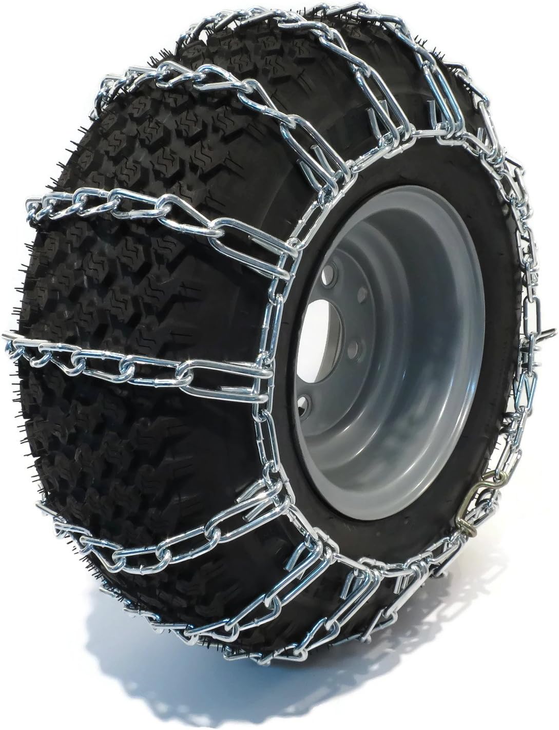

Stewrun 6 #22 Posted January 10, 2020 4 hours ago, peter lena said: stewrun , as you can see the responses are all different while dealing with their own issues , recently picked up a very good 2 link chain set from the rop shop , https://www.amazon.com/Snow-Chains-ROP-Shop-Accessories-Parts/s?rh=n%3A15706671%2Cp_89%3AThe+ROP+Shop, nice snug fit and a much heavier chain than the typical junk out there . i also used a silicone spray to help chain binding while fitting on tires, and used extension springs to hold tension fit while i adjusted the chains over the tire rubber. good luck with it , pete Here's the ones I got - arriving today: https://www.amazon.com/gp/product/B00EIL4UZI/ref=ppx_yo_dt_b_asin_title_o03_s00?ie=UTF8&psc=1 Share this post Link to post Share on other sites

Ed Kennell 47,824 #24 Posted January 10, 2020 (edited) Good looking chains, but IMO, they are installed up side down. Edited January 10, 2020 by Ed Kennell 5 1 Share this post Link to post Share on other sites
