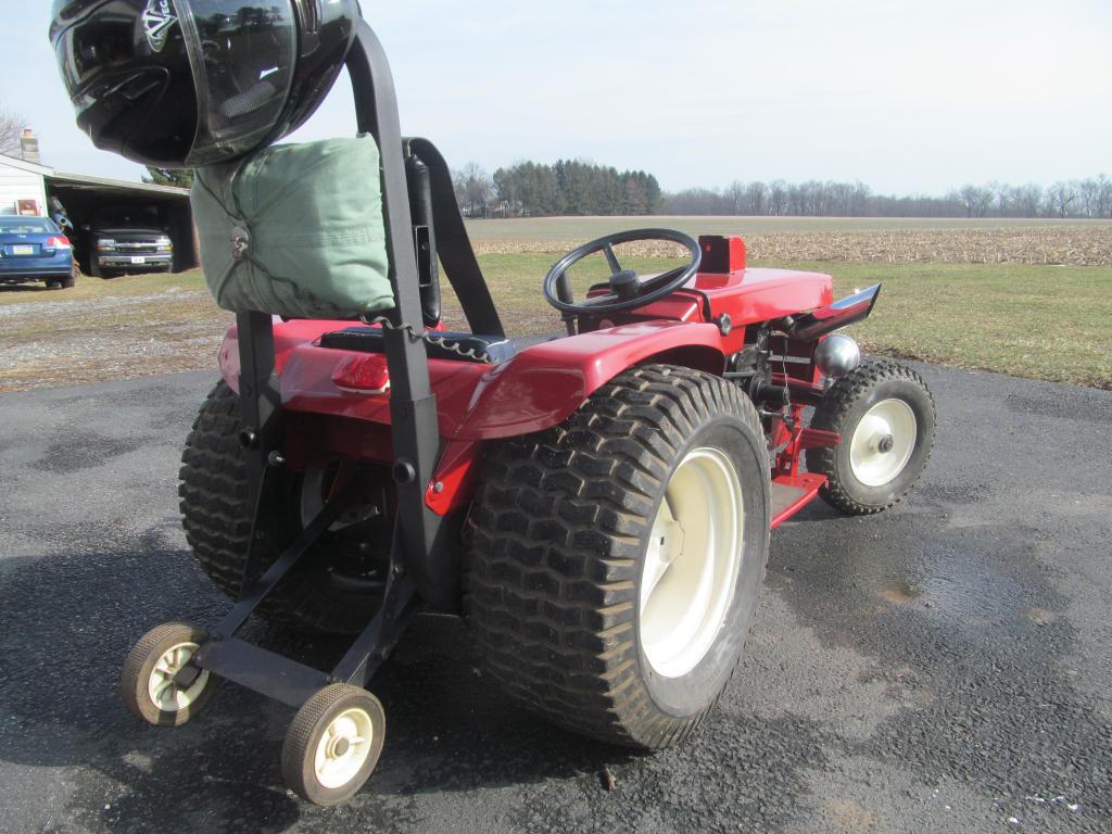

Ed Kennell 47,734 #10 Posted January 9, 2020 90W works fine in my 8 speed. I never clocked it, but the chute is set to deploy at 190MPH. 1 1 5 1 Share this post Link to post Share on other sites
ebinmaine 81,035 #11 Posted January 9, 2020 4 hours ago, Ed Kennell said: 90W works fine in my 8 speed. I never clocked it, but the chute is set to deploy at 190MPH. How many times has the chute puffed out?? 1 Share this post Link to post Share on other sites
Ed Kennell 47,734 #12 Posted January 9, 2020 3 hours ago, ebinmaine said: How many times has the chute puffed out?? None Eric. I am looking for a volunteer driver..... 2 Share this post Link to post Share on other sites
ebinmaine 81,035 #13 Posted January 9, 2020 1 hour ago, Ed Kennell said: None Eric. I am looking for a volunteer driver..... I'll tell Trina. She's about half cracked enough to try something like that. Maybe. 1 1 Share this post Link to post Share on other sites
cafoose 3,883 #14 Posted January 9, 2020 1 hour ago, Ed Kennell said: None Eric. I am looking for a volunteer driver..... 1 2 Share this post Link to post Share on other sites
Tractorhead 9,218 #15 Posted January 9, 2020 4 hours ago, Ed Kennell said: None Eric. I am looking for a volunteer driver..... Is there enough space for, like a Autobahn ? 😎.. Share this post Link to post Share on other sites
Ed Kennell 47,734 #16 Posted January 9, 2020 You mean like this? Share this post Link to post Share on other sites
