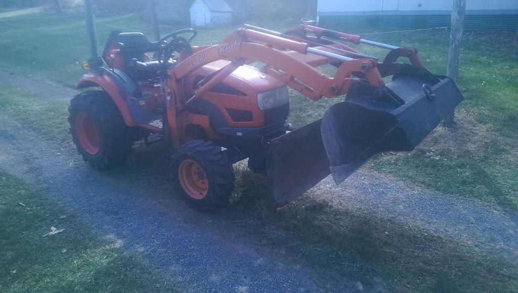

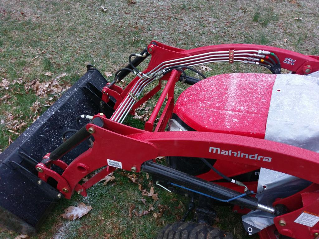

WVHillbilly520H 10,379 #7 Posted January 9, 2020 Both of my SCUT/CUT (Kioti/Mahindra) are pin on buckets... But the whole loader frame is quick detachable. Share this post Link to post Share on other sites

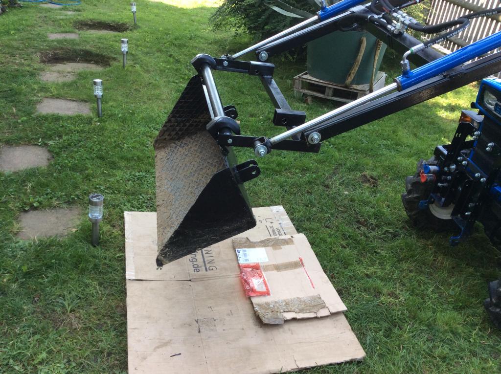

Tractorhead 9,217 #10 Posted January 9, 2020 Built a bucket quickchanger myself. not a hard thing, just flip 2 lockbolts and rest can simply done by Hydraulic. i ain‘t like a handle, because the 2 lockbolts are easy to handle and reduces the Weight. it‘s quite stable, so lift the Whole tractor with the Bucket can be done easy without any Troubles. 2 Share this post Link to post Share on other sites
DET 113 #11 Posted January 9, 2020 Mr. Donuts, I like what he has done on the video. Do you know if there is any stills/plans? Tractorhead, Do you have any more pics. of your quickchanger? I would like to see it fully hooked up as well. It does look like a fairly simple build, which is right up my alley. I really love the ideas you can get from this site Share this post Link to post Share on other sites

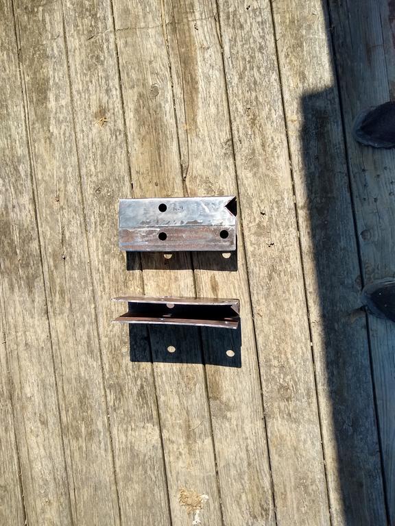

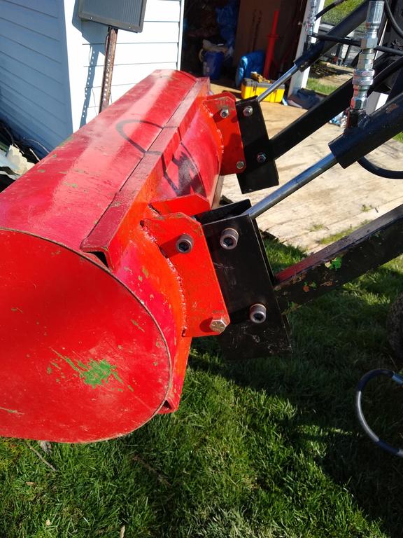

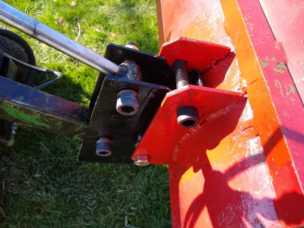

DET 113 #15 Posted April 6, 2020 I decided to mimic the Kubota quick attach that Wallfish sugested. I bought two pieces of 6" x 9" x 2" rectangular tube. I had the metal shop I bought them from cut off one of the long ends where the corners are. i then had them put in a notch the same as 1-1/4" angle iron. After that I only had to drill three holes on each piece and move the brackets on my bucket wider to fit the tube. This has made hooking up the bucket a lot simpler. Now I just have to come up with something for my plow and tiller. Thanks everyone for your ideas and input. Share this post Link to post Share on other sites
